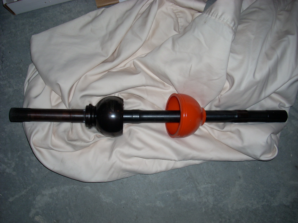

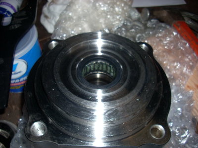

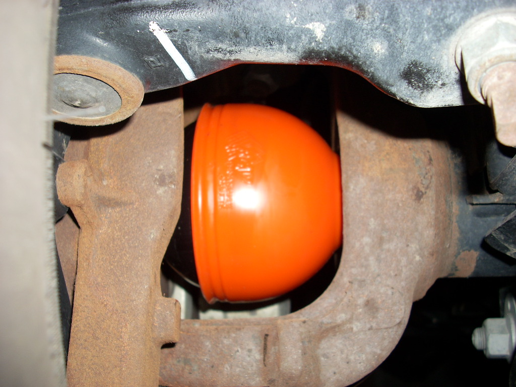

My first modification is the Spyntec & Mile Marker hub conversion. I also changed the axle shafts to RCV ultimate shafts.

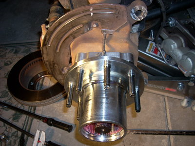

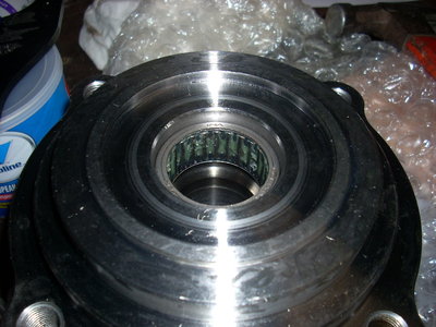

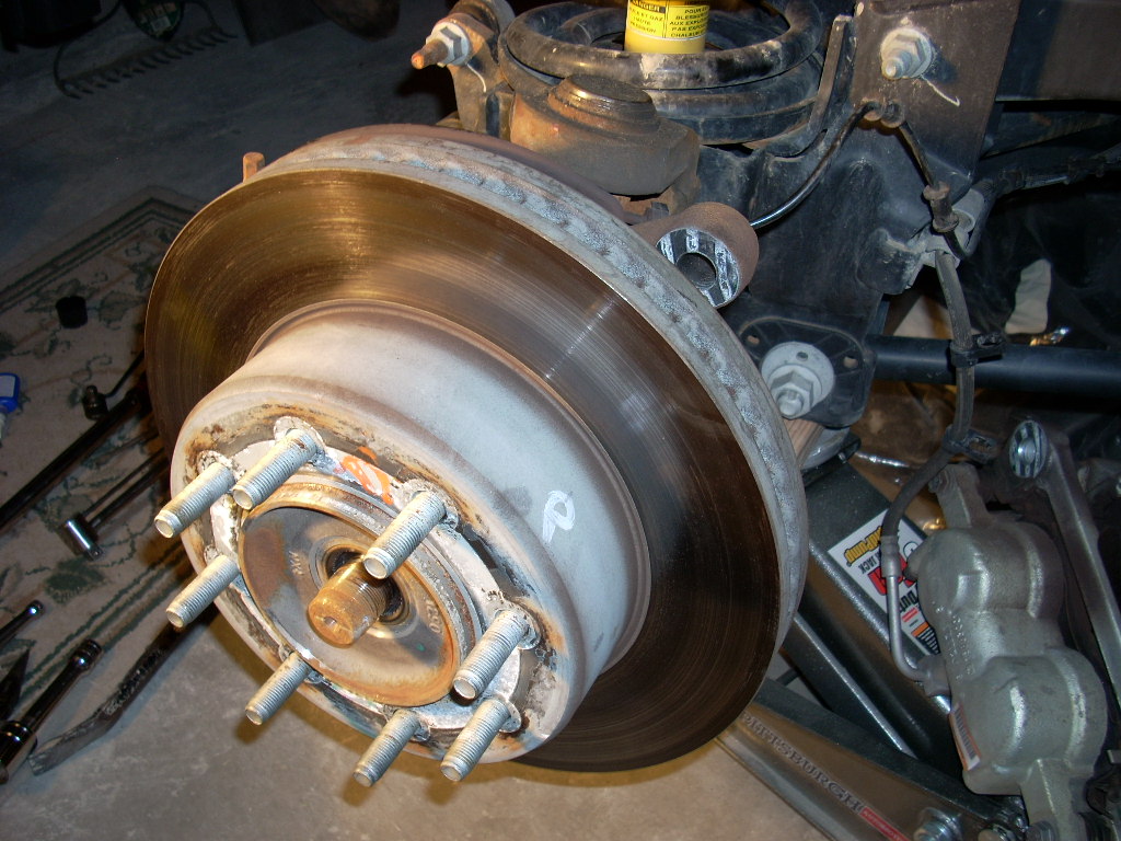

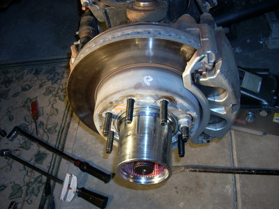

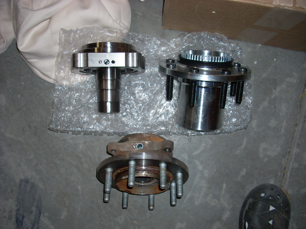

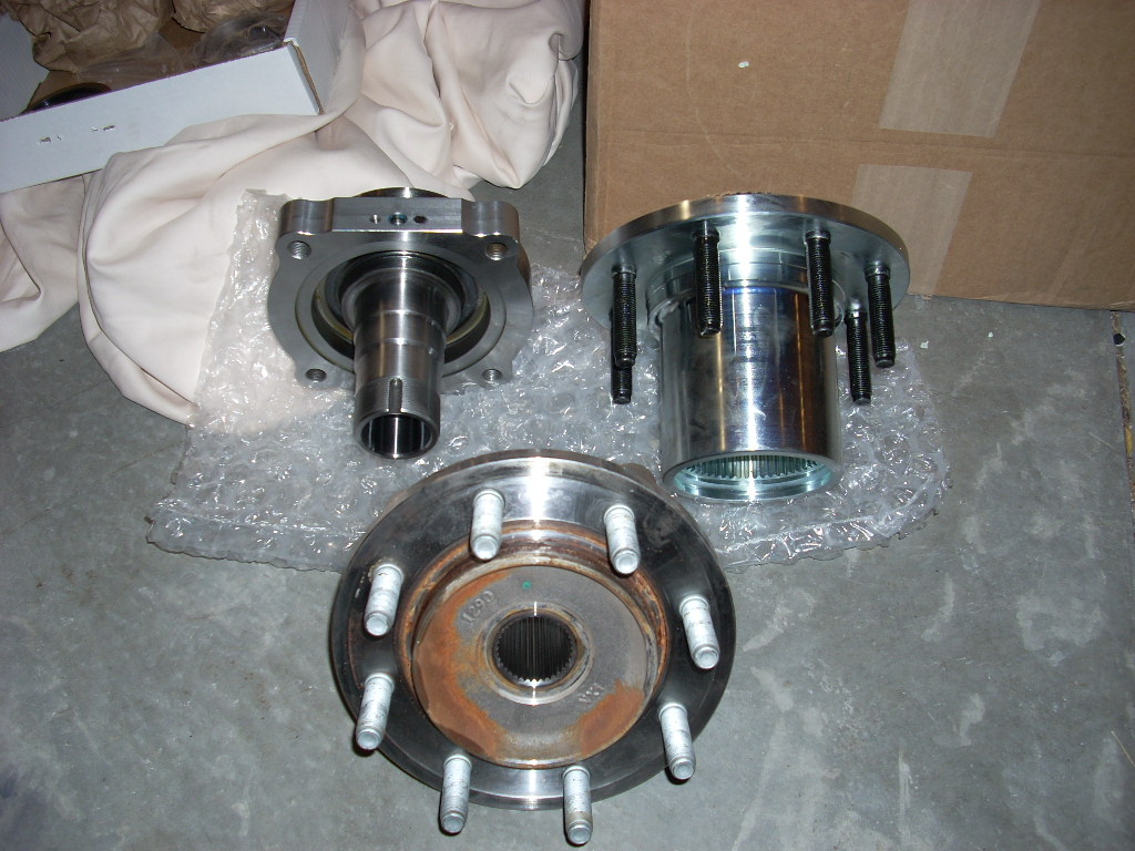

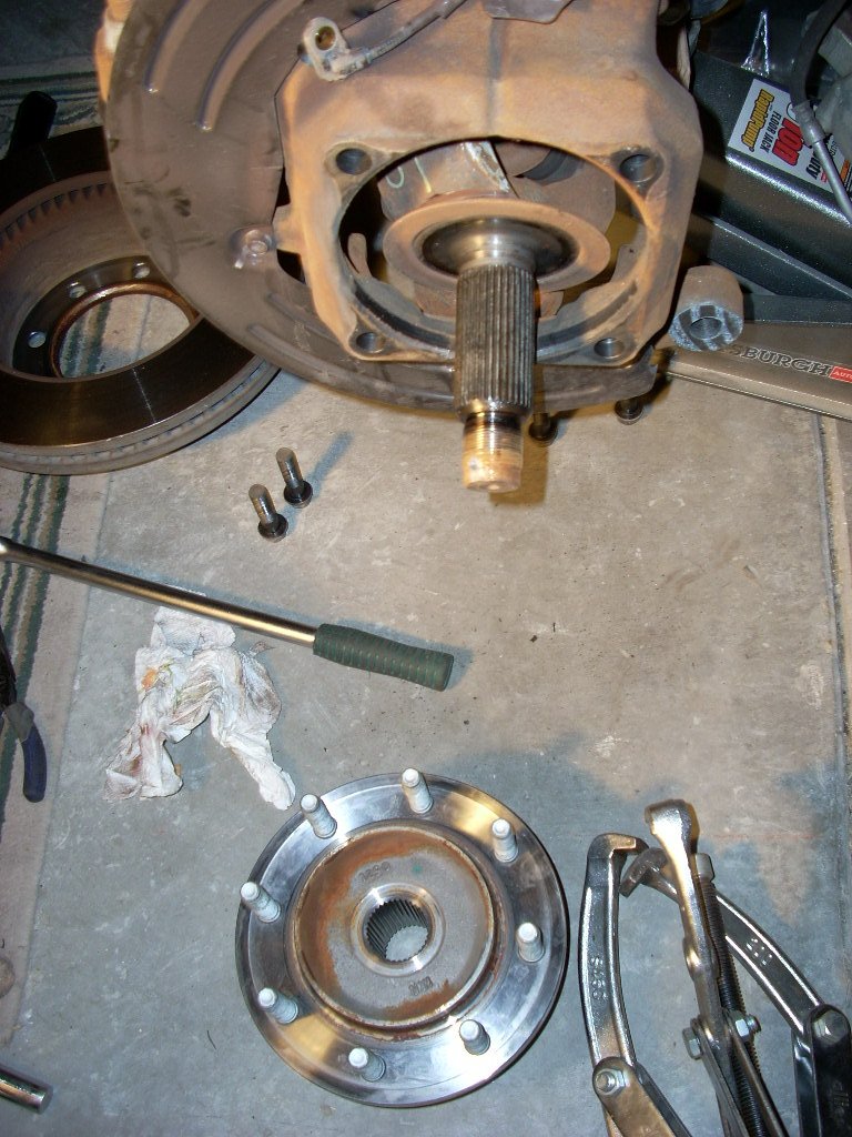

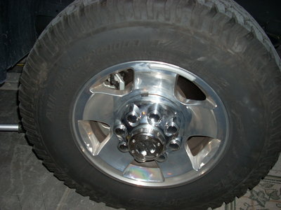

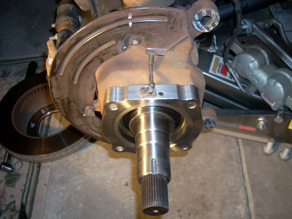

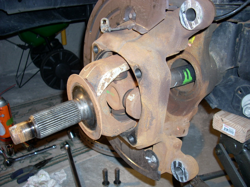

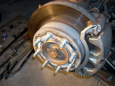

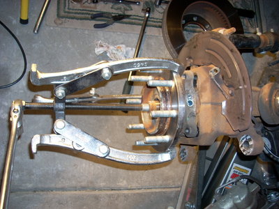

Wheel & tire removed. Axle cotter pin has been pulled out. The caliper and axle nut removed from the unit bearing. The ABS sensor removed. The four unit bearing to knuckle bolts have been removed. Persuading the unit bearing from the axle shaft with a puller. This didn’t require much pull. Pulling the original axle shaft from the tube. Assembling the RCV shafts, CV joint & boot. The boot required a significant push (strike) to get it to pass over the joint. Mud slinger, outer seal & thrust washer installed on RCV shaft. A look inside the new spindle shows an installed pre-greased inner axle shaft bearing. There is no access to this bearing after the spindle is fastened to the knuckle.

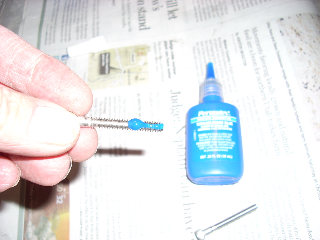

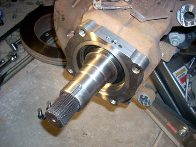

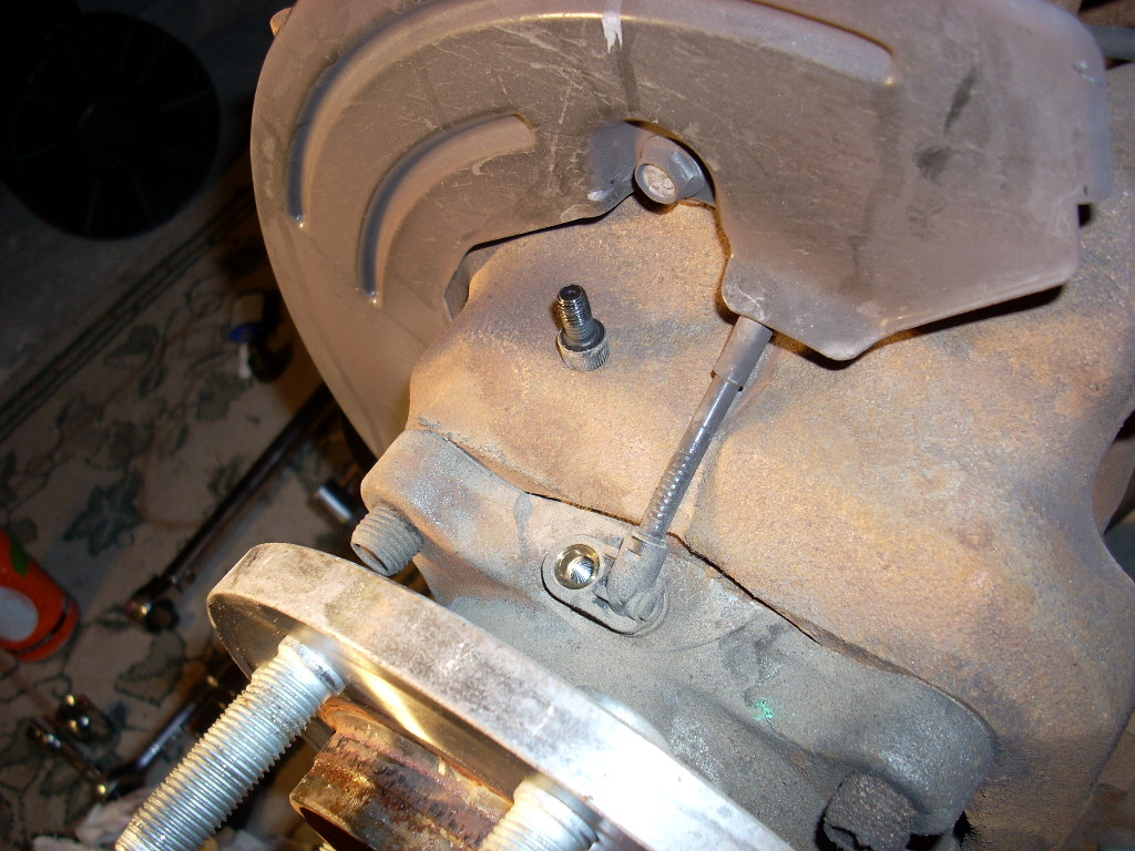

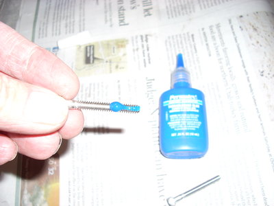

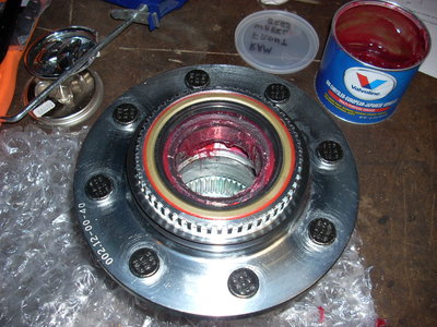

Grease seal installed at the inner bearing. There are two drilled & tapped holes in the new spindle for the ABS sensor. My sensor only required one hole. I flush plugged the other hole with RTV silicone sealant. A quick comparison of the new spindle and hub next to the original unit bearing assembly. Note the ABS tone ring on the new hub. A comparison of the original and RCV axle shafts (drivers side). The RCV axle shaft has been inserted in the axle tube and the new spindle is in place. The spindle is now bolted to the knuckle and the ABS sensor is installed. The inner bearing is packed and installed into the hub. The bearing grease seal is also pressed into place. There is also an outer seal installed near the tone ring. The hub is slid over the spindle. The outer bearing is packed and installed. The spindle nuts & locking washer are installed & adjusted per instruction. The disk & caliper are also installed. The inner locking hub is installed. Two different outer snap rings are included and it’s up to the installer which one to use. No inner snap ring (for axle shaft) was included, and the instructions indicate that it’s not necessary. There seems to be plenty of seal compression between the outer axle stub and spindle though. The instructions recommend the use of Loctite on the outer hub bolts. The amount shown in the photo was spread between two bolts.

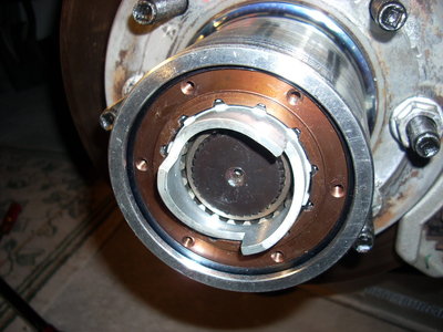

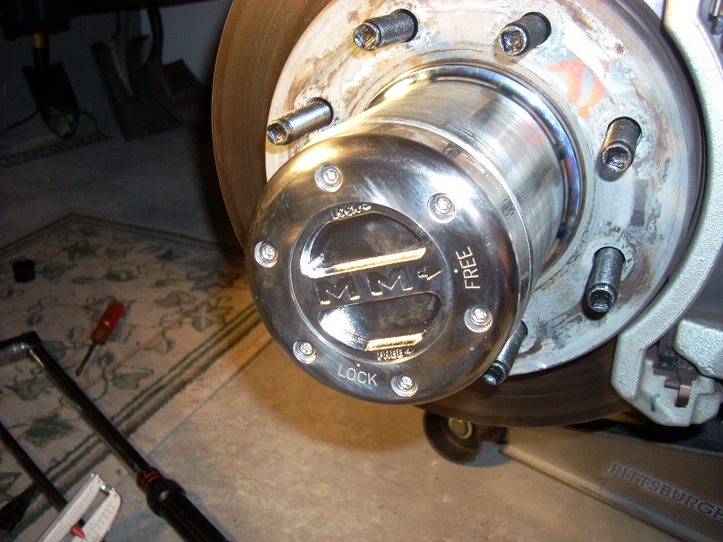

Locking hub installed.

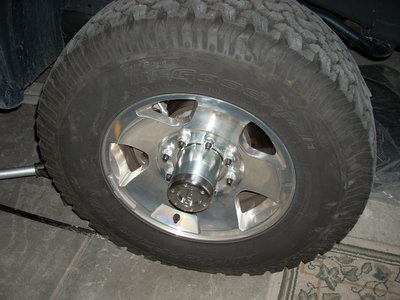

Wheel and tire installed.
Factory hubcap modified to fit over locking hubs. I cut a 4.25” diameter hole in the hubcap.

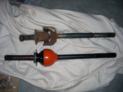

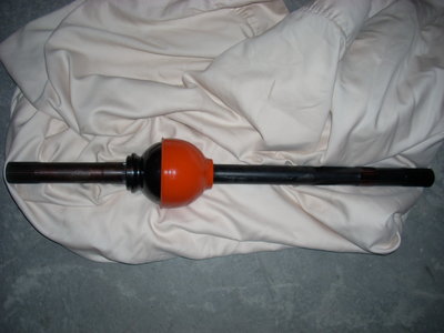

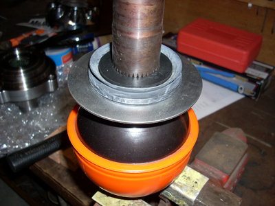

I still need to paint the spindle to avoid rust. The RCV axle joint after installation (passenger side). I’ll give high marks to the quality and ease of assembly with the Spyntec spindle & hub kit. The instructions were OK, but could have used more diagrams especially with the grease seal installations.

CV joints:
I was initially surprised at how rough or jerky, the steering felt with the original U-joint shafts while cornering. I've driven many 4WD vehicles and never noticed significant U-joint shudder during corners. Most of my previous 4WD vehicles were lighter SUVs or Jeeps with less power than the PW.
The CV axle shafts are incredibly smooth compared the U-joint shafts. As soon as I leave pavement, I usually shift into 4WD so I can disconnect the sway bar. Powering through corners is much nicer with the CV shafts than the U-joint shafts.
