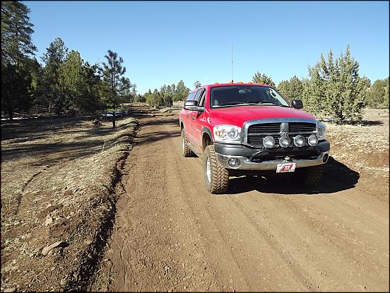

Since I moved the antenna from the d'side fender to the center of the roof, I've been beating it to death with low hanging branches. In reality, it gets hit less than the fender mount did, but when it does, it really gets whacked.
I already had a Pryme RD-98 SMA antenna for the HT, so all that was needed were adapters to use it for the roof mounted NMO connection. I ordered a Comet UHF to NMO adapter and a SMA female to UHF male adapter. When assembled it is shorter than the Larsen NMO 2/70 coil, and the highly flexible RD-98 will easily bend away form overhead obstacles.
Getting good signal reports - full quieting into the repeater about 16 miles away, and simplex reports of decent audio at a 20 mile range into a full tower setup, both at 5W output.
Only draw back is with the RD-98 I am limited to under 20 watts power. That's OK, since for most trail rides I use 5W anyway.

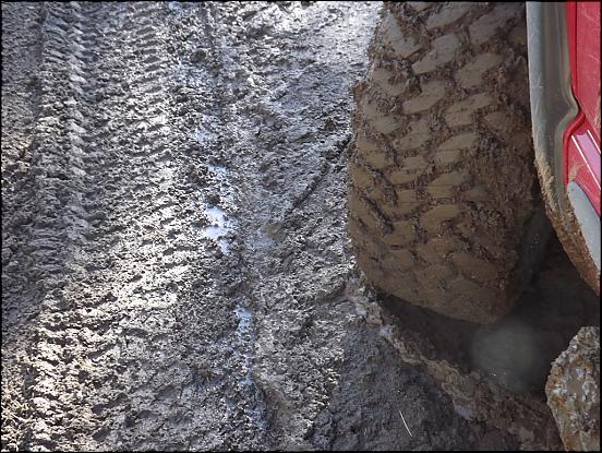

Had an opportunity to get 5 Nitto Trail Grapplers for 6 bills, 4 with 4000 miles, one new. I've never been real happy with the BFG's, so they're off the truck.
They are wide for a 12.5 series tire. I measured the top of the tread at 11" wide. The guys at Discount said they are actually a 13.5 series, even wider than the 315/70-17's.
Initial impressions are great! Did a 80 mile run today on dusty dirt, sloppy mud, crusty snow, and am very pleased with the results. Took a walk to find some 1200 AD ruins near Walnut Creek, AZ. Located the site, and some neat Petroglyph's.
I found no "pull to the left" as reported, but they are basically new. Perhaps that will manifest as they wear, I don't know... The gentleman I got them from ran a set on a SportsMobile for 36K with no problems.
They are heavy compared to the BFG's - I can feel it. But, as an E rated tire, I expect that, and the road manors were good. Very quiet compared to the BFG's.
Dirt traction was excellent. Mud traction was excellent - they cleaned well. Crusty, re-frozen snow traction was good, better than I expected. All in all, I'd rate them very close to the outstanding traction I got from the GoodYear Kevlar MT/R's.

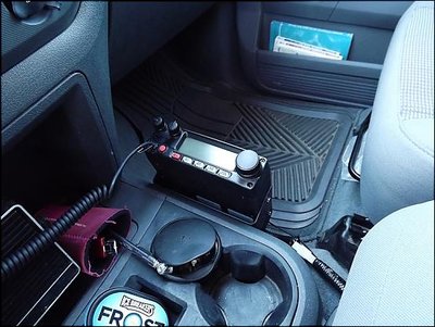

To make a long story short, I decided to use the Yeasu FT-7900R in the Jeep. It's compact, and will work fine for what we do with Miss Rubi.
So, I needed a radio for Cactus Red. Decided to go back to a basic 2M. I don't use 70C at all since the local IRLP node disappeared. I'd had a FT-2800 in the past, and found it to be a rugged radio. It was also easily modified for out of band transmission, a feature I require for use as a Best in the Desert volunteer. I did some reading AFTER buying the new radio , and found out it was different than the older model. The new radio requires that a solder bead be removed to open up the transmitter.
http://www.worldwidedx.com/yaesu/441...-mars-mod.html
This shows the location of the bead and what is required. I was a little nervous about sticking a soldering iron in a new radio, especially when you need a magnifying glass to even see the bead! I stuck the hot iron on it, and the bead went away...
Figured I'd go ahead and reassemble the rig and test it, and all is well.
So, I'm back on the air with a new rig and a 1/2 wave Larsen 150 trimmed to the 146.46 range. SWR is 1.5, so I should be good to go.

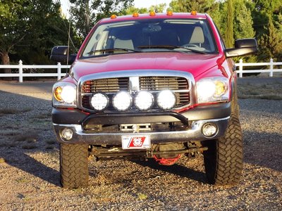

First new Cactus Red update on the Power Wagon Registry!
When I saw the new KC HID's advertised a couple months ago, they were not yet available. MSPP is $546.26, Amazon has'm at over 2 bucks less @ $314.53! Actually just ordered as set for the Heep!
http://www.kchilites.com/lights/hid/8-h ... ng-polymax
With the previous LightForce HID's I used a standard 5 pin relay. Occasionally when running the lights with the high beams, all the locker/sway bar lights would flicker. Never threw a code, or caused a problem, but is seemed odd. Did some research and came up with a different style relay, a Tyco Electronics or Potter & Brumfield T92S7D22-12 six pin. It's a fully sealed and potted industrial relay. http://www.te.com/catalog/pn/en/1-1393212-4 The relay uses low switching power, so I'm hoping the CanBus system won't be bothered by it. The two separate terminals, 0 (power in) and 1 (earth) are for switching power only, when the four main terminals are switched on, they take primary power in and out. Terminal 2 switches to 4, terminal 6 switches to 8.
The install went well since most of the wiring was already in place. The lights are a great fit on the Randy Ellis light bar, the hood closes with plenty of clearance.
I like the beam pattern - it's wide and bright just like a driving light should be. I'll get some photos soon. Adjusting the lights is easy - 6MM Allen wrench and a 13mm wrench do that, and a 17mm takes care of the mount.
The lights are a really nice kit with complete wiring harness, switch, wire loom, and relay! Impressive!

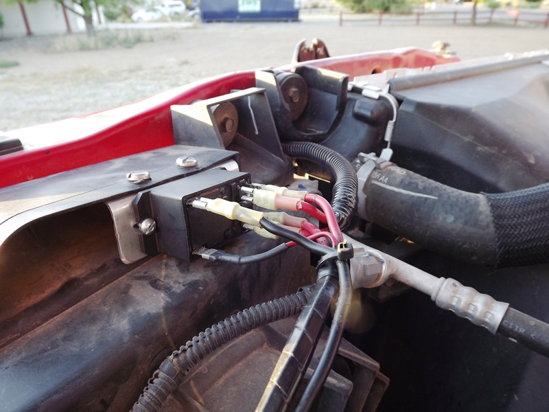

Close up of the relay.
I also used the same type relay on the Jeep. The CanBus on the Jeep causes a standard relay to chatter with the pulsed DC current used to actuate it via the high beam curcuit. It buzzes the whole time it's on, and the lights do the same thing - they flicker. This relay doesn't do that.

So why did you go from the lightforce lights to the KC?

The LightForce Striker 170 HID's have a couple inherant problems. First, the mount is tall, and secondly with the entire lens turning to be focused from flood to spot, it allowed the lights to shake when running rough roads at speed. We have a lot of miles of 4-40 roads (more like 4-50 most of the time) that we traverse on a regular basis, and the washboards really play havoc with the lights at either speed. For normal roads, they were fine.
The KC's have a rock solid mount, and even tho they are also made of plastic, they are rigid when tightened up.
I do miss the LightForce lens covers tho.
If you are looking for some HID's, the new KC's are also a whole lot cheaper to buy as well!

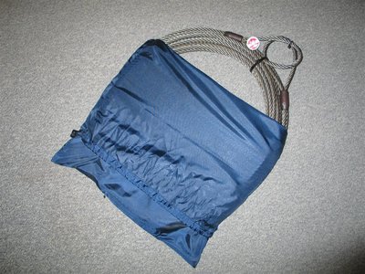

One item I've been missing in the kit is a proper winch line extension. The previous one I had was 5/16" - a little light for the rating of the winch. I'd bought it for my old Tacoma, and it worked fine for that. Decided to order a new one today, and chose the 3/8" x 50' line from Thor at Winchline.com. Of the three colors available, black, blue or orange, I decided on the orange with stainless steel thimbles. I've painted my other recovery gear day glow orange for visibility, both for night work and to make it easy to find if it's put down somewhere, so this should work in the same situations as well.
http://winchline.com/images-products/extensionSEO1L.gif is the same product with soft eyes. I like the thimbles to avoid abrasion on a shackle.
With a rating of 17000 lbs, the 3/8" extension will be more than adequate for longer pulls that do not require using a pulley to double the pulling capacity. One of the main things I've used an extension for is redirecting the pull so I can stay in a spot I'll not get stuck in when recovering other vehicles.
Mark
Mark

That's a nice cable! Great price too - about half the cost of synthetic.cruz wrote:The first (and only) time I've been stuck, I was approx. 150' from the only anchor point around, I'm alone, it was raining and starting to get dark. I eventually backed my way out (with a lot of effort) and headed home. The next day I ordered this 7/16"x100' cable for $109.00 from Acme Rigging. Synthetic Rope was just hitting the market back then and I would of considered it had I known about it. Happy to say I haven't used the extension yet, but its in my toolbox all the time now.Cactus Red wrote:One item I've been missing in the kit is a proper winch line extension.
That's why I carry the 14K PulPal. We crossed a 1/2 mile meadow in deep snow in '09, and the whole time I was thinking about the "what if's". It also lead to thinking about a rear mounted winch, but the PulPal was a lot cheaper.
Re: The Cactus Red mod thread.
Yeah they do nice work, I like how they splice and then swaged the eyes.
Since I'm almost always alone, I definitly need to get a Pull Pal. I also have thought about getting one of those low priced 10k winches and a 2" reciever mount, could probably put it all together for less than $500.
