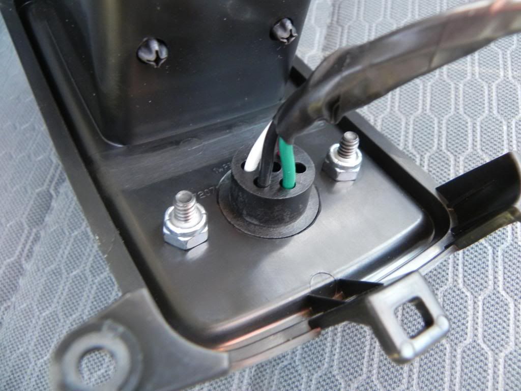

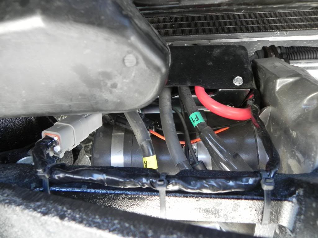

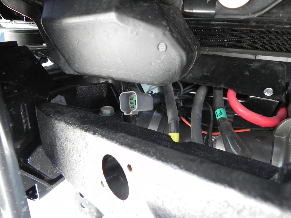

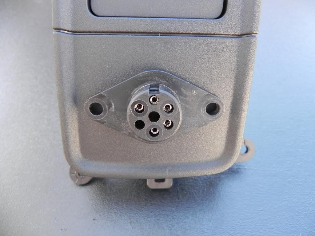

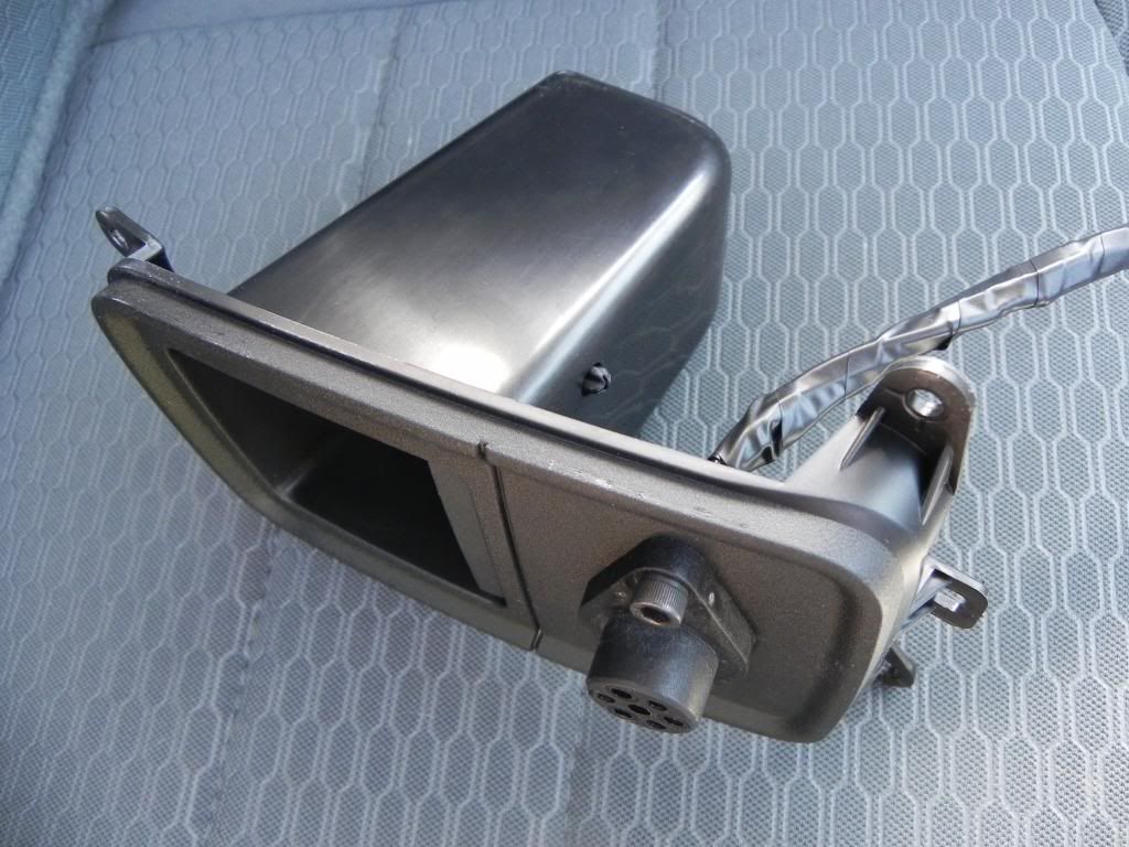

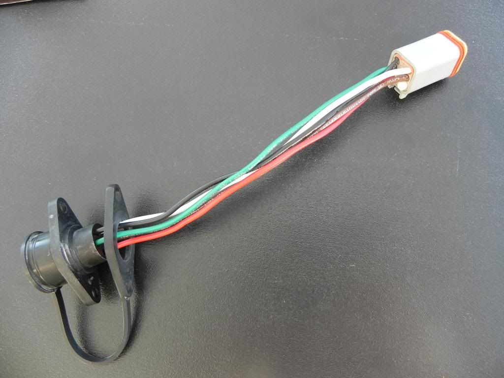

So, I decided to relocate my Winch Controller Port from the front of the truck to the inside of the cab …

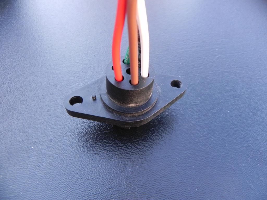

I removed the harness, cut it in half, soldered and heatshrinked color matching 16ga wire, and wrapped the new wire bundle with electrical tape …

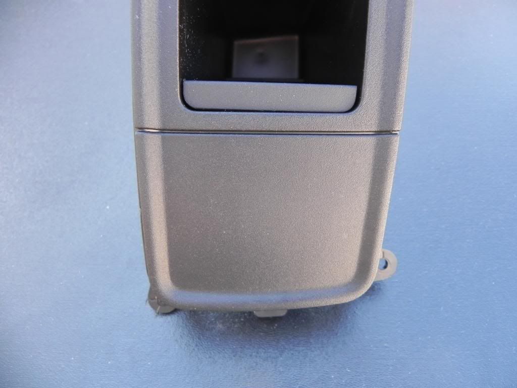

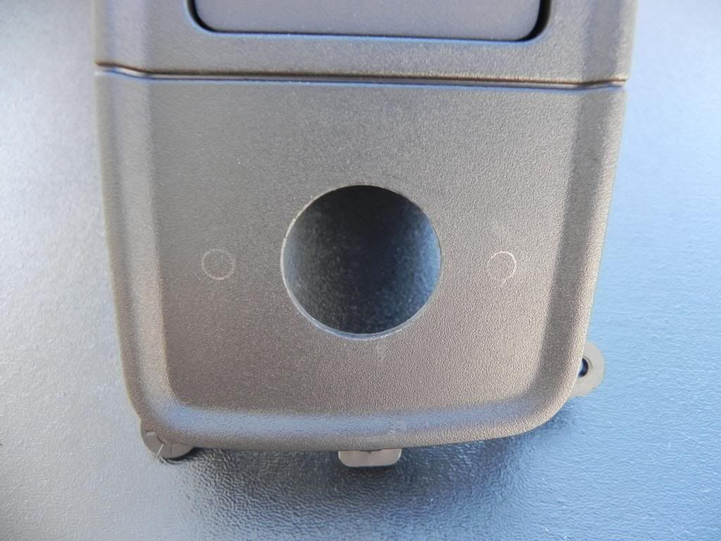

I then started the mounting phase of the Winch Controller Port into the dash panel I chose …

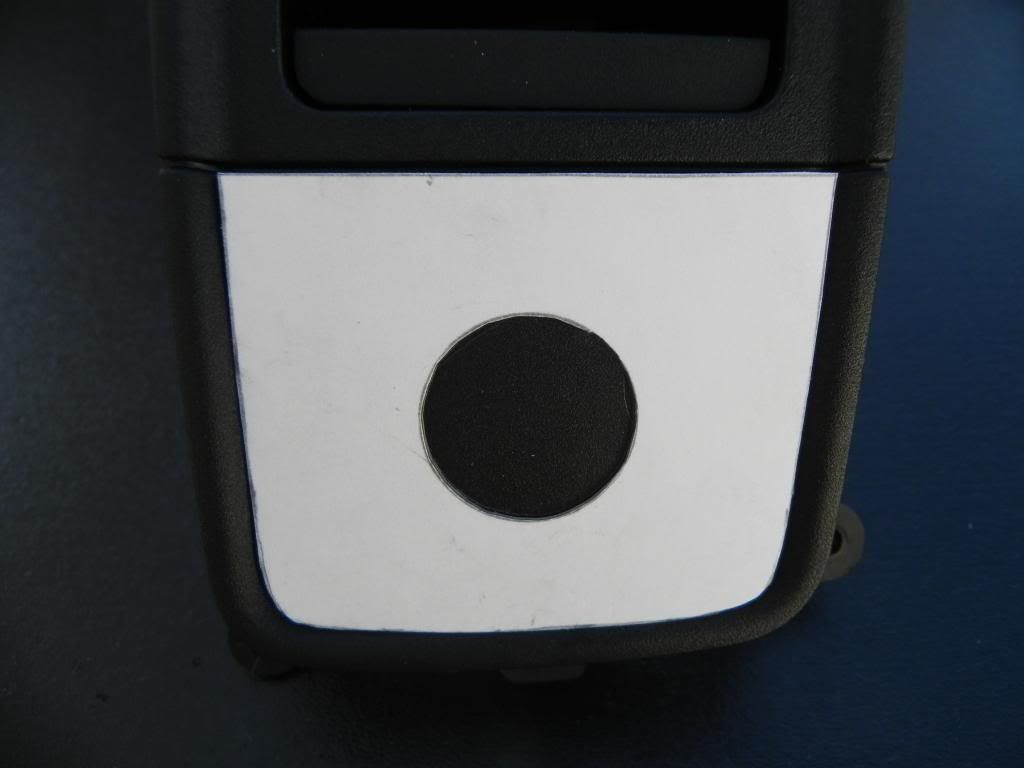

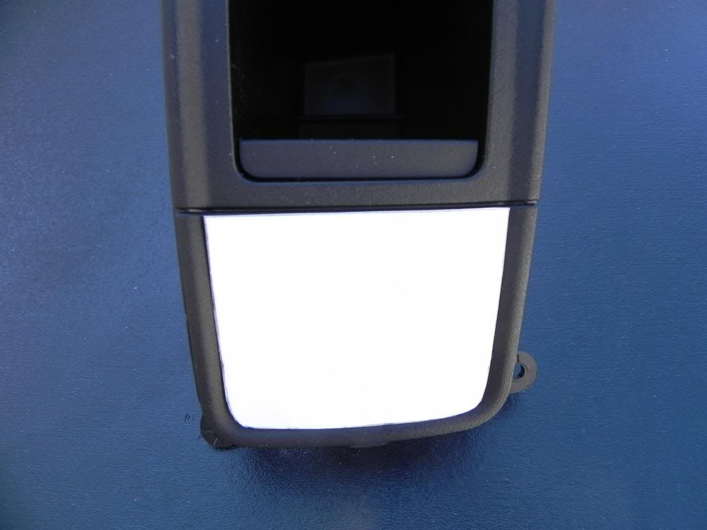

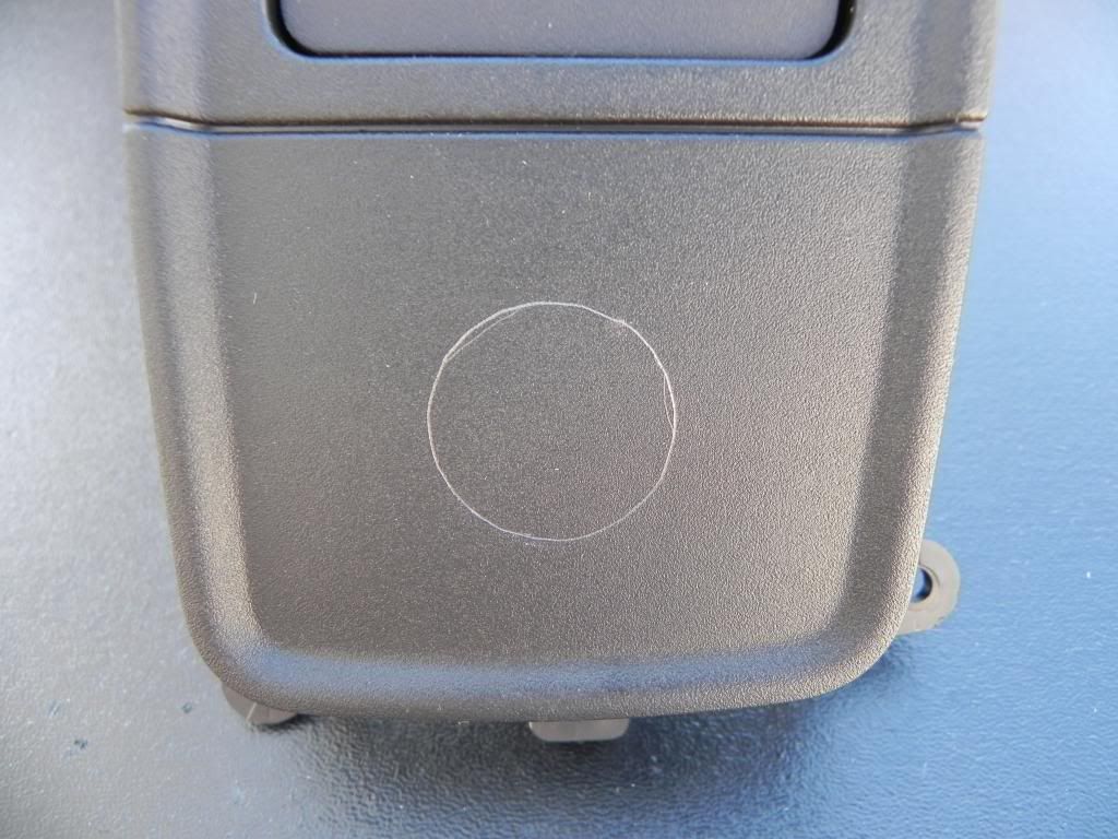

I started by making a cardboard template so I could square and center the Winch Controller Port in the available space …
I measured the outside diameter of the stepped lip located on the back side of the Winch Controller Port and traced the circumference onto the template using a compass …

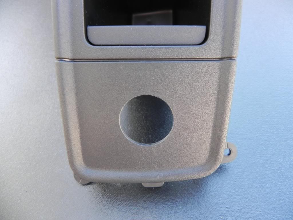

I cut the inner portion out and traced the inside diameter onto the dash panel …

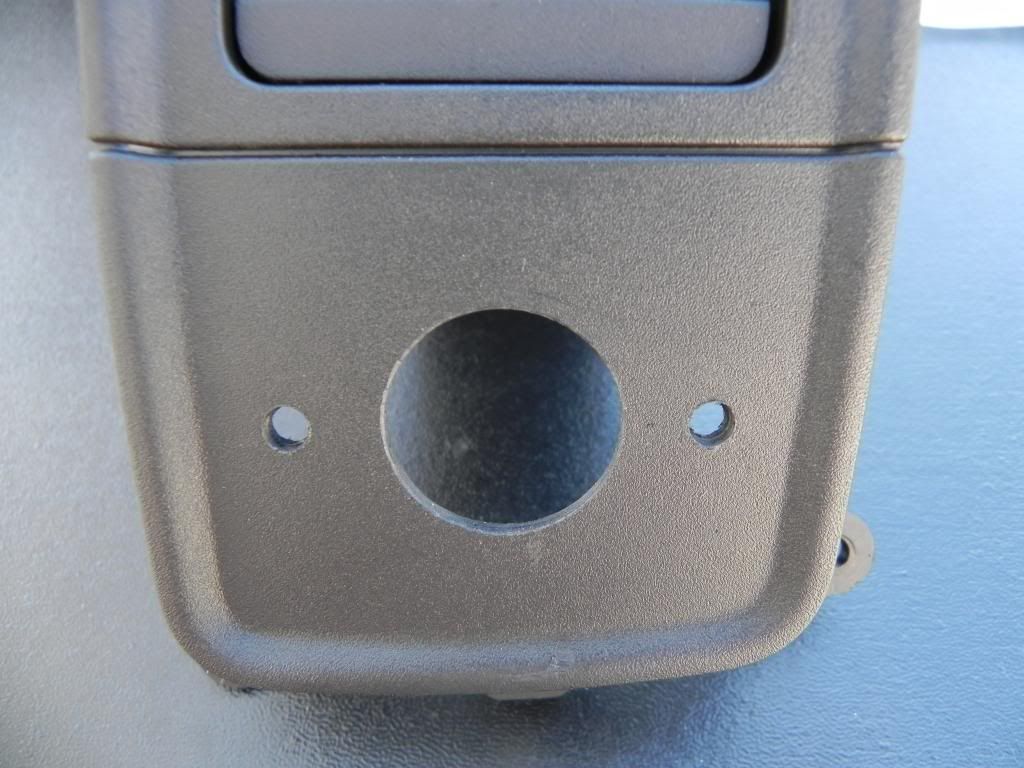

Using a Dremel, I cut an opening and honed it for a perfect fit …

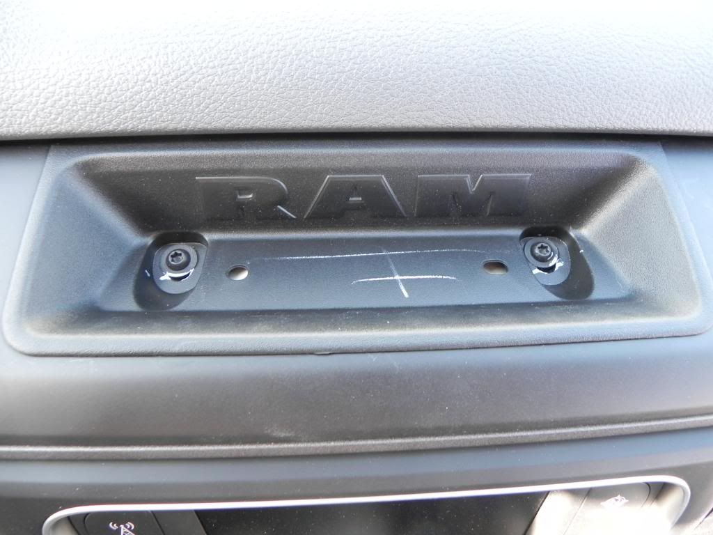

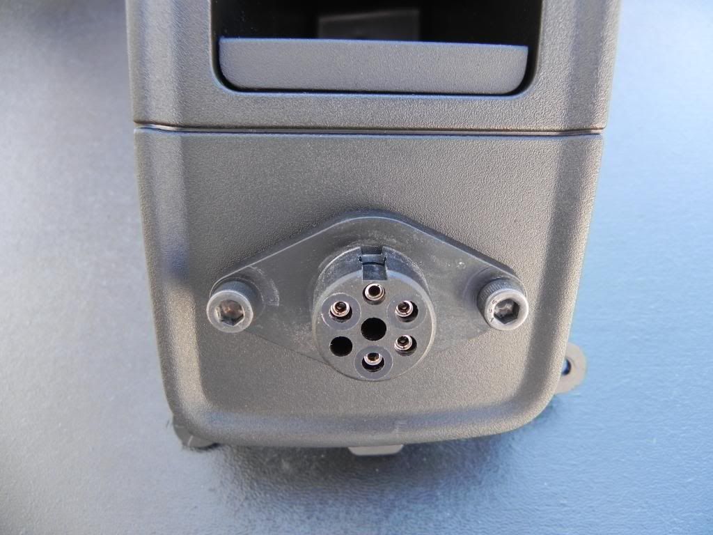

I then placed the Winch Controller Port in the new opening and marked the screw holes …
I Dremeled those holes as well for more control and a tighter fit …
… Then, I mounted the Winch Controller Port …

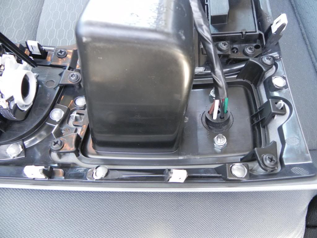

After that I mounted the dash panel back into the dash panel assembly and remounted it to the dash … (Man … that’s alotta dashes!!!) …

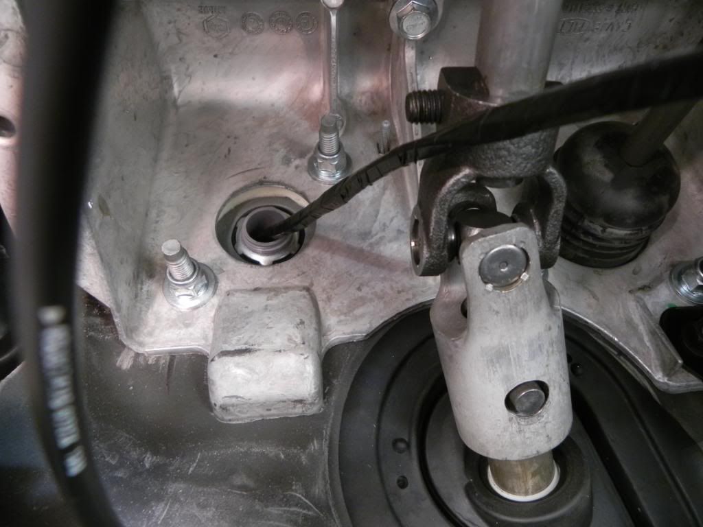

I ran the wire bundle through the port I fabricated last weekend …
I ran it along the wiring harnesses for the winch (Zip-Tying as I went), soldered & heatshrinked the connector end of the harness, and wrapped the last part of the wiring bundle with electrical tape …

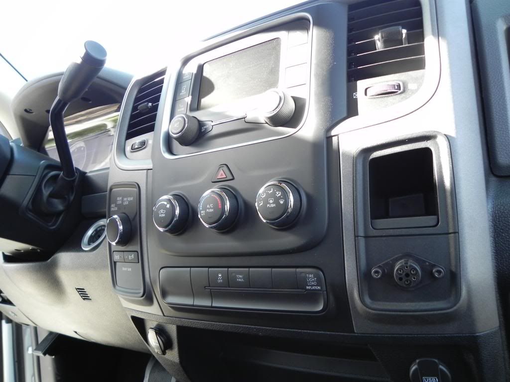

… and here’s what I ended up with … I nice, clean, factory look!
