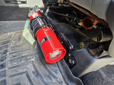

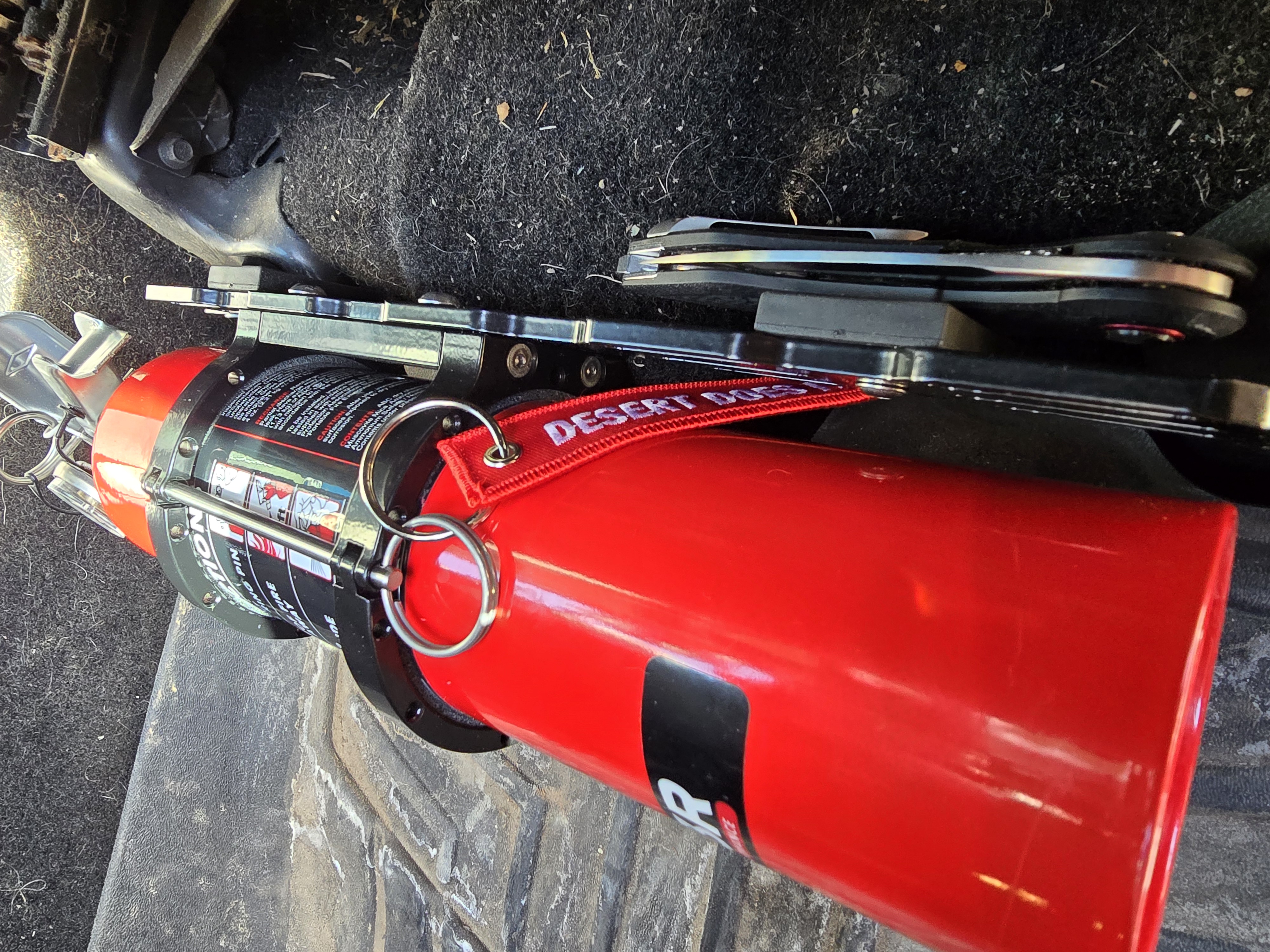

Installed this Desert Does It multi mount panel and quick release fire extinguisher mount. Also bolted on two rubberized magnet mounts to the back of the panel hold my knife and a multi tool. This system mounts to the two front seat bolts. A bit of Dremmel work is required if you want to put the trim piece back on the seat. The extinguisher mount has a quick release pin that you pull out and gravity takes over and makes the extinguisher quickly retrievable.
