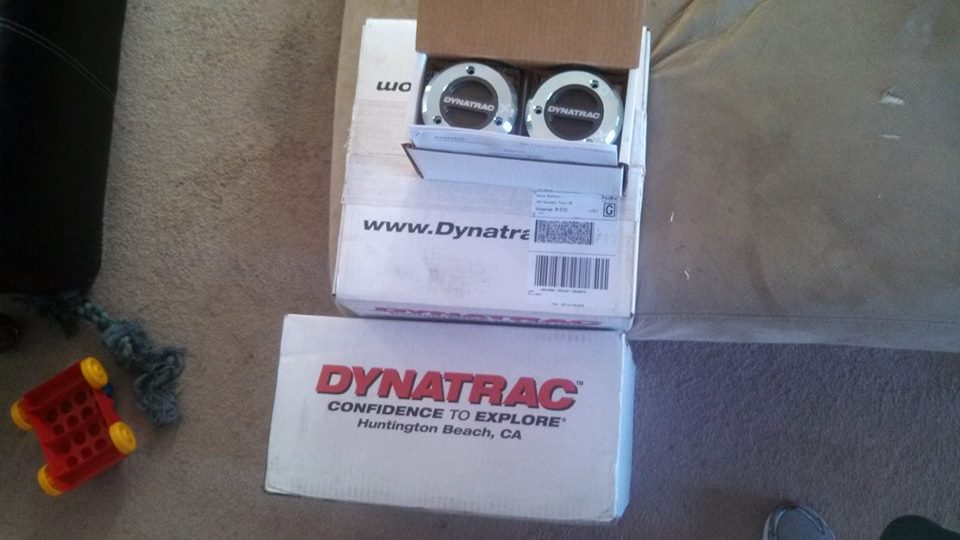

Finally got around to biting the bullet and picking up some free spins to button up the front end

These things in yet or what?! Don’t be like me and let life take over the priorities... #truckisalwaysnumberone

Ha, I won't be stateside for a couple more months here...but there will be a big ol' pile of parts waiting. Changes are a coming2wagons1driveway wrote: ↑Sat Mar 30, 2019 2:22 pmThese things in yet or what?! Don’t be like me and let life take over the priorities... #truckisalwaysnumberone

Oh yeah...the good stuff is starting to roll in. Can't wait to see the difference between Thuren's leafs and the Atlas's I'm running now.

Finally making progress on the truck...new ring and pinion in the rear. Turns out the shop that installed the gears didn't torque down the crush sleeve correctly and as a result allowed the pattern to essentially be fucked. Working now to get the original shop to reimburse me. Dynatrac hubs are on, glass is somewhat fitted, and LT leafs are on. Turns out the 40"s are going to be an epic pain in the ass to completely clear at cycle
