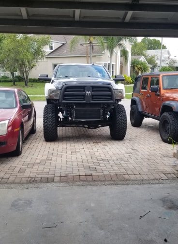

Do you have a standard Thuren 4th Gen bumper? If you do, 40's will not work with it.

The same reason 40's won't work with the stock bumper or OE fenders, there's not enough clearance. Look at side profile pictures of the bumper with stock fenders and flares.

Are you talking at full stuff they'll contact? I'll have to do a little measuring to see exactly how much up travel I have until I'm hard on the boogies but just from eye balling it and the side profiles you're right, looks like it'll be close but man it only be when really slamming the front end

I think he’ll be fine. This is full stuff with 6” lift drop blocks for the bumps at full compression with a 37” Toyo so a 40 would be fine considering beryl is running a 6” kit as well. The drop blocks for the boogies are 2” so they add quite a bit of fender clearance compared to a 3” kit stuffed and in all honesty if he runs into frame horn issues or the side pieces of the Thuren bumper giving him problems just cut the fuckers off and reweld plugs on the ends.

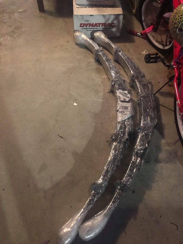

Oh yeah...the good stuff is starting to roll in. Can't wait to see the difference between Thuren's leafs and the Atlas's I'm running now.

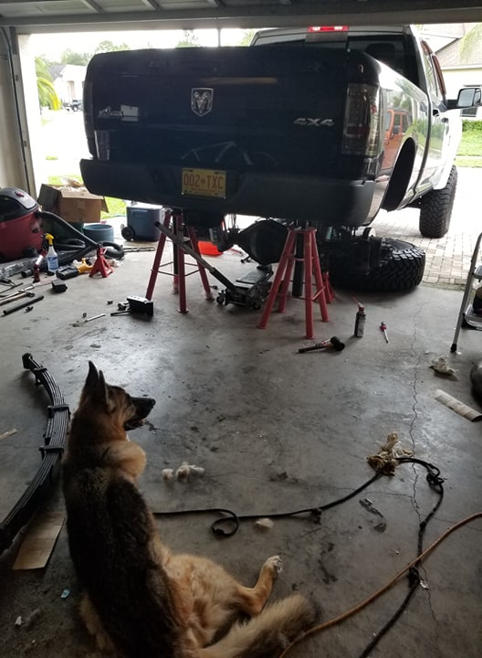

Re: bstefanic's Build - 2013 2500 - "Wanna Be Wagon"
Post by bstefanic » Sun Aug 18, 2019 8:04 pm

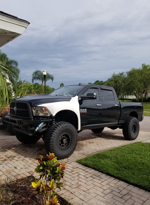

Finally making progress on the truck...new ring and pinion in the rear. Turns out the shop that installed the gears didn't torque down the crush sleeve correctly and as a result allowed the pattern to essentially be fucked. Working now to get the original shop to reimburse me. Dynatrac hubs are on, glass is somewhat fitted, and LT leafs are on. Turns out the 40"s are going to be an epic pain in the ass to completely clear at cycle

Even with 6" of lift you need to cut out the front of the cab, the rear of the front fender, and the rear of the front bumper. Lee's photo's are directly from the side, eventually you have to turn though. 40's fit the rear with almost no trimming.

Post by bstefanic » Fri Jan 17, 2020 8:49 pm
Has been forever since I've been on here...had to get the rear end re-done by a shop that actually knows what they're doing. Still need have a lot to do but its certainly fun
