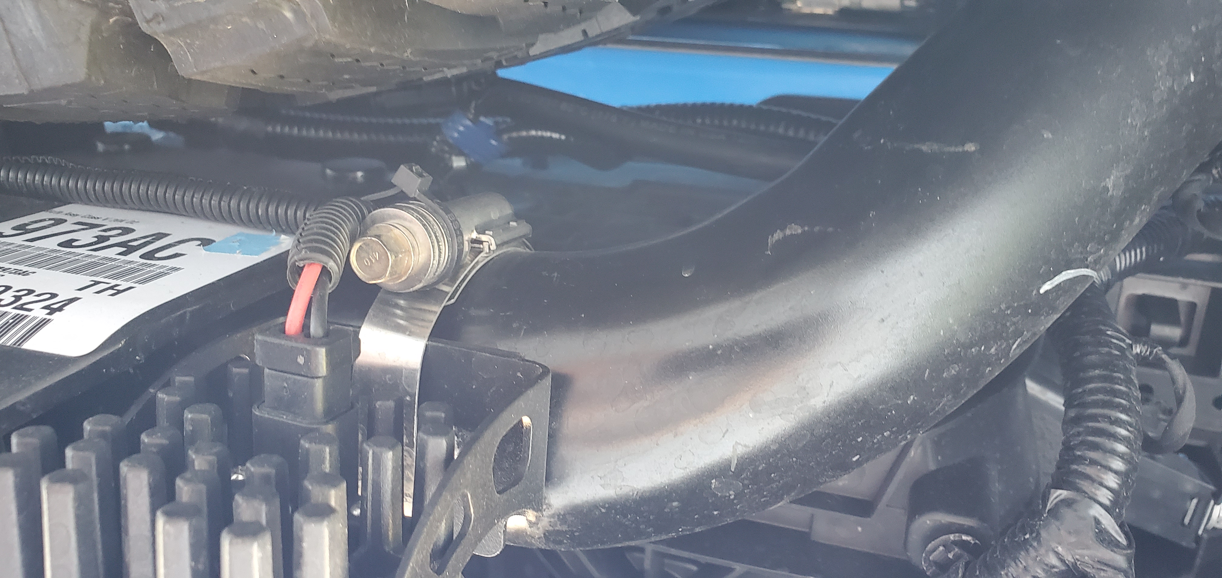

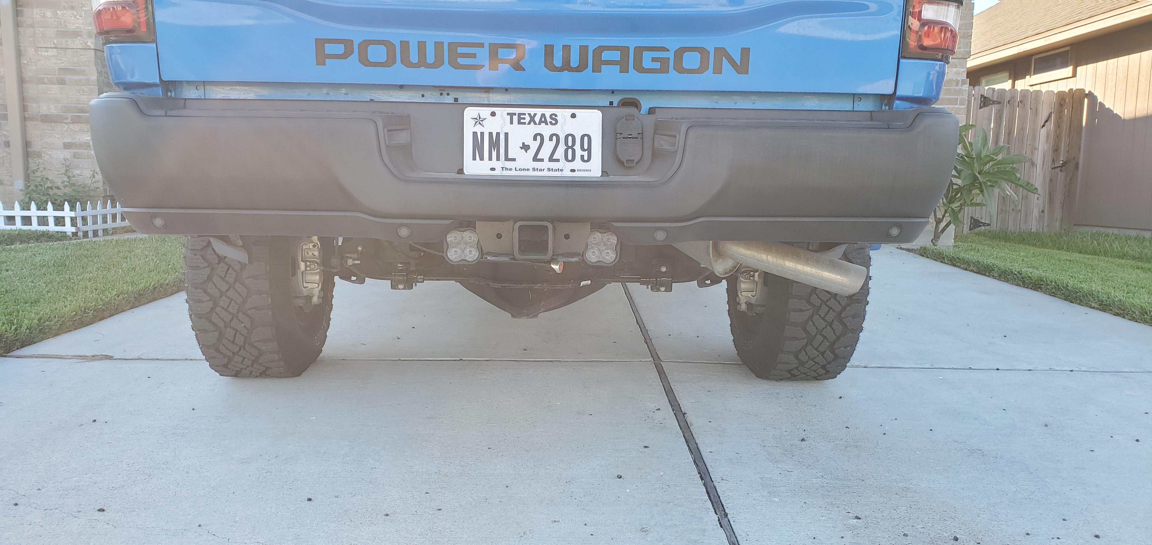

I added auxiliary reverse lights to mine, diode dynamics, sae fog pattern.It can be done without addon brackets and they will be out of the way, ill take pictures today and post later.

I have a 2020 and i added auxiliary reverse lights without adding brackets. Diode dynamics ss3 sae fog wide pattern.
