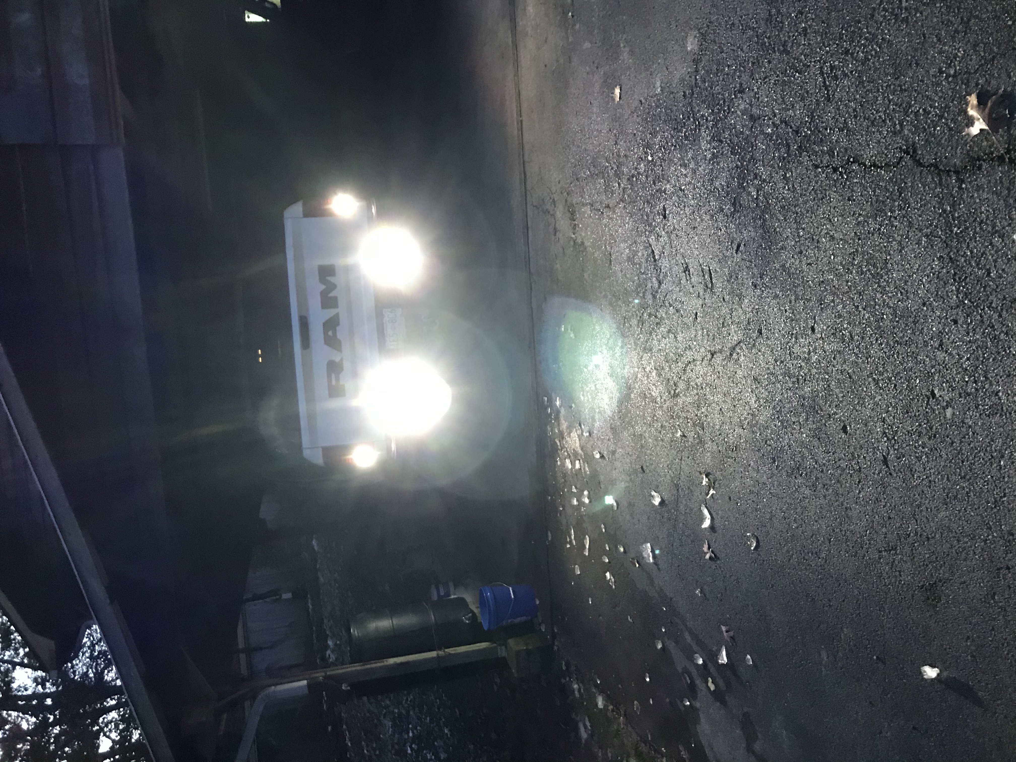

I had already done some cheap e bay bulbs and they were quite a upgrade.
Enjoying beautiful east TN
SimonandSimonBeast
Posts: 425
Location: Upper Salford, PA
Re: Rear reverse light pods
Post by SimonandSimonBeast » Mon Dec 02, 2019 10:09 pm
Easttnrhino wrote:I had already done some cheap e bay bulbs and they were quite a upgrade.
Damn, you could get a tan behind that truck at night.Image
