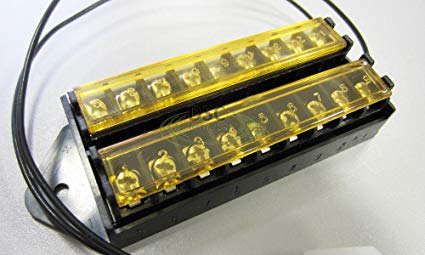

I was thinking something like this that would output 5vdc with screw lugs and I could chop up a usb cord

Some USB devices need to negotiate with the host/charger for power delivery, so just putting 5V on the lines doesn't work with those devices.
Very device-dependent. Samsung phones are really picky about what they'll take power from. My Motorola stuff doesn't care - if there's power there, it'll take as much as the host will allow and back off current if it starts to crowbar. Apple stuff is, well, Apple. Better use their approved charger, and plug it into an approved outlet, or else...
Dashcam and GPS probably won't care, but the newer GPS's are behaving more like phones. Bench-test it first.
DC-DC converter will get you 5V, check your power requirements first. https://www.amazon.com/dp/B01MEESLZ6/ (chinese, so use at your own risk...)
