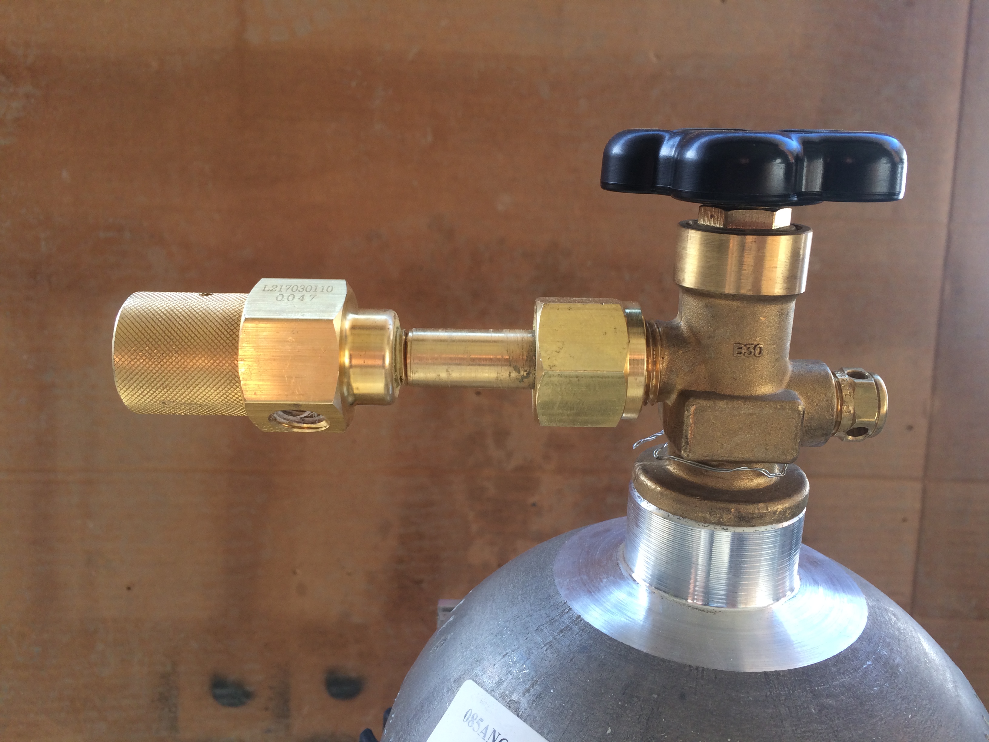

I went the cheap DIY route. I ordered an aluminum 15# CO2 tank from a microbrew supplier online. You can find these all over the internet. I chose my particular vendor because of their this-must-be-a-mistake cheap shipping to Alaska. $90 for the tank, $21 for shipping, can't beat that. Aluminum tanks bigger than the 5# tanks the home brewers use are impossible to find in Alaska, so I had no choice but to order out.
For a regulator, I ordered a Gentec model 227C-150. This is a ~$40 China-made fixed pressure regulator with no gauge. It's sold by a number of off-road shops with no brand, but you can find it more places by googling the model number. The cheapest place for me ended up being Amazon thanks to free shipping.
The regulator has a 1/4" FNPT outlet port, so from there it's a matter of attaching your favorite combination of hose and fittings.
My local welding gas supplier "serviced" and filled my tank for less than $40. It took them 5 days to turn it around because they don't fill on-site, but at least I got my rare-as-hen's-teeth aluminum tank back. I'm going to keep looking for a place that can fill same day for an agreeable price, but if I can't I might get a second tank so I don't get sidelined for a weekend waiting for a re-fill.

Yesterday I tore apart the inflation gun and did surgery on all the flow ports. There was room to open things up quite a bit. I also swapped the closed-flow clip on chuck for an open-flow screw-on chuck. Those two changes cut the inflation time in half.
I did have to return the high-flow quick connects I was using. They felt cheap, and sure enough they leaked unless they were lined up perfectly straight. I haven’t put together the 1/4” industrial quick connects I got, but if they restrict the flow much I may work on them too.
I took apart the regulator and found that the supply side piston seat is very small and doesnt leave much material to open the flow path up. I’d be able to go up one drill size at most, so I probably won’t mess with it. The small gains available don’t seem worth the risk of ruining the regulator.

You are not wrong, but there are not a lot of options out there for that. The plastic handle/cages that come on most beverage bottles wouldn't fit on my tank even if I could find one for sale by itself (they're retained by a snap ring, my tank does not have the snap ring groove and I think the neck is the wrong OD). PT's handle is cost prohibitive once shipping is factored in. That leaves me with the ebay rip off option or making something myself.13BlkPowerWagon wrote: ↑Wed Apr 04, 2018 1:39 pmMaybe I'm being too cautious, but I'd want some kind of cage/protection around that stem. No?

PT claims that CO2 tanks "don't" turn into missiles, but I'm not about to fact check them on that. The Quick Fist and hardware I made for the RamBox track seems sturdy enough, but if it bounces around too much for my liking I'll spring for a proper fire extinguisher mount. When it goes in the truck, it's up at the front of the bed, boxed in by my RamBox divider and fuel cans, so nowhere to go but straight up if the clamp lets go for some reason. .adeluca73 wrote: ↑Wed Apr 04, 2018 4:07 pmSweet DIY!! But at nominal CO2 pressures with vape pressure increase as function of temp, I'd be worried about that tank turning into a missile in the back of the truck. I can't do anything about the one riding around the driver's seat, but I'd probably try to sequester that manifold from unintended jouncing while hittin' it off-road.
