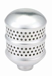

Here is the intake that you can't see in the bucket (I just got mine from Lowes, but it is the same thing, has media and a screen in it for filtration):
