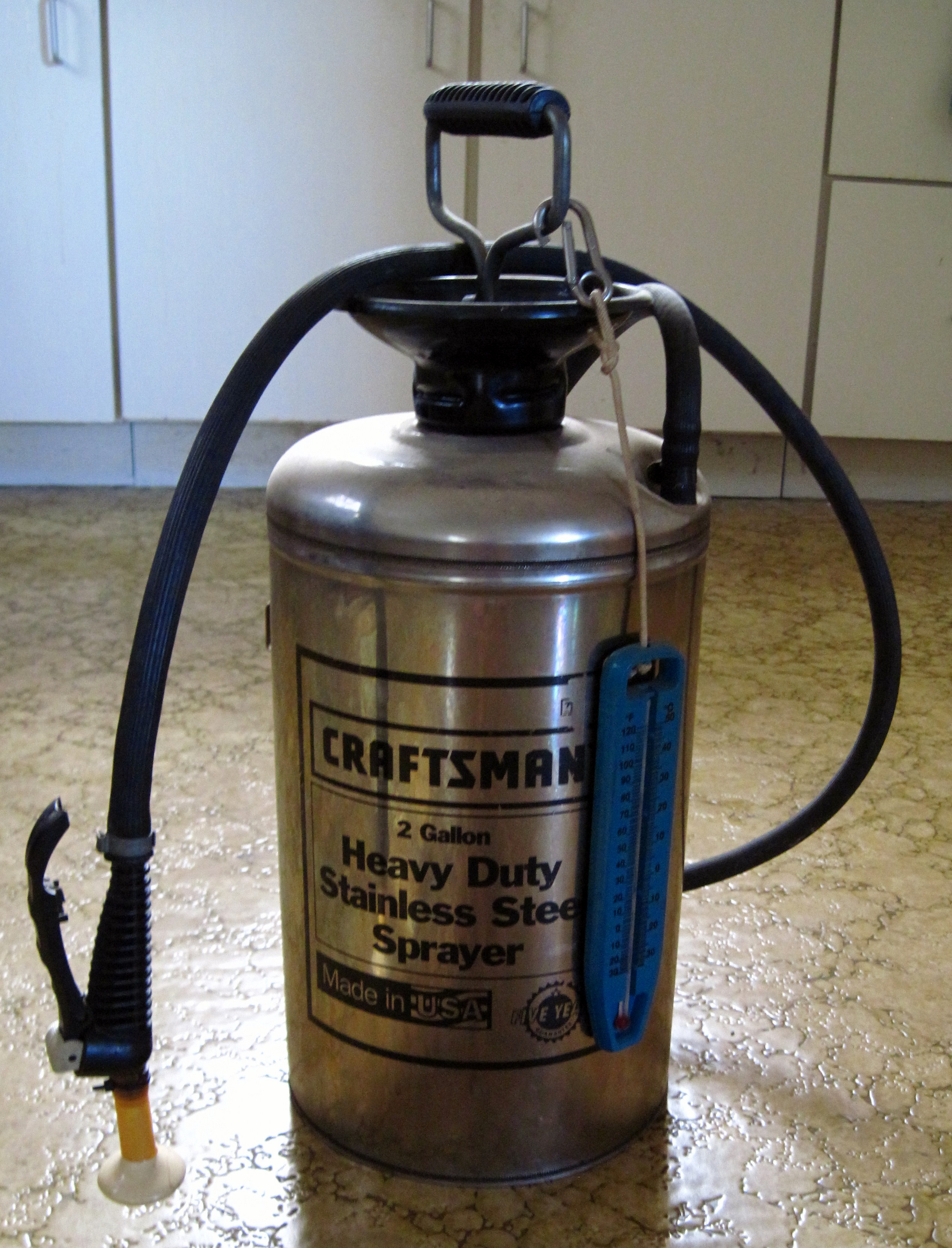

Years ago when I was still tent camping, this was on my wish list but I thought it was too expensive. One day I went to SEARS and I saw they had a sprayer on sale for 50% off. I looked it over real close and then went across the street to the sporting goods store and checked out the Extreme shower and they were almost identical ( edit; to the ones that they were selling back 18 years ago when I did this). Went back to SEARS and bought one for $25, put a nozzle on it and got a pool thermometer for $6 and was good to go. Works great.

Post by dogcar3 » Thu Apr 03, 2014 8:19 am
A pool thermometer is a great idea. I am going to have to pick one of those up.
