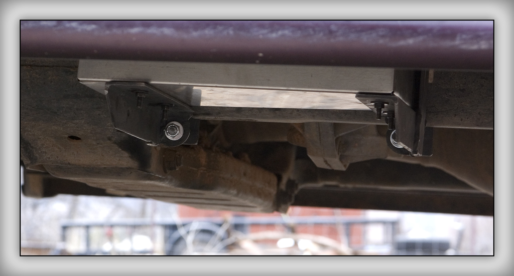

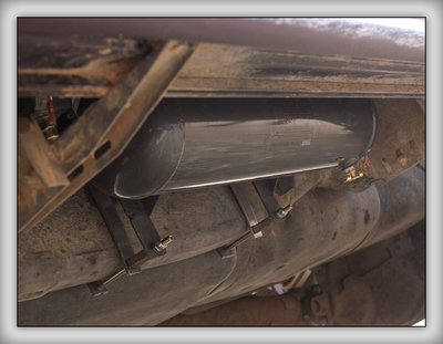

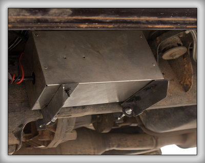

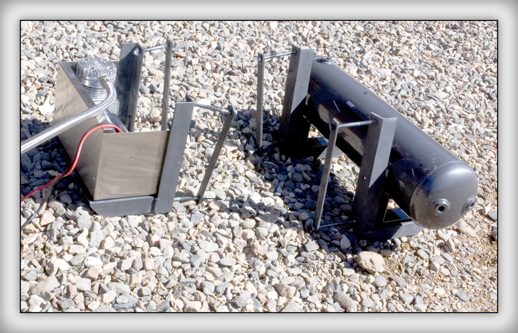

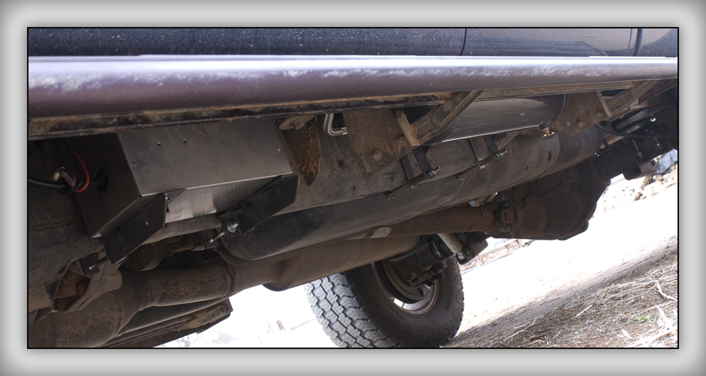

OK, so I made a stainless steel splash gaurd for the compressor and brackets to hang from the frame rails. Under the drivers side, not plumbed or wired yet .....
I have a different drain valve on the way but will probably make a skid plate to protect it: The compressor doesn't hang as low as it looks in the previous pics but if I was going to rock crawl I would have put everything in the tool box in the front of the bed.
Re: on board air
Looks pretty good! Wish I had the funds to do some more mods like this.
Re: on board air
Same kit I have. No problems at all so far. I like where you mounted the tank. I went the easy route and put it in my truck bed under the truck box.
