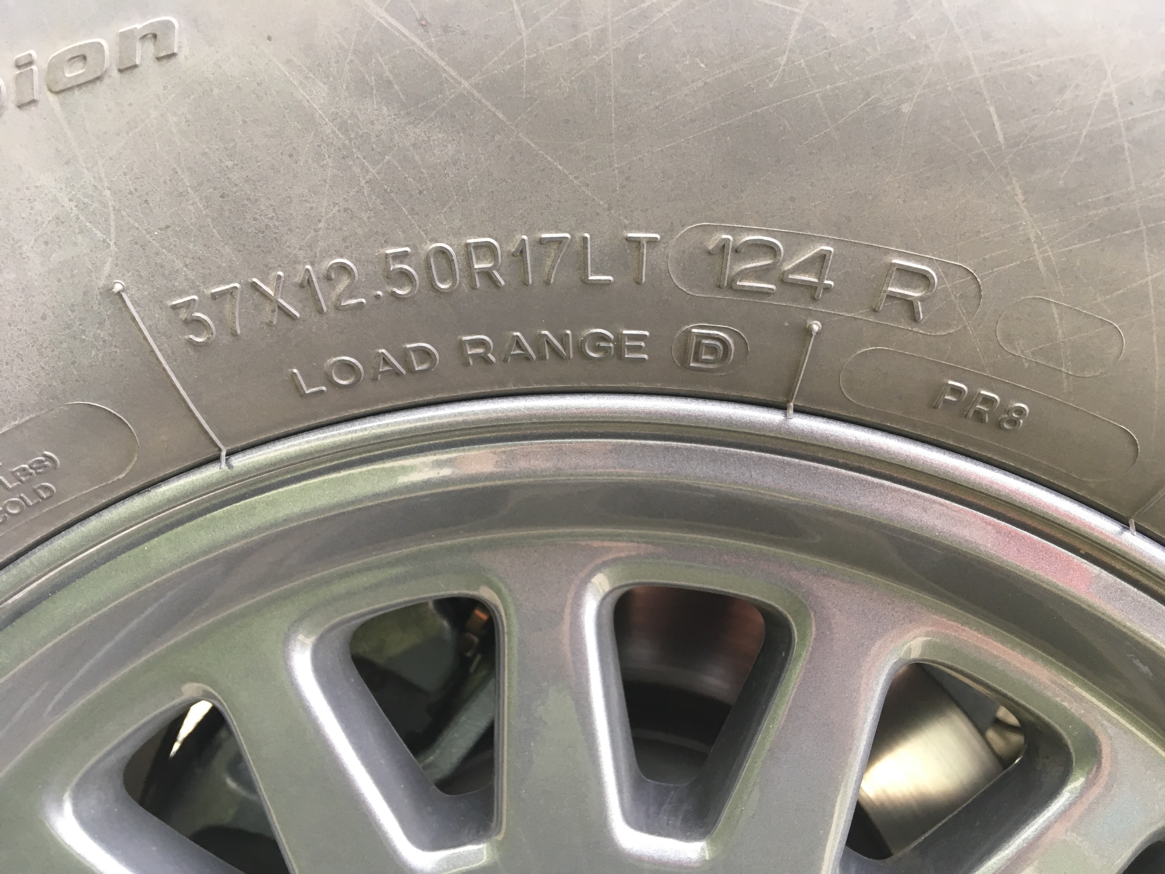

Probably talked about a lot but I am looking to see what anyone with similar setup is running for air pressure.
I have a 2017 PW with AEV lift, saltas, and 37x12.5x17 bfg ko2. Thanks
