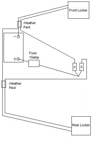

I've seen write ups for hotwiring the lockers in a PW, I'd like to know how n what
to wire on a NON Power Wagon. I'm sure I'm not the 1st person to do this, Right?

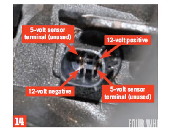

To add the axles, the wiring is very easy. Just need 12V hot and ground wires, and switches in the cab. The other two wires in the plug are for the sensing required by the smart bar. A little searching on this forum will show you the pin outs in the plugs. If you want to move the smart bar over, just do it with an EVO manual knob.

The loss you're going to take selling the Power Wagon without locking axles and winch will exceed the cost of lockers and a winch in the new truck. Wiring the electric lockers is simple, it's just positive and negative through a relay.

This is the connector you'll need for the axles.
https://www.ebay.com/itm/1-Harley-4X-GR ... m570.l1313
Use these plugs to cap off the two empty cavities you'll have in the connector.
https://www.ebay.com/itm/10-Harley-Mole ... 1105712565
You'll need this kind of tool to crimp the terminals correctly.
https://www.ebay.com/itm/Molex-Style-Cr ... .TRS0.TSS0
You don't have to run the 12V negative wires back to the battery, they could just ground to the frame.
Good luck!

- Posts: 1209
Re: PW Axle n Suspension Swap Question (& Locker Wiring)
The locker wires don't exist in the Mega Cab wiring harness. You're going to have to tap into the big red and big black wire on top of the battery.
There's currently no hardwire option for the sway bar.
Any switch with a rating of 10 amps or more per axle should do the trick.
