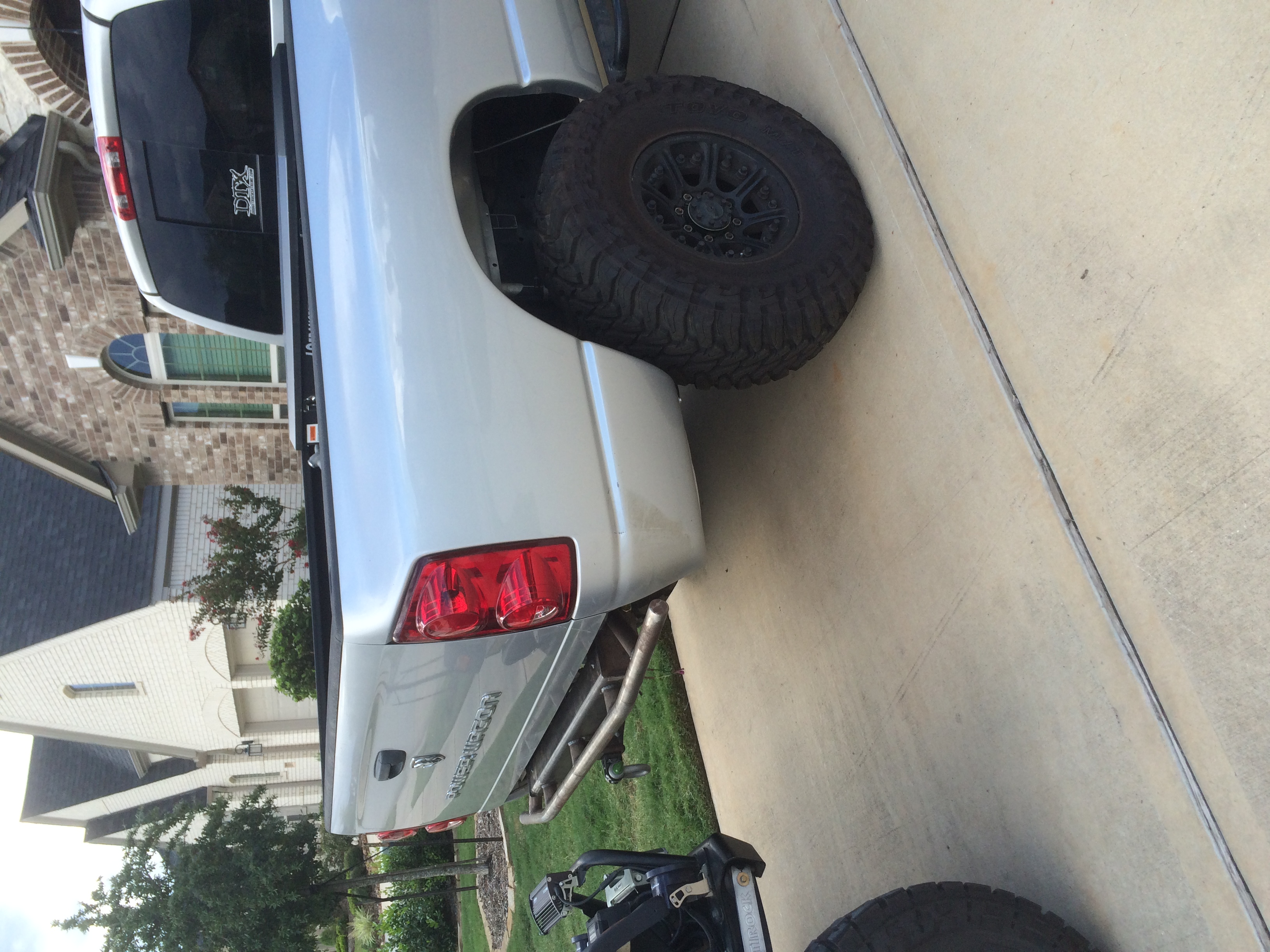

Got the oem tow hitch pulled off today, it was a real pita. Had to pull the bed bolts and jack it off the frame to rotate the hitch up and out. Got my pattonfab/Thuren tube bumper installed too. It's at least 18-24" more clearance out back now! Next up is cutting the lower rear bedsides to match the new lines and gain some additional clearance. Can't say enough about the quality of this beast. Anyone in need of a high clearance rear bumper should give pattonfab a serious look. Great guy to do business with and he does top notch work.

NovA ProspekT
Posts: 138
Re: Boogie wagon take 2
Post by NovA ProspekT » Wed Sep 14, 2016 1:13 am
Looks good man!
I might eventually do something similar with the rear-end using a Mercenary bumper.
What's the plan for the front bumper? PattonFab tube style?
