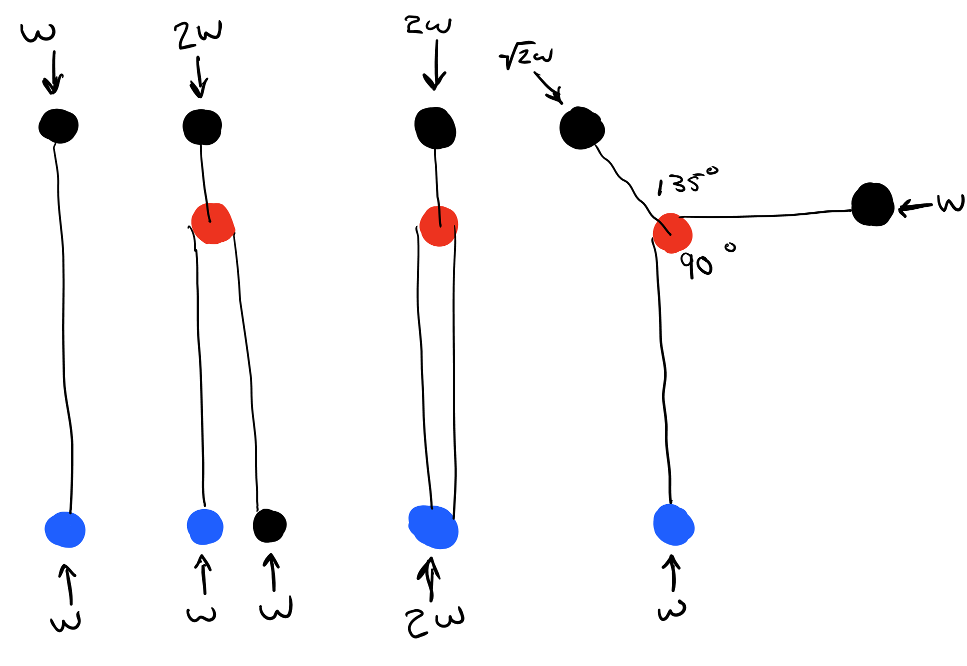

Cactus Red, I'm not a rigging or recovery expert, but I am a mechanical engineer with too much time to read and think about this stuff. I'm sure that you have put more feet of cable through 20k pulleys than most anybody, but I just can't get on board with the math.
A block needs to be rated to twice the winch capacity, because a doubled pull (assuming 15,000 lbs for the PW winch getting enough current) can transmit up to 30,000 lbs through the block to the anchor. A safety factor would then need to be applied to that 30,000 lbs maximum pull. The off-road industry doesn't seem to have a standard for how safety/design/fudge factors are applied to recovery gear, but it appears that ARB and Warn use approximately 2.0 SF. In the case of Warn's "33,000 lbs" block, it's clearly a 6.5T WLL yarding block (it's actually cast into the housing).
6.5T * 2000 (lbs/T) * 5.0 SF (rigging industry standard) = 65,000 lbs ultimate rating
65,000 lbs / 2.0 SF = 32,500 lbs (Warn's rating, I wonder if it's a coincidence that they re-brand and sell a block rated to a doubled pull from their strongest winch?)
Granted, a rig will never see the winch's maximum pull unless the load is so badly stuck that the winch motor stalls out with the winch line paid out to the last layer, but I believe the recovery gear should still be rated for that worst case scenario.
As a hypothetical worst-case recovery scenario, an 8000 lbs PW mired up to the frame (3.0 resistance factor), pulling up a 45-degree slope (0.75 resistance factor) needs a 30,000 lbs pull to get out (or so says the Army's recovery field manual).
(3.0 + 0.75) * 8,000 lbs Loaded Weight = 30,000 lbs Pull
*EDIT* I corrected "last wrap" to "last layer". Pulling from the last wrap makes for a very bad day!

Again, the load can't exceed the rating of the winch at any attachment point. The physics are straight forward. You do get a theoretical 30K of load, but it"s split between two points, the pulley and the anchor point. That's just the way it works. Here's some mathematics that show it better than I can explain it.

Take a closer look at the page you posted, under the "moveable pulley" header ;)

Cactus Red wrote:Again, the load can't exceed the rating of the winch at any attachment point.
If this is true, then crane companies have been wasting money on all those expensive blocks and way too much wire rope.

So, the load on each line is no more than the rating of the winch pulling in the cable, but the load at the moving hook is higher. In our case, the pulley is fixed to a tree or PulPal. The moving load is the truck itself with only one point fixed as it were.

Try thinking about it as if nothing is moving. Imagine that the truck is fixed too, and is just using the winch to exert tension on a static rig. I'm bored tonight, so I drew pictures :D
Anchors are black dots, Power Wagons are blue dots, and single blocks are red dots. The winch exerts W pounds of tension. For easy math, all winch lines are parallel except for the last example. No friction from the blocks.
1. The first diagram is a straight pull. The Power Wagon is experiencing a pull of W, and the anchor is experiencing an equal and opposite pull of W.
2. The second diagram is also a straight pull. This is the scenario that people sometimes "think" gives them a double advantage, but does not. The only benefit to this rig would be to get line off the drum to get down to the last wrap. The Power Wagon is experiencing a pull of W, the anchor right next to it is also experiencing a pull of W in the same direction, and the anchor with the tree strap and block is experiencing an equal and opposite pull of 2W to keep the system in equilibrium.
3. The third diagram is a double pull. The winch line goes through the block, and back to a tow hook on the Power Wagon. Two connections to the winch line means the Power Wagon experiences a pull of 2W. The anchor experiences an equal and opposite pull of 2W.
4. The fourth diagram is a redirected single pull. The placement of the anchors just happened to work out for really easy math. Lucky me! The Power Wagon experiences a pull of W. The right anchor, connected to a single leg of the winch line also experiences a pull of W. The anchor connected to the block is connected to two legs of winch line at 45-degree angles and feels a pull of 1.4W. The higher the angle between the two winch line legs, the less pull the block anchor would feel. The lower the angle between the two legs, the more pull the block anchor would feel. If the angle between the two legs was zero, we'd be back at scenario 2. If the angle was 180, we'd be back at scenario 1.
In every scenario except #1, the block, tree strap and shackles between the two need to be rated for more than the winch rating. You get more rating out of your tree savers if you rig them with a basket hitch versus a choker hitch. I won't even get started on rigging for triple pulls, especially since that would be done using more hardware rated for double pulls. No need to go shopping for 1" shackles :)
