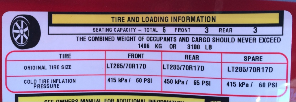

Question
gvwr = 8510 lbs (per the door sticker) when i registered my truck I had to have it weighed = 6100 lbs. 8510 - 6100 = 2400 lbs
2400 lbs is what the people + stuff can weigh before the truck is over loaded ....correct ?
Provided the tires are rated for that ?
thanks in advance

Re: How many of you are overweight?
Post by FirerescuePW » Wed Jul 08, 2015 6:21 am
Yes. Any weight you put on or in the truck.

Post by adeluca73 » Wed Jul 08, 2015 12:05 pm
Yes, x2

In this day and age of technology - there's lots of options to address the overweight issue...
Your sticker WILL be different than mine :D

Takingatrip1
Posts: 124
Joined: Wed Jun 18, 2014 8:06 pm
Location: Southern California
Post by Takingatrip1 » Wed Jul 08, 2015 9:35 pm
So that figure for the tires... That's adittional load not including the truck?

Posts: 1543
Post by Bill2014 » Thu Jul 09, 2015 10:58 am
Takingatrip1 wrote:So that figure for the tires... That's adittional load not including the truck?
Sometimes people obsess over the term payload - Ram classified the Power Wagon with a GVWRC of 8510 pounds despite it being a 3/4 ton truck. It has been classified that way through each of the modern generations. A standard 3/4 ton Ram with a 6.4 hemi and 11.5" rear end is given a GVWRC of 10000 pounds.
So what is the capacity of the tires?
Goodyear specs. the LT285/70-17 to 3195 lbs @ 65 PSI and that is 6390 lbs for the pair. So driving on the highway, at highway speeds, fully inflated, they can carry that much weight.
What is the capacity of the AAM 11.5 rear axle?
It's listed as 6010 pounds - which is less than the pair of Load range D DuraTracs.
The 2014 PW rear end weighs about 2880 pounds - so considering only the tires and axle the most you should carry on the rear end is:
6010 - 2880 = 3130 pounds max payload :duel: Carrying more than this will overload your axle
Of course there are other factors which can de-rate your carrying capacity :D such as the "soft" PW rear coil springs...
