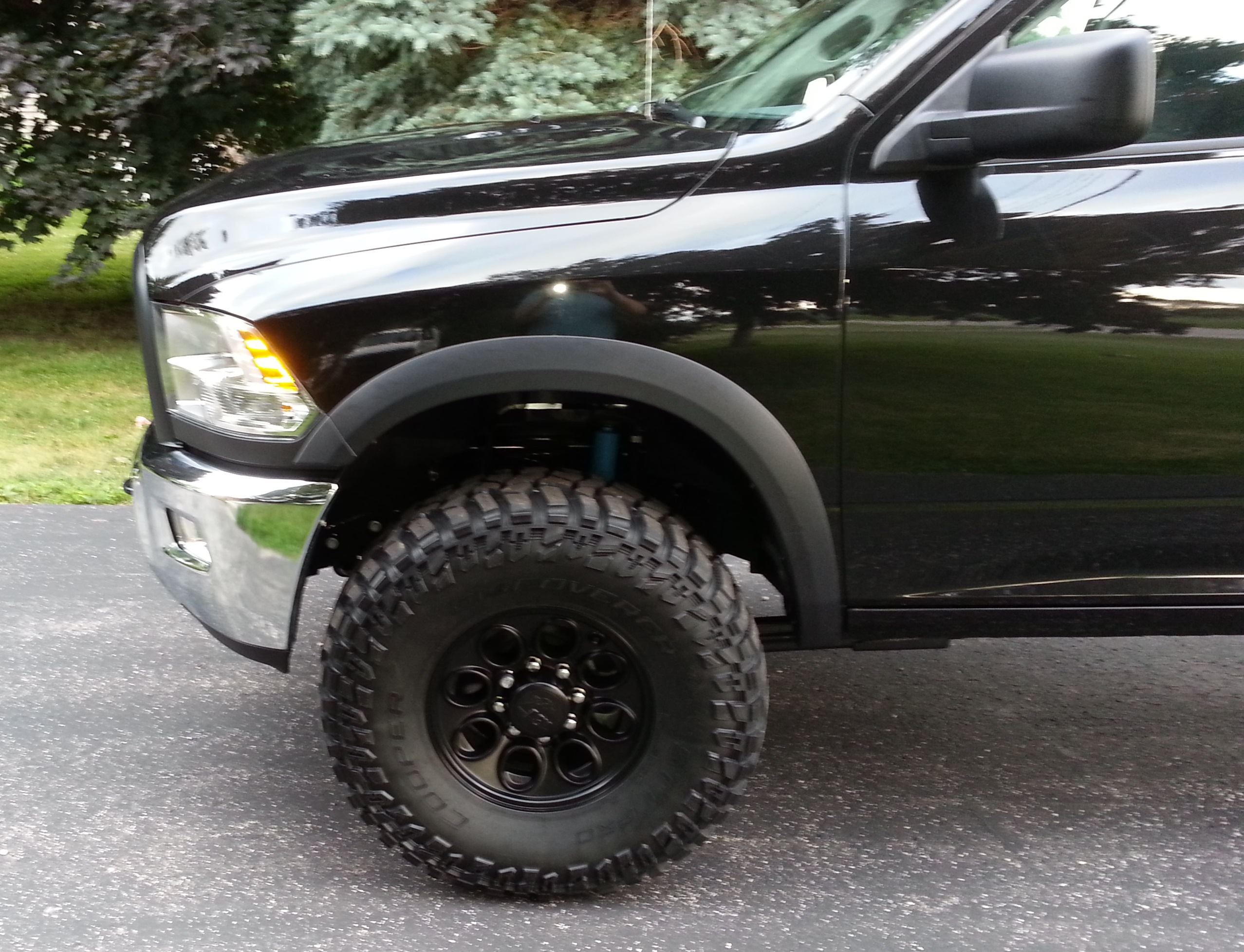

Here are 17x9's with 5.75" backspace on my '14 2500. With the 37" Toyo's they just barely rub the radius arm at full steering lock. I did have to trim the flares a little as well as do little work to the inner liner.

I'm not understanding those heat gun pics... Haha sorry but did you just heat the inner fender liner and push the ridge in?
Jack187
Posts: 150
Location: WI
Re: Aftermarket wheels for 2014+PW
Post by Jack187 » Wed Jul 15, 2015 9:23 pm
SnakeEyes wrote:I'm not understanding those heat gun pics... Haha sorry but did you just heat the inner fender liner and push the ridge in?
Pretty much. So in the picture, you will see a small channeled portion of the fender liner that runs from top to bottom, extending into the wheel well about 3/4"-1" more than the rest of the liner. It is on the outer portion of the wheel well liner. I am borrowing the heat gun pics from Skyd Ram because it makes it easy to see.
You only need to concentrate on the bottom 6-8 inches really. Once you do it, if you look at the fender from the side, you will no longer see that portion of the fender liner pushing forward towards the tire, but rather the wheel well will appear to be a smooth curve conforming to the fender flares and not protruding in on the tire. Trimming of the flare is also required, as it pushes forward at the very bottom.
You can mount a 37" inch tire without this, but it will likely hit the flare/liner when turning without this modification.

I think you would be fine with stockers, assuming you can get the 37" tire of your choice to fit the wheel. At full lock, you are going to have the same slight rubbing issue as all the rest of us 2014+ owners with any 37" I am afraid (unless you get a lift kit that accommodates for it). If the tires I wanted would have fit on a 17x8 stocker , I would have stuck with the stock wheels.
