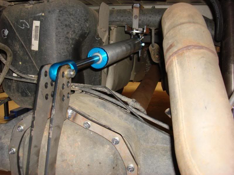

Can you post more pictures of the axle wrap prevention they incorporated into the 4th gen? Couple of different angles and such?

I just dont get that whole shock thing. A shock doesn't prevent axle wrap. You need solid links for that. Thats why you have upper and lower links on a coil suspension. Just doesn't make sense. And the axle disconnect up front, that just disgusts me there :-(

On the 3G The shocks are on opposite sides of the axle and a little off of the center axis, if you upgrade to 2.5" shock with better valve control it lets the shock help with the chatter/shudder in deep sand and soft snow. The upgraded shocks can and does help with the controlling the shudder caused by uncontrolled axle wrap. The axle is somewhat limited by the shock on how quickly is can twist and unload helping to smooth out the effects of axle wrap. It in no way limits axle wrap it only helps control its frequency/speed.
This same principle is being employed on the 4.5G with the shock in the center giving the shock more leverage on the axle to control it better. Much like a steering stabilizer/shock helps to control or even prevent death wobble.
Carli did the very same thing years ago with limited success when one considers the cost of the system with that shock. Here is a picture of their example.
