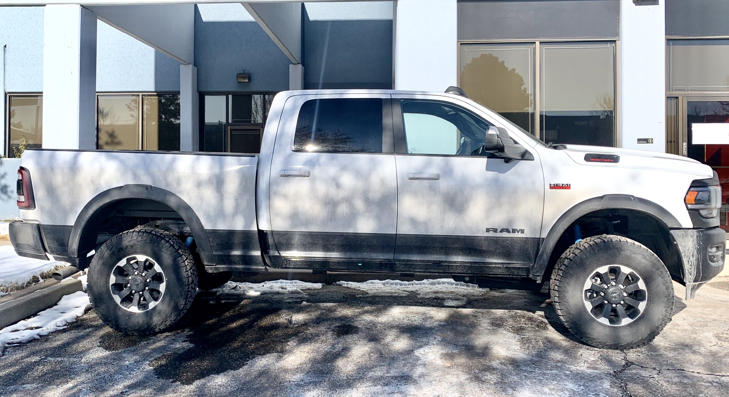

Re: 19 ram power wagon screaming bigger
Bigger tires? Hell yeah!
Bigger wheels? Hell no!
You won’t get much love for larger diameter wheels here. These things are off-road beasts and larger diameter wheels are more of a detriment off-road.
35x12.5R17 / 315/70R17 on stock wheels fit perfect, I’ve not noticed any rubbing turning or off-road. Photo of my 2019 on 315/70/17s attached.
I’ve heard 37s fit without any additional lift, but require some trimming, and you can’t fit a full size spare under the bed.
