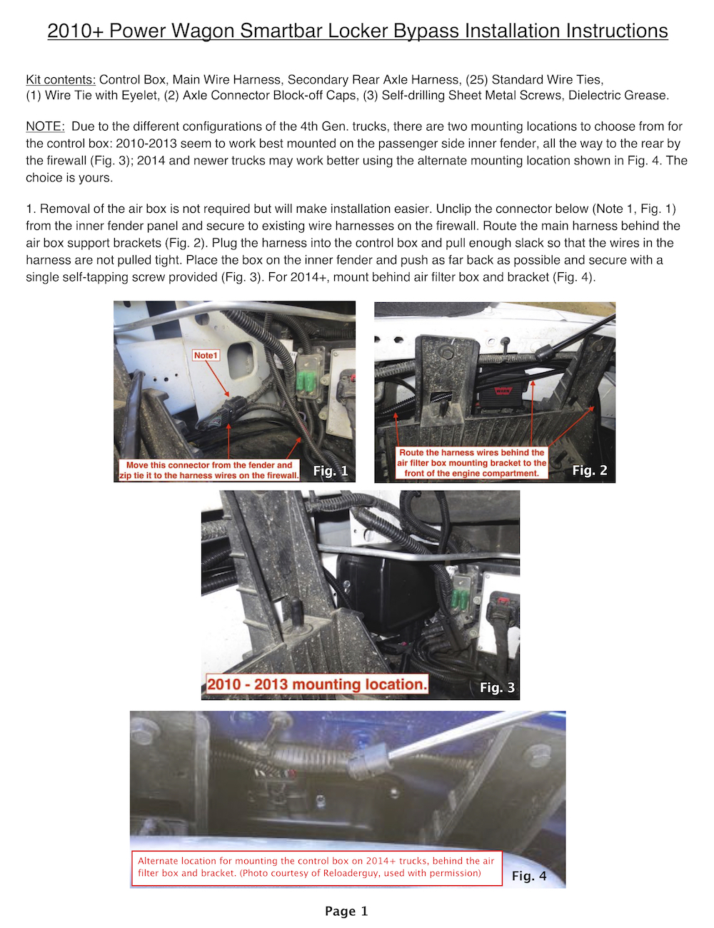

Installation instructions can get lost or misplaced, so I thought it would be good to post them here so everyone can access them. The only problem is that it's a PDF file and this forum doesn't support the PDF format, so I've converted each page to its own JPEG image to make this work. They do get a little grainy after converting and downsizing, so if you want better quality, shoot me an email.
Enjoy! :patriot:

Very easy install. It's nice to decouple the bar at will.
