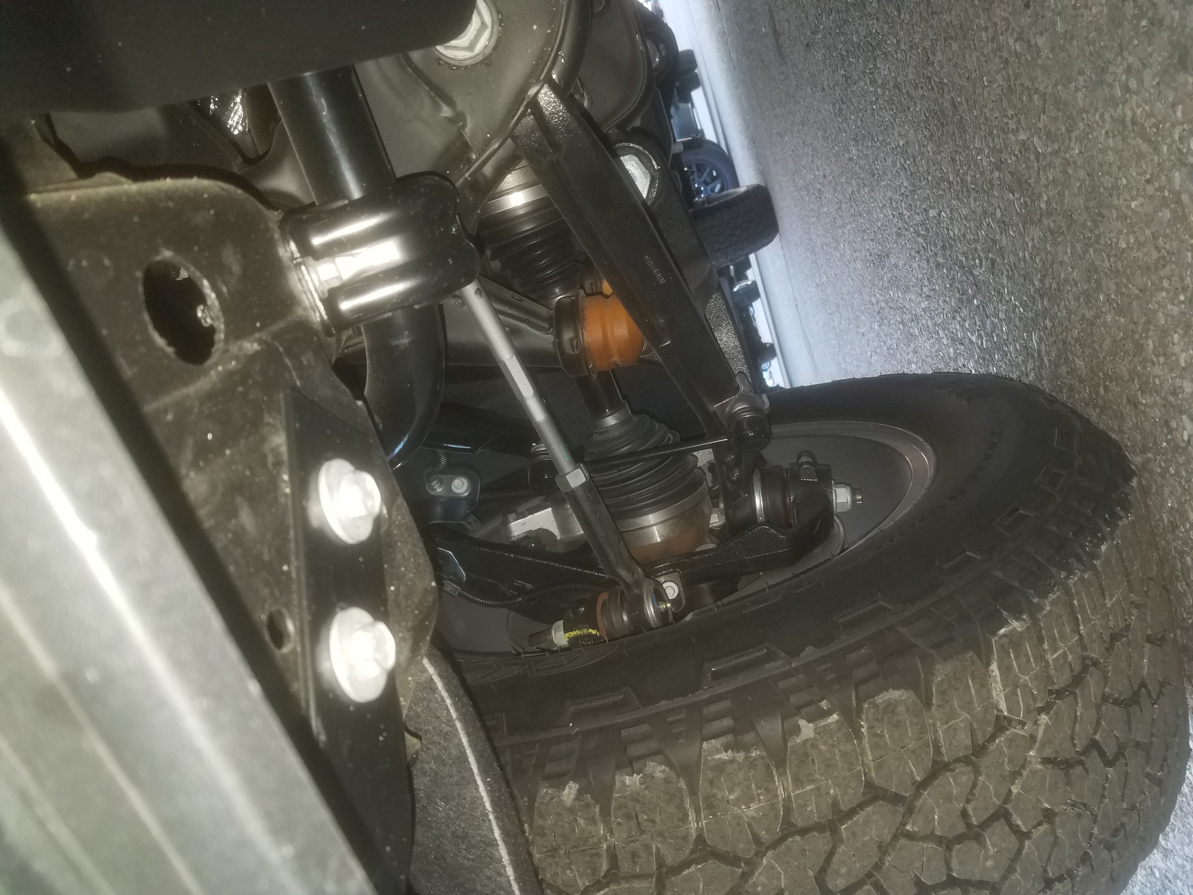

i dont know about anyone else but if it wasnt for gen4 wagons i wouldnt bother owning a full size truck. for entertainment i visited some local ford and chevy dealers ( when theyre closed of course so i dont get mistaken for a interested customer ), so i could have a look at the running gear. maybe its just me but the ram looks alot more beefy in all aspects. fords front linkages and joints look like something from the older 5k lb rated axles. kinda flimsy in appearance. chevy has what appeared to be aluminum front pumpkin and 1/2 ton sized ujoints and tie rods that are likely no bigger than the ones on my carolla and the under carriage ground clearance is shameful

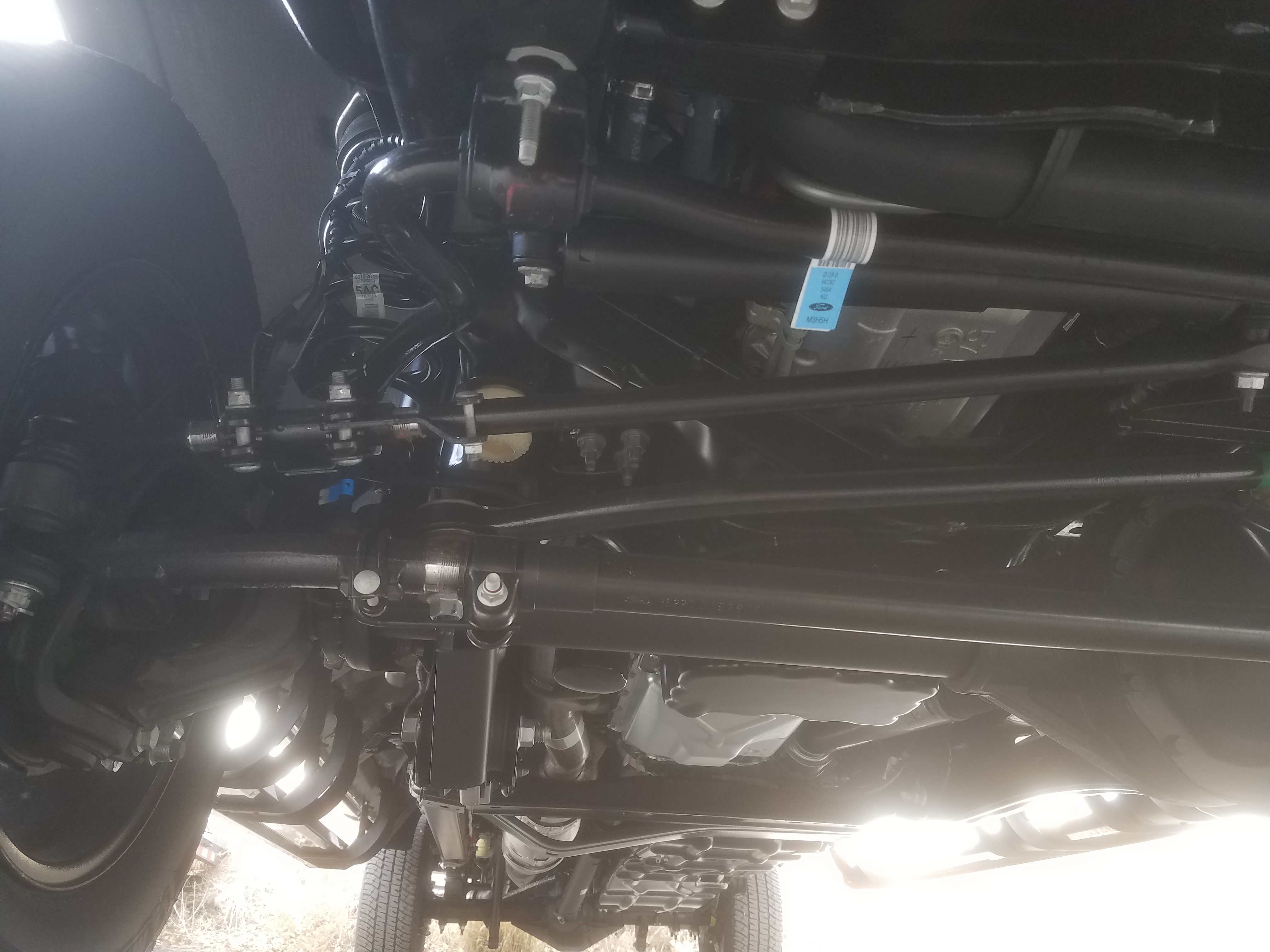

everyone talks about the d60 but im not all that impressed with what i seen. i guess the huge after market support must be nice but other wise ill stick with the electric cad aam. and fords using some wonky steering stabilizer setup that puts it clear up on the draglink near the pitman arm. brilliant :roll:

I've read where cheby 1/2T and 3/4T 4x4's use the same front running gear. The pumpkins, axles, etc. The only difference is in the wheel bolt pattern. 6 vs 8. I don't know how true that is.

i wouldnt be suprised. a guy at work broke the front ujoints on 2 never chevy gas trucks. back in the day when dodge was using d60 and 70 and 80 , chevy had little semi floating rear axles on the 8800gvw trucks

Everything is different on the front end between the GM 1/2 and 3/4 ton trucks, there is no carry over that I know of except for possibly the steering rack if anything.
As far as GM's front ends, if all you're doing is towing, using it as a stock height work truck, or otherwise driving it as it was intended, you won't beat it for handling, control, or comfort. They just don't handle abuse as well, or obviously perform off road well enough to compare to solid axle rigs. Since you can't go buy a new diesel truck with a stick anymore from any manufacturer, if I were to buy a tow pig, it would be a GM truck every day of the week.
Between Ford and Ram there is no comparison however. I dig the new Super Duty's but they do not have the same "overbuilt" mantra Ram seems to have.

Well what the heck is wrong with getting the steering stabilizer up and out of harms way? I think thats a great idea, as long as it still functions as it should.

if your trying to stabilize or dampen wheel movement, isnt the most effective location at the exact spot your stabilizing ? like what ram has done. not 2 feet away on the drag link. and if the lower drag link joint develops slop, the ss becomes even more less affective. rams is behind the tie rod. any frontal impact is likely to hit the tie rod first. in which you may have bigger problems to deal with
