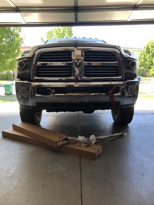

I’ve been shopping around trying to find out the best way to start my PW build. Armor? Suspension? Gadgets? I’ve got A.D.D. bad Tuning? After experiencing Death wobble I decided to start with Synergy MFG’s HD steering kit and track bar. Holy shoot dang. I have a brand new truck the steering is spot on!
Now as far as coils is there any feedback on the Thuren XS coils actual lift height?
Is there any difference between FOX and KING shocks 2.0 shocks?
