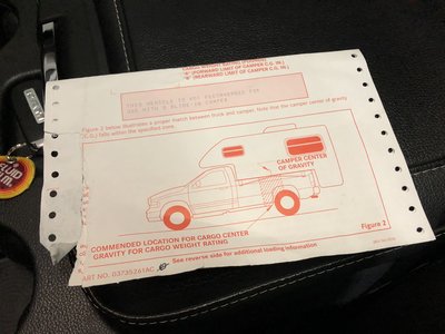

I am looking to add a Four Wheel Camper Hawk to the bed of my truck for an upcoming trip. It weighs right at 1000lbs. Has anyone run that kind of payload with the factory rear suspension setup and if so how badly did it sag? I am wondering if I should bother with the Airlift bag setup for a payload capacity well within the factory limits or will that kind of weight compress the rear substantially? I know the benefits of airbags for towing, but would it beneficial for that kind of payload as well?
Also, where have you all found to have the best price to buy the Airlift bags and Daystar cradles?
I would definitely consider bags with that setup. Not only is that a good amount of weight, but its all up high. I would guess it would end up feeling very rocky side to side without bags.
Theres a reason there is a sticker on the glove box of the truck when you buy it that states to not put a camper in the bed of a power wagon.
I have never even sat in the passenger seat of the truck lol. I am pretty sure that sticker was already removed when we took delivery of the truck but who knows. I'll install the bags and see how it goes. Thanks for the reply!
Well, to correct myself it may not have been an actual sticker. Cant really remember for sure. It may have been a piece of paper that was somewhat stuck to the inside of the glove box....
Maybe give it a try without bags and see. I bet it will by very rocky and unstable feeling, though.

Just went out and looked in the glovebox and found it. Notice the verbiage in the rectangle above the truck...

Interesting, I don't recall seeing that paper. I know your traditional slide-in usually has the overhang which leads to more weight to the rear and outboard of the bed and changes the COG of the camper itself. The FWC lacks that area and it's retained within the bed entirely. Being that it is a pop-top it has very little weight above the roof line of the cab as well. I am more concerned with the rear squatting due to the load than I am with how it performs in corners and at speed. Those things matter as well, but I am simply curious as to whether or not 1000lbs will make the truck squat.

As long as your truck isnt leveled, it should be close. Probably a little low out back.

It's closer to level than stock, I have Thuren 1.5" coils up front but there is still a slight rake, maybe 3/4" higher in the rear.

Yea, it will definitely be sagging ass then.
