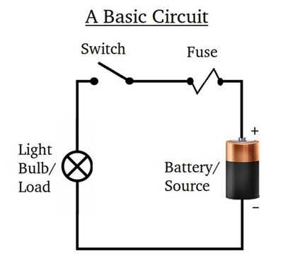

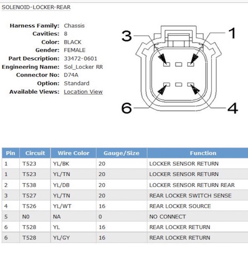

As far as the locker actuators are concerned:
  • "Source" means +12 Volt or power
  • "Return" means -12 Volt or ground
Pin #4 would be +12 volt coming from the SmartBar to the locker and Pin #6 would be -12 volt coming from the SmartBar.
On this image that I posted earlier, pins C & D would be +12 volt/power being sent from the SmartBar to the locker actuators and pins G & H would be -12 volt/ground being sent from the SmartBar to the locker actuators.
I know that technically electricity is always looking for the path of least resistance to ground and circuits are usually viewed as being a loop, so + is the source of power being sent out and - is the return path to the ground that the electrons are looking for.
In this image, substitute the word "Locker" for "Light Bulb/Load".
That's my best attempt at explaining why they use the terms "Source" and "Return". :patriot:

So which is the locker power out from the smartbar?
Posts: 858
Location: San Clemente, Ca.
Re: Hardwired Lockers with OEM Knob
Post by Retired BLM Rig » Sun Apr 22, 2018 9:48 pm
Reloaderguy wrote:
Sun Apr 22, 2018 9:19 pm
Pin C is power going out to the front locker.
Pin D is power going out to the rear locker.
