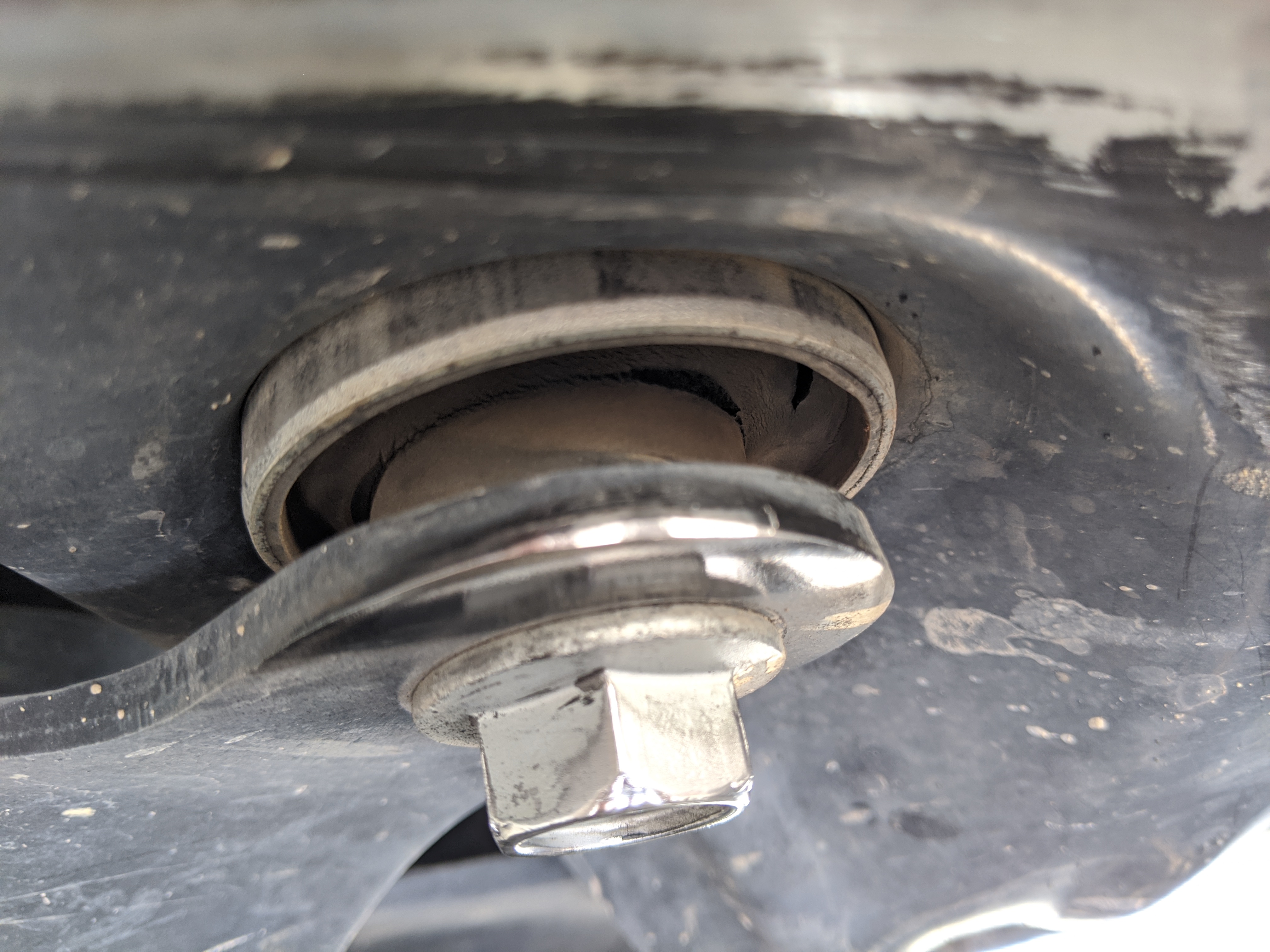

I also have a cracked/split/deteriorating bushing on my driver radius arm. All the rest of the bushings on the both radius arms look fine.

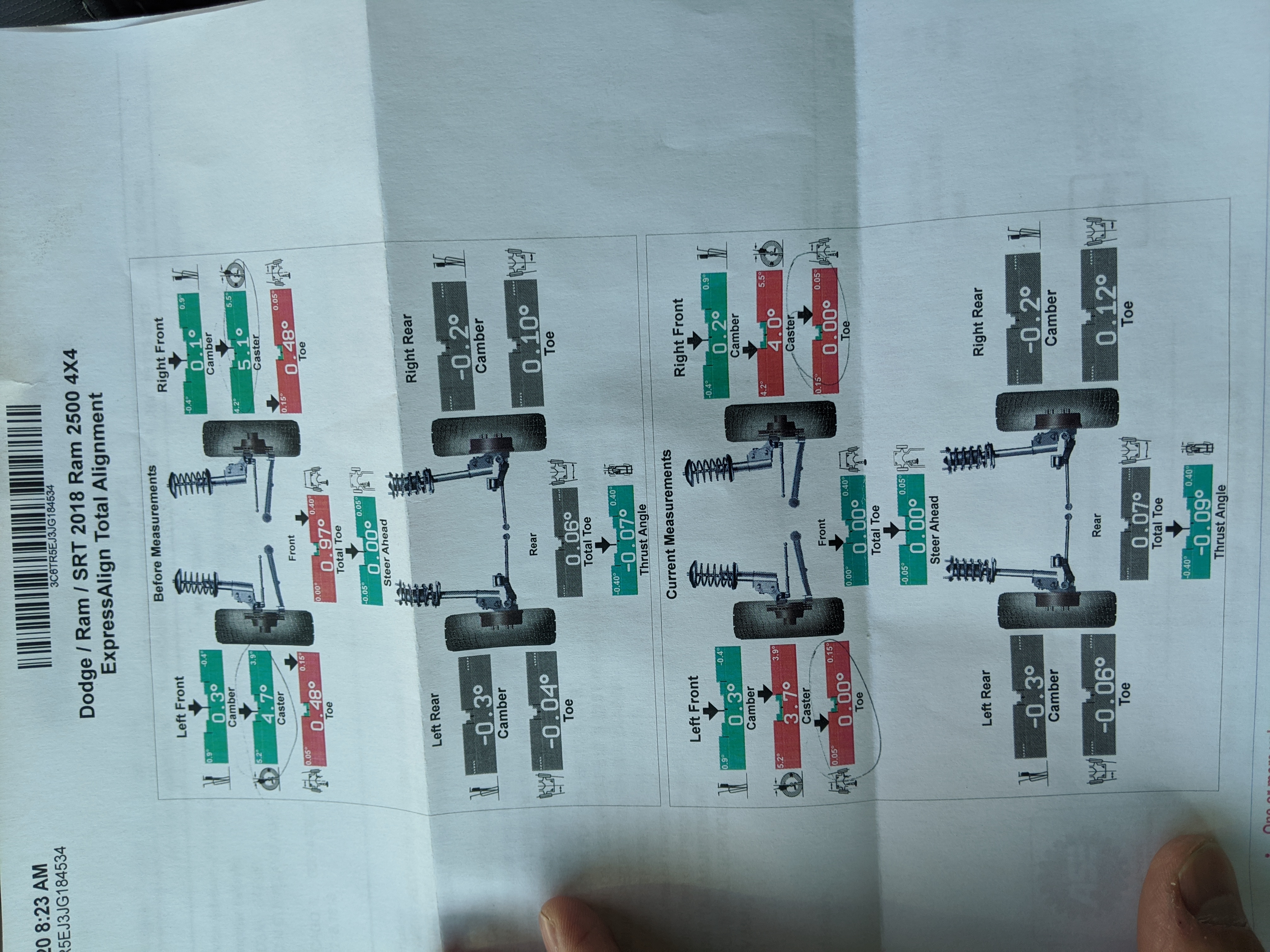

Installed the Thuren front track bar, got an alignment to Thuren specs and removed the front centrimatics.
I checked my ball joints and tie rod ends, everything is tight. Had them double checked by Firestone (I know I know) and they confirmed, no issues or worn parts.
My radius arm bushings are still suspect because of that slight tear but I'll run them for now.

Re: 2018 Death Wobble - Buy Once Cry Once
Leaving the steering stabilizer off is an accelerated way to test DW, but if it’s already on then no need to remove it. I’d like to know if everything goes well now, or not.
Alignment numbers look very good to me!

Mine look like that, David (not on this site) had his even more destroyed and no Death Wobble. I'd be surprised if that is your source.EasyDoesIt wrote: ↑Sat Jan 25, 2020 3:50 pmReloader, I've thought about the centrimatics too but it's not low speeds where I get DW, it's above 65. I don't get any strange vibrations at low speeds.

That's good to hear because I wasn't looking forward to replacing those bushings. Another 100 miles on the truck and no signs of death wobble.OffroadTreks wrote: ↑Sun Feb 23, 2020 11:51 amMine look like that, David (not on this site) had his even more destroyed and no Death Wobble. I'd be surprised if that is your source.EasyDoesIt wrote: ↑Sat Jan 25, 2020 3:50 pmReloader, I've thought about the centrimatics too but it's not low speeds where I get DW, it's above 65. I don't get any strange vibrations at low speeds.
