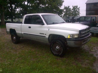

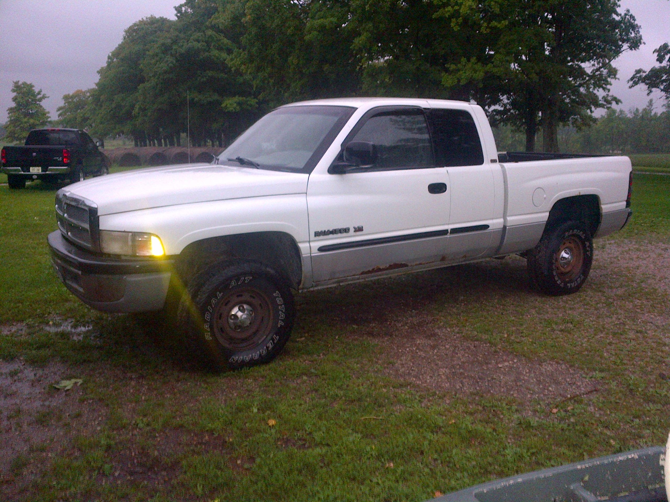

Have officially started my next build. I've been planning to build up a diesel truck for a few years now just as a fun DD and farm truck. I've always wanted a diesel for what I do, but I can't afford (justify) a decent one without selling one of my toys (most likely the PW) so my next best option is to build what I want. A good friend of mine had this old truck that he had bought a few years ago and I worked for him the past couple days on my holidays, and he gave the truck to me as payment. Not bad for a couple days work, considering the motor is worth $1500. It is a '98 2500, 24V. The body is absolutely rotted away but the rest of the truck is in pretty good shape and it only has 165k miles on it so the motor is in very good shape. I know the trans needs rebuilt and I'm sure there is much more that I will have to upgrade. For the body I have bought another truck (2001 1/2 ton) that the body is rust free that I will put on this chassis once I get it prepped. No plans for power mods yet besides a programmer, but I can't leave anything alone

Ooooooooooooo... Extended cab short bed diesel 2nd gen. Near the top of my list for best looking truck. I'll be watching!

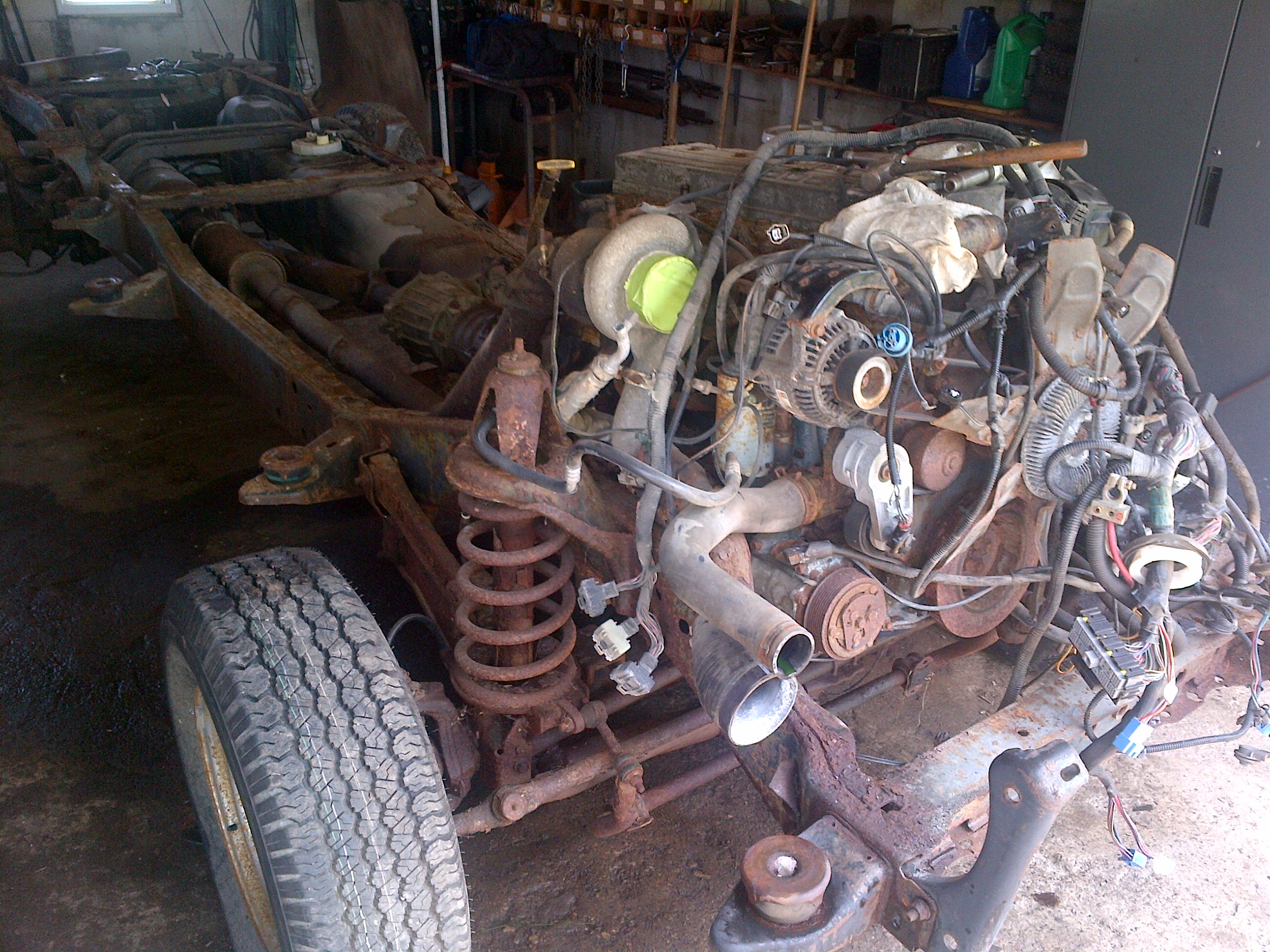

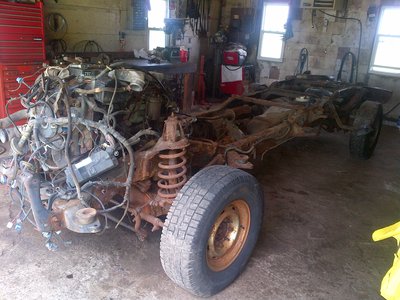

Got the motor fired up finally and it runs nice with no smoke or oil leaks. Now have the truck tore down to a rolling chassis so I can build up the chassis and drivetrain before I put the other body on it. As bad as the truck looks I have got every bolt out so far without having issues except the 2 lower inner fender bolts. Frame is rusty/scaly but not rotten at all. Looks like I can save it.

Sorry I haven't been keeping this build updated, but I've gotten a little further on this build. No pictures unfortunately but I will try to get some this weekend when at my farm to work on it. I finished stripping the frame down to a rolling chassis and started to pound some of the rust off it. I used a needle scaler, 4" wire brush cup, and good old 2lb hammer and all told I took off ~4 - 5gal pails of rust off the frame, and ~1/2 a pail off the motor. Everything was extremely crusty from being a plow truck but fortunately almost every bolt came out without breaking off, and once I got the rust beat off, the frame and motor are in really good shape. Now the chassis and motor are painted and everything is almost ready to start assembling again. I think I have almost all the parts/upgrades I want to do to this truck off the get go now here (or soon to be here) so it's getting close. Next I have to get my donor body at my place and start stripping it for paint and the transplant. I'm still torn to what colour to paint it, but I'm leaning towards going a really dark purple. I know some of you will think well that's gay, but I'm pretty sure I can pull it off and have the truck look good. Plus how often do you see a purple truck? And I'm all about being different.
