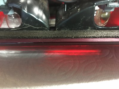

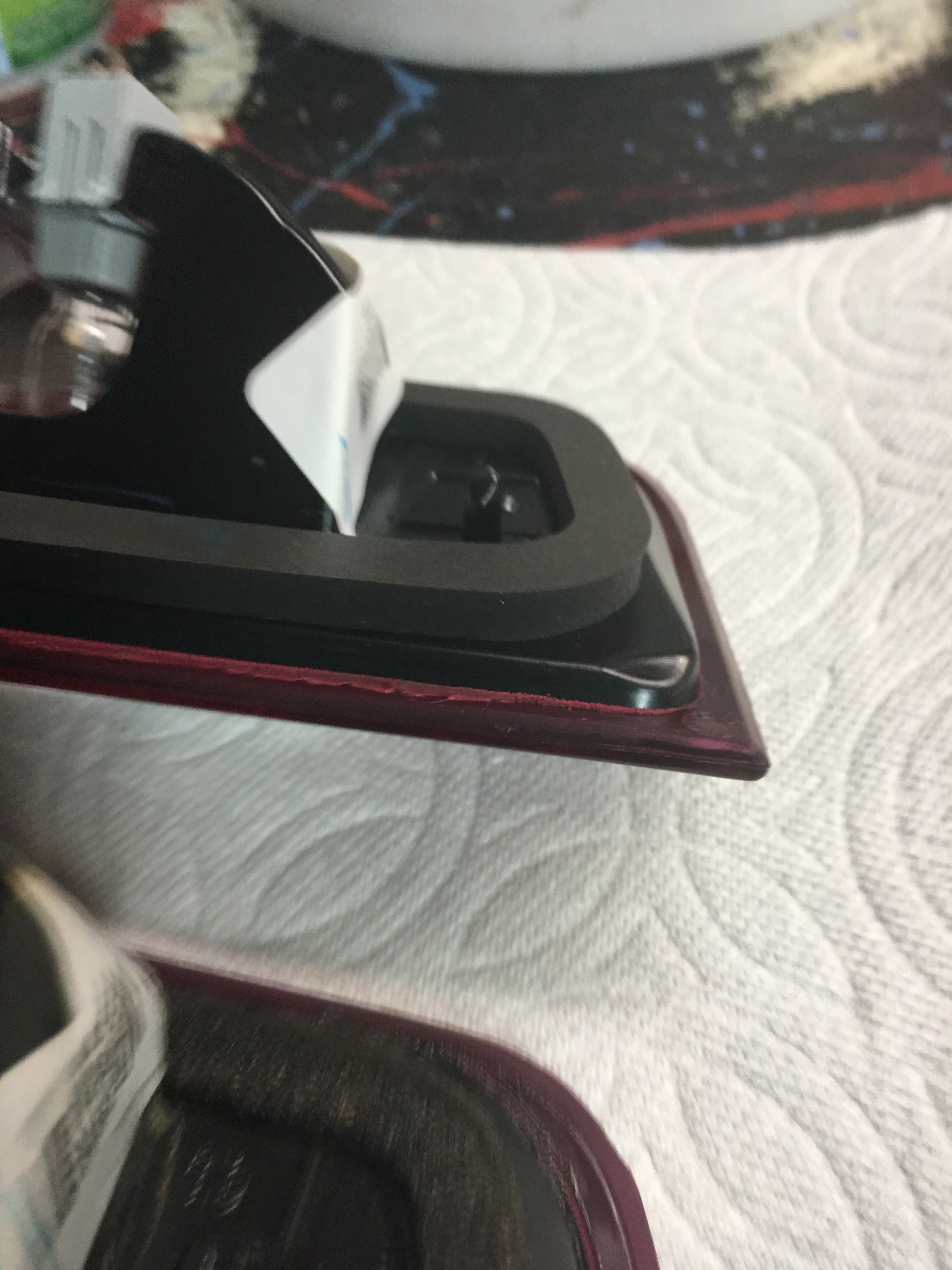

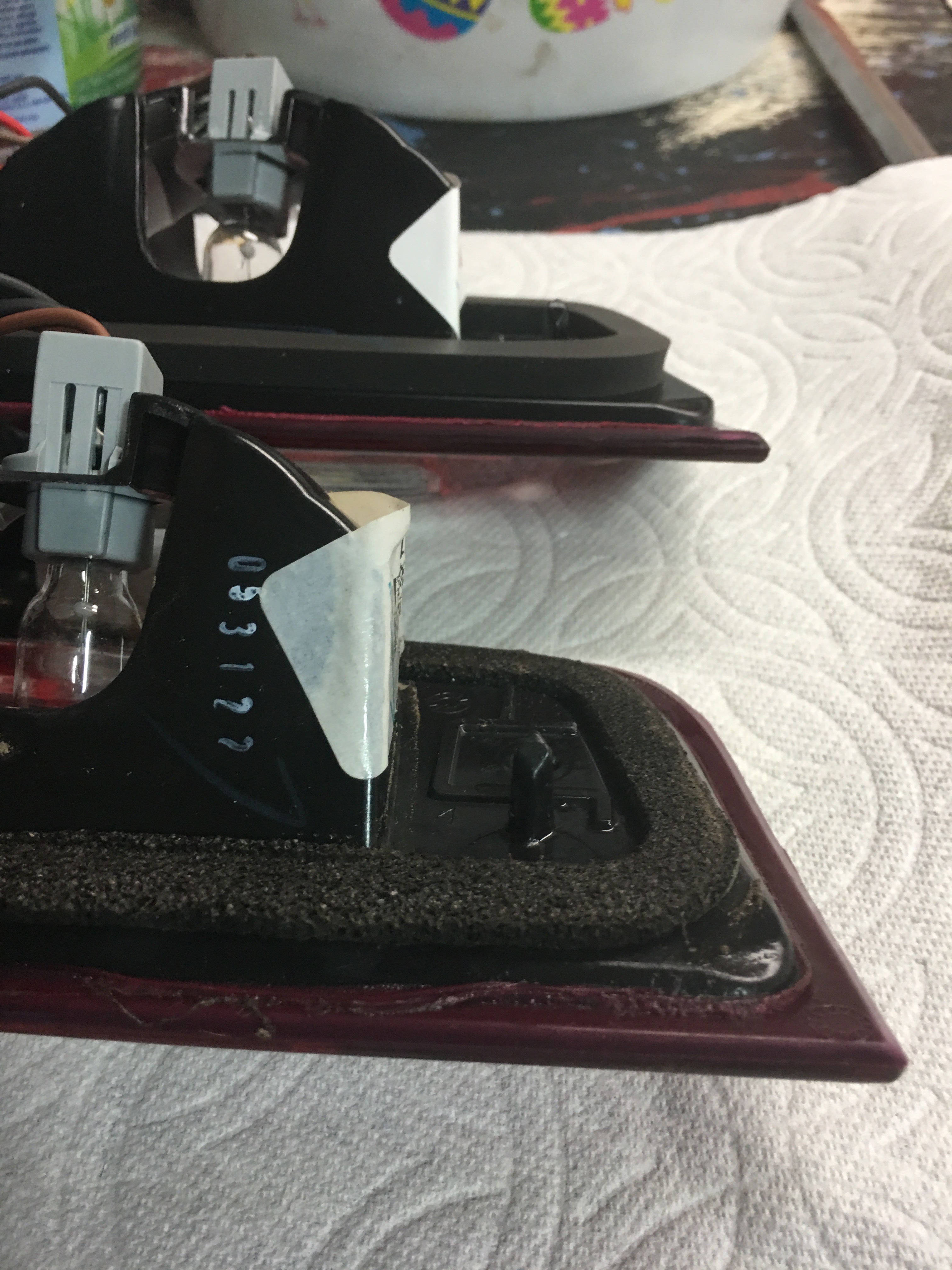

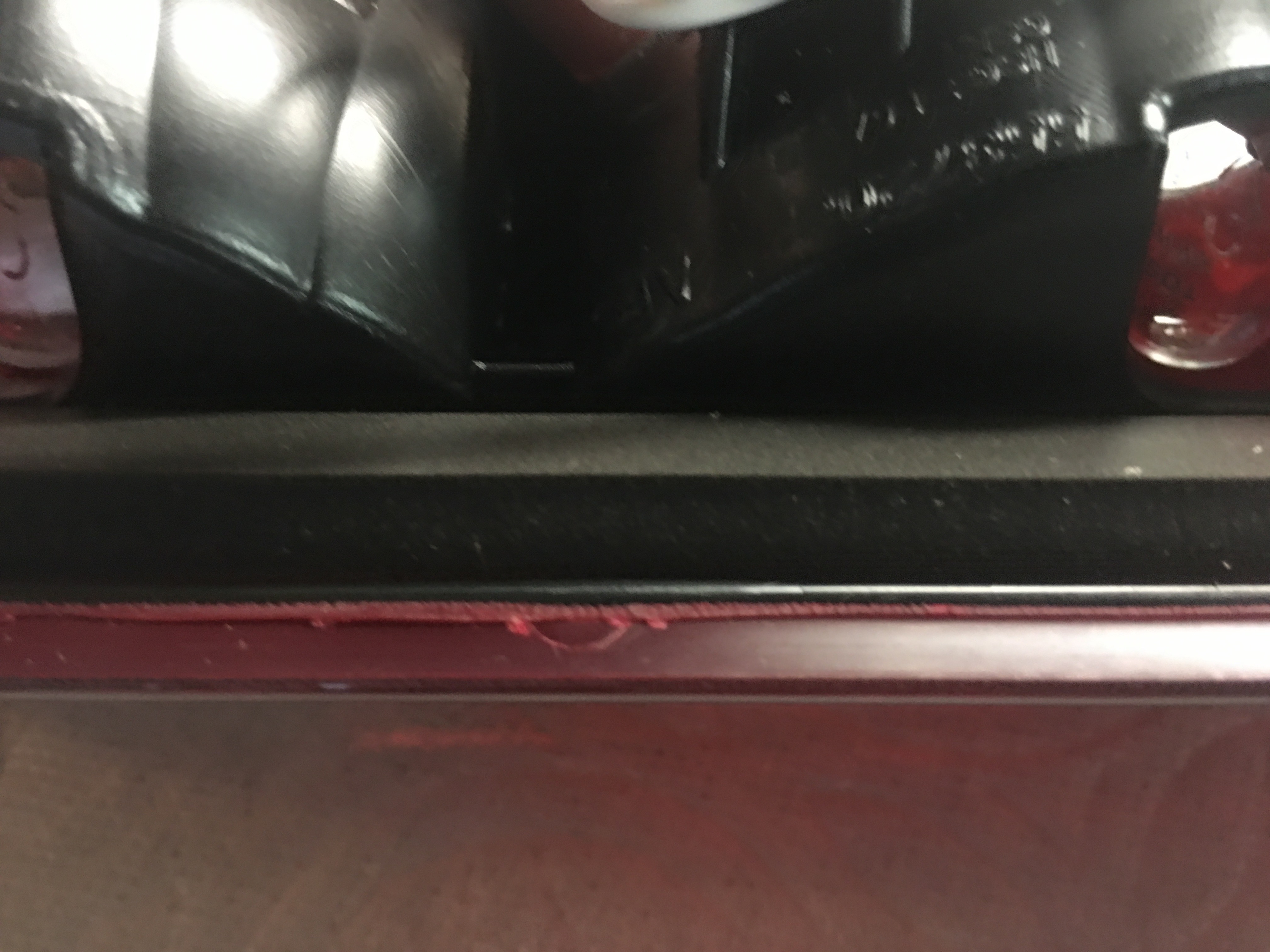

Very heavy rain in SoCal.. my 3rd brake light leaked on my 2012 PW and I had about 2 inches under the rear seats in the storage compartments. Replaced the lens with the newest version from the dealer.. the seal has been improved from what appears to be open cell foam to close cell EDPM. This much better than using silicone or trying to glue seal to lens. Cost of replacement was $23 dollars from dealer...
