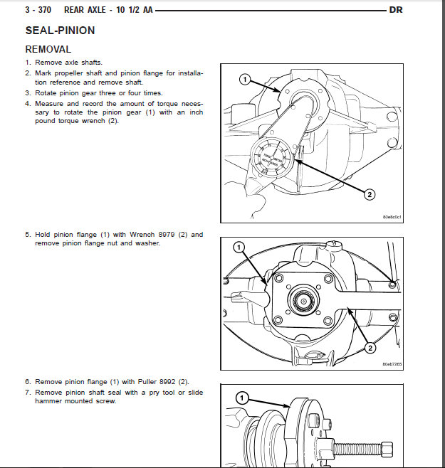

Hmmm...I would go look in my Haynes manual for the specs but it's a moldy mess from leaving it in the bed of the truck Does anyone have the factory torque specs from a service manual if I was to re-use the old crush sleeve?
2006 QC PW G56
Re: Rear Pinion Seal Leaking...
If you have a good dealer, they will be able to tell you both specs.
- Posts: 429
You da man Cruz! Thanks!cruz wrote:From FSM...
I've never done this type of repair, but I'm thinking by removing the axles there is no load/resistance on the ring and pinion giving you a more accurate measurement.
- Posts: 429
I don't want to, but I'm gonna remove the axles so I can get a 100% accurate pinion torque reading. Friend has a 2 post lift that I'll be using to make the seal swap easier.
