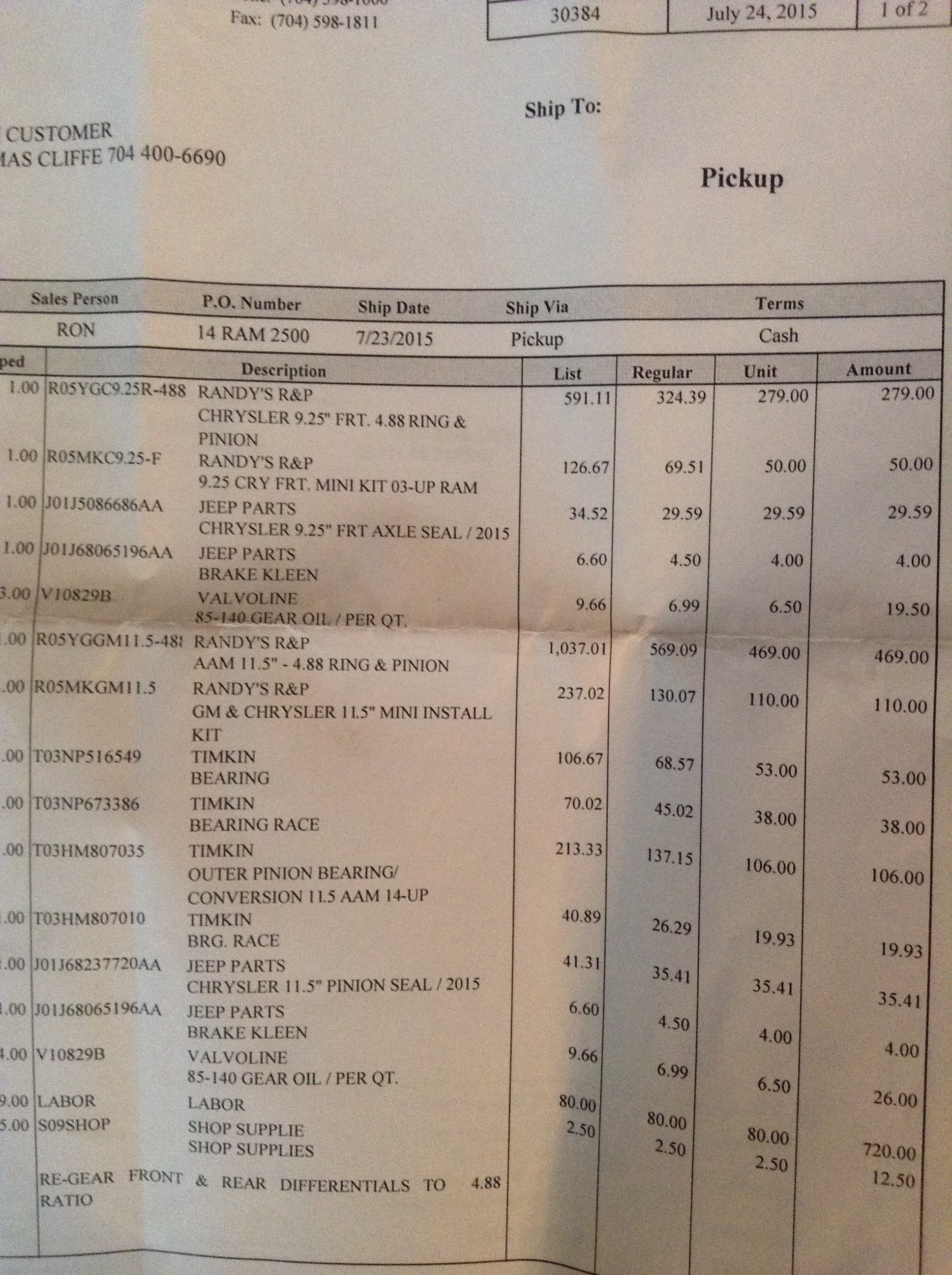

usmc369 wrote:
Fri Mar 16, 2018 7:19 pm
East Coast gear supply supplied my AAM 4.88 Rear 3 years ago. I posted my receipt if you search with every part number that will be required including that newer seal that these rear axles require.
Complete Gear change kit PN# NG-GPRAM-4.88
Kit included the following;
Nitro 4,88 R&P Rear PN# AAM 11.5-488-NG
Nitro 4.88 R&P Front PN# GM 9.25-488R-NG
Nitro Master install Kit Rear PN# MKAAM11.8-B
(Note this kit will include the conversion bearing required to run the aftermarket gears in the new housings)
Nitro Master install kit Front PN# MKAAM9.25
The bearing install kits included new crush sleeves, pinion shims and pinion nuts as well as gear marking compound/brush and a small pouch of assembly lube
Alternate options for the bearings from Yukon Gear are as follows, both of these kits contain the conversion bearing also;
Master install kit Rear PN# YK AAM 11.5-CONV (Complete bearing and seal kit for the 14+ housings)
Pinion only bearing kit Rear PN# PK AAM 11.5_CONV
(Pinion seal and inner/outer bearings only)
If you want to buy the front conversion bearing by itself the Timken part numbers are;
Bearing HM807035
Race/cup HM807010
Misc fluids/chemicals
8 qts of synthetic gear oil. (I chose Royal Purple) Book says 7.2 qts to fully service both differentials.
Brake clean for cleaning the housing and part and to remove the shipping/storage coating (cosmoline) from the new gears.
A good quality silicone sealant for the axle shafts when reassembling. (A thin layer is sufficient to allow the original gaskets to seal) If gaskets tear or are in bad shape replace them.
White Lithium Grease
