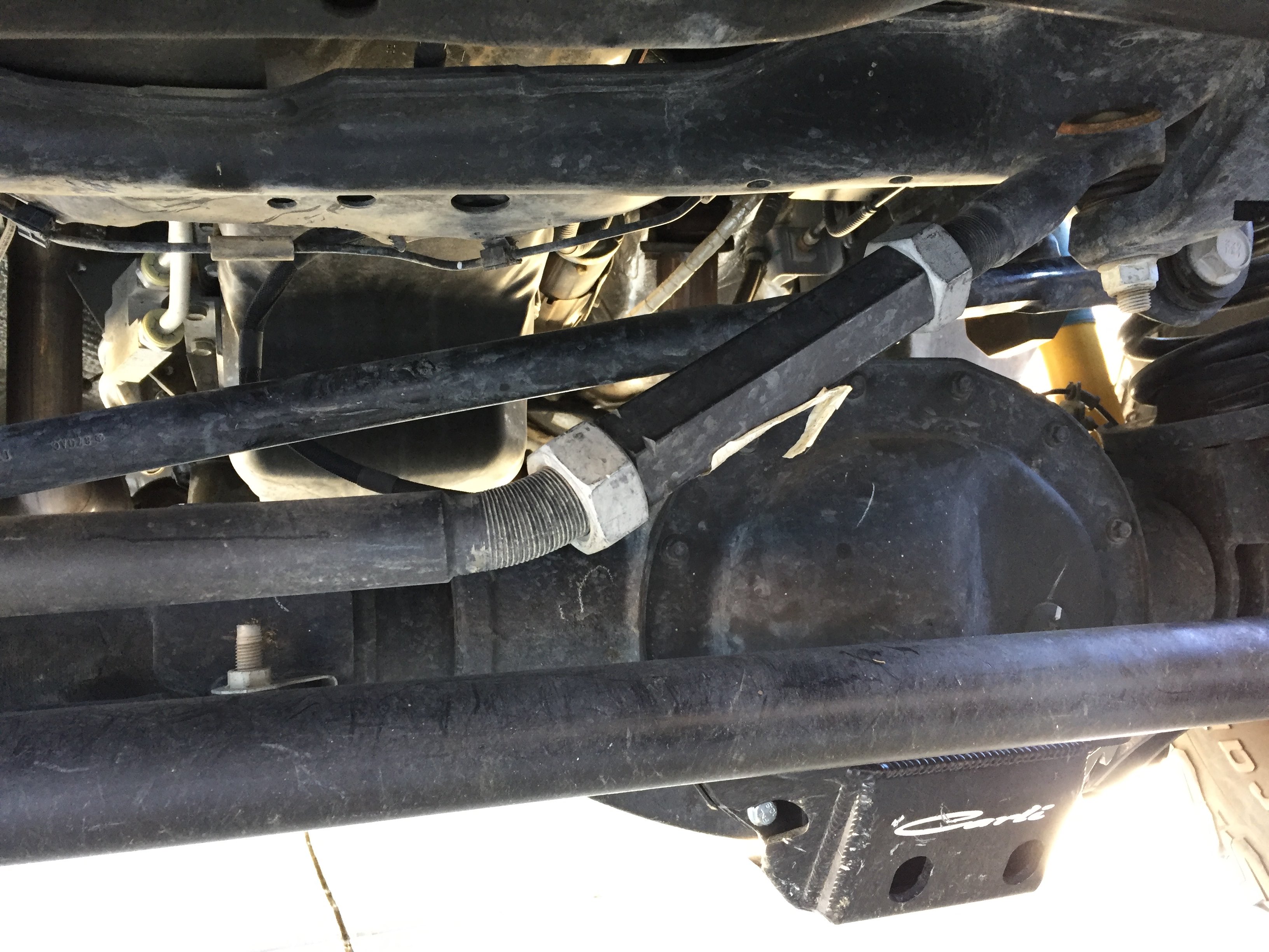

Yesterday morning in my '16 while exploring some awesome ghost towns by Essex, I hit one of those iceberg-type rocks that probably makes up the majority of our planet (yes, it had gravitational pull). :doh: Was in 4-low, unlocked, making a right turn in a tight spot and thought it would clear, but smacked into this thing at a violent 3mph. It pulled the driver's side tire to the left, which in turn bent my drag link enough to turn the steering wheel 90 degrees. I was surprised at how easy the link bent, but it was a pretty abrupt stop. I checked everything out, and so far I've found nothing but the link damaged. Actually amazed that it didn't break, after seeing pictures of others on the internet. I have a DOR steering brace that likely saved my box, but was concerned the impact may have damaged ball joints or suspension arms. So far, everything else drives straight and functions normally.
However, after driving a few miles from the scene of the crime, I got a "Service Electronic Braking System" warning on the EVIC. No stored message, but a traction light illuminated on the dash. I checked the wheel speed sensor wires and plugs, checked ABS fuses, everything seems okay. Does anyone know if the computer senses similar wheel speeds while the steering wheel is turned for a while, it will throw this warning out? In other words, when I get a new drag link put on and the steering wheel straightened out, will this clear itself after a few miles?
Which brings me to my next question, has anyone tried the DOR 5th Gen Steering Linkage kit? Options are pretty limited on upgraded steering for this generation, and the stealership wants $750 just for a new drag link. I'm concerned I may have damaged the tie rod as well, though it looks okay, so I figured I might as well do that too. However, DOR is telling me the kits are at least 2 weeks out, maybe more, and I'd like to get this thing running ASAP. I tried calling Thuren and Synergy to see if they've got anything available, but was only able to leave a message.
Any thoughts or suggestions?

You bent your drag link, and not your tie rod? That’s an odd one. Bending the drag link has no affect on alignment but could trip your ABS warning due to the steering wheel position sensor seeing that you keep driving at an angle. Sending you a PM.

Thanks for the response. Yup, bent at the threads right before the adjustment collar, on the wheel side. I had a feeling the computer would flip with the steering wheel crooked. It triggered the warning after I got back in to 2HI and picked up some speed, which I believe is when most of these sensors start registering errors. Hopefully it will go away when the new link is put on.

Yes, the light is caused simply by the steering wheel being not straight up and down. I remember the jk’s being very susceptible to this also.

Post by Chromolykid » Fri Feb 16, 2018 4:11 pm

Post by olyelr » Fri Feb 16, 2018 4:37 pm
:shock: jeeeezuz
Posts: 2409
Re: Bent Drag Link/ABS System Error
Post by OffroadTreks » Fri Feb 16, 2018 4:54 pm
HOLY BONKERS! That's a heck of a bend!
Posts: 2193
Post by Reloaderguy » Fri Feb 16, 2018 5:02 pm
Not sure but I think I can see the problem.

Custom bent for lower center of gravity? This had to have done other damage and I’m just not seeing it. I’m anticipating joints will go bad on this side first, just a wild guess.

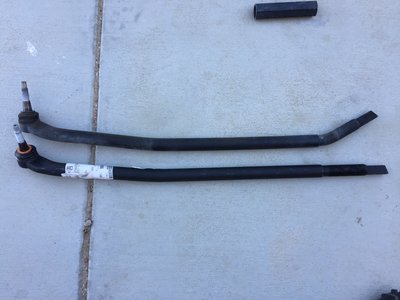

Ordered a new OEM center link outer online, saved $150 from dealership pricing. DOR said they were waiting on materials, 2 week minimum, too long to get this thing up and running. I’ll stick with factory for now since it seems very rare to do what I did, lucky me, but may upgrade in the future.

Replaced the outer half of the drag link today, everything else seems okay and the truck handles fine. ABS error reset itself after about a mile of highway speeds.
