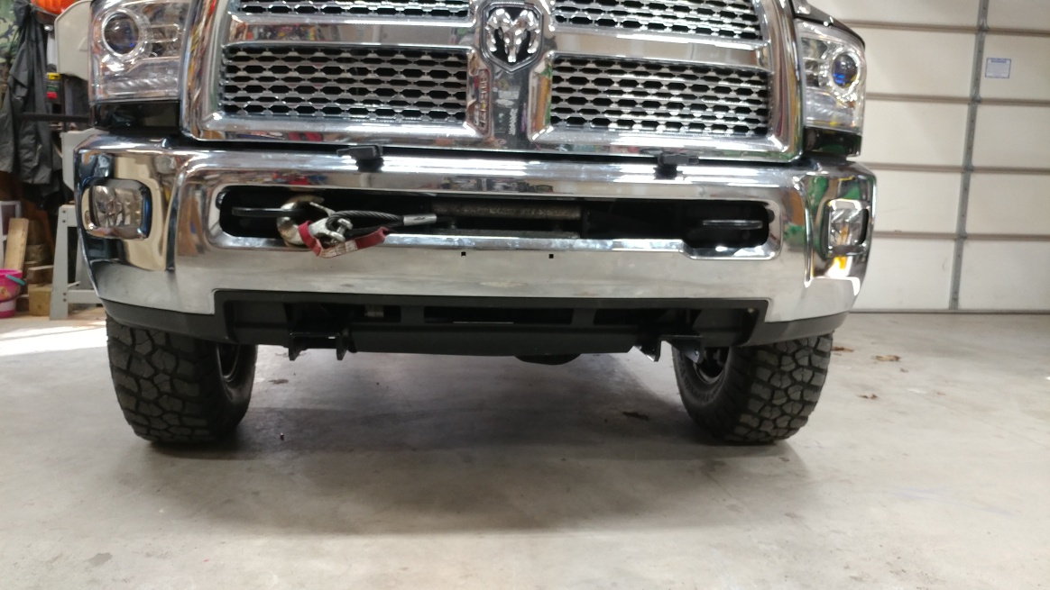

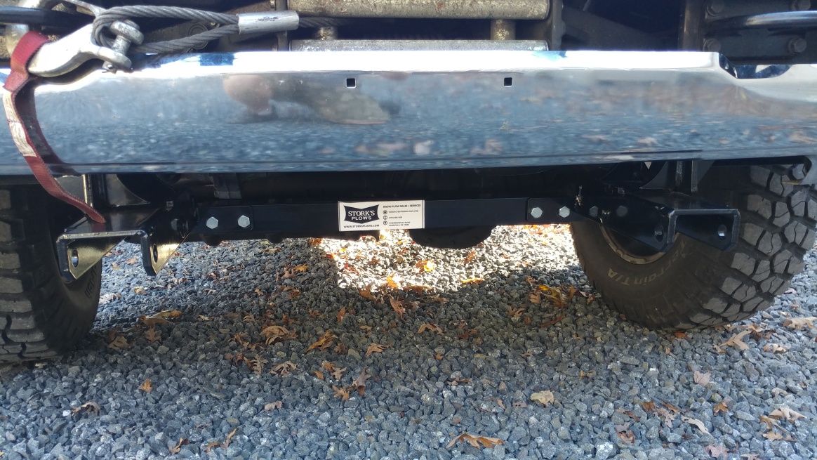

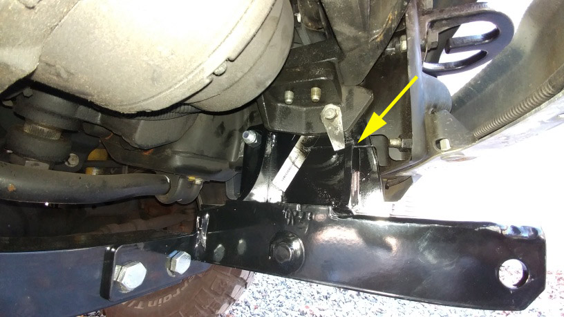

Just in case anyone wanted to see how its mounted with no winch removal. 2013 PW, 8.5' Western ProPlus with the Ultramount II system. I don't see any modifications other then cutting half of the ears off each of the Western brackets (pictured with yellow arrows). It looks like they may use a new cast part for the winch mount?

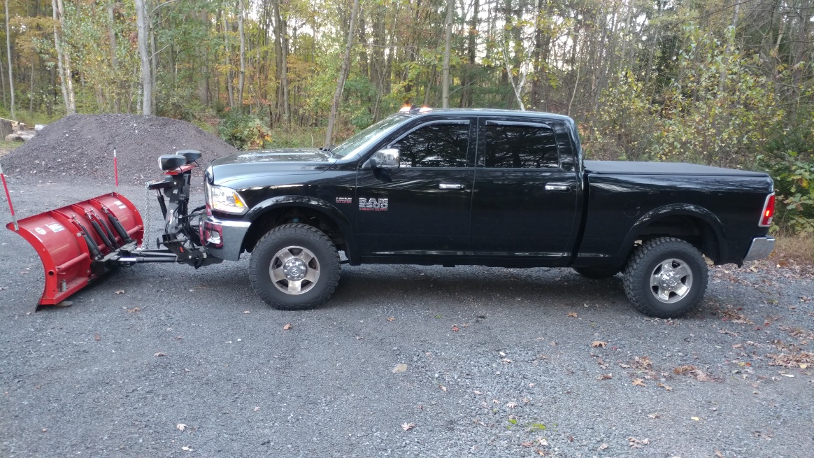

Some pics with the plow on.

Put the air dam back on..

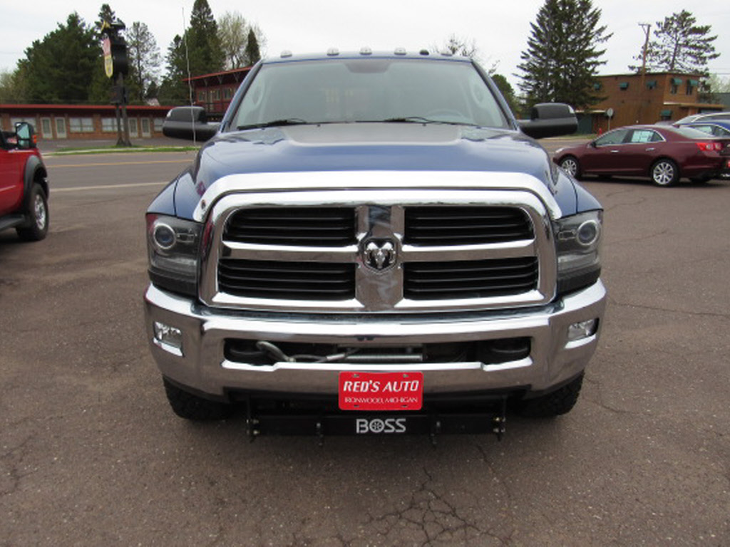

Here is a few photos of a Boss plow "undercarriage" on a newer PW, this was for sale last year & I never saw it in person - photos from dealer website. The Boss setup appears to hang down a lot farther than bones' Western mount.

bones
Posts: 189
Location: NE PA
Re: Western Ultramount II 8.5 on '13 PW
Post by bones » Thu Jan 11, 2018 10:07 am
Definitely appears way lower in those photos, you can see how far below the air dam it is. The good thing with the Western is that it has removable receivers (not pictured on my photos). With those receivers in, it is probably a bit lower, but no need to have them in when not plowing.

13BlkPowerWagon
Posts: 94
Post by 13BlkPowerWagon » Thu Jan 11, 2018 10:08 am
Yeah, the Boss' usually do, but the main frame is just 8 bolts that are easily accessible to remove, then you're just left with the ears that bolt to the frame that hang down, so it's not as bad.
