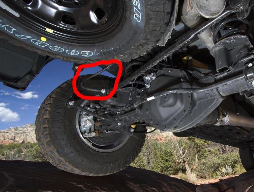

The rear axle vent comes off the driver's side of the axle and is zip tied to the frame crossmember. I added on to this line the same as I did for the front. Ran the end of the line up behind the driver side tail light. I drilled a small hole through the sheet metal behind the tail light so I could zip tie the vent in place.

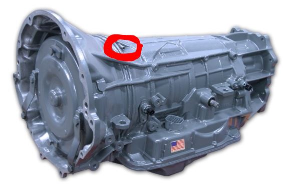

The transmission vent comes out the driver side near the top, right behind the bell housing. The factory line is only an inch or two long and has a different style cap than the axles and T-case. I pulled this line off and replaced it with 3/8" fuel hose and routed it into the engine compartment the same as the T-case. The factory cap fit into the 3/8" fuel line.
