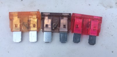

Alright update on the abs. The computer sends a amp burst through the 40amp fuse to test it. It's a brief second. The burst is on average 6.3 to 6.8 amps. Then the draw drops below what I can read. My multimeter nomaly has a 10amp fuse but I replaced it with a 5 amp. So my theroy still is that after the test the computer just needs to see a connection. I had the wife push the brakes too and the amperage never came up. It should only come up when the pump kicks in. And if the pump loses power it does not affect the brakes and do weird stuff. It defaults to closed state which is what it rests in. Mechanical spring return. So in essence by tripping the fuse the instant it draws power will disable the pump and throw the abs light. Restart the truck and a circuit breaker should reset and give the computer an 'all good" signal and no light. Here's a quick vid. I'm going to make this work today and go for a drive.

Unfortunately I only have a 20amp circuit breaker so I'm going to use a 5amp fuse to test this out. See if the fuse pops and what happens

Post by nts007 » Wed Jan 18, 2017 2:27 pm
I got it boys!! Test one two and three all popped fuses. Test 1 was a 5amp. Key on it popped. Test 2 was a 7.5amp. Key on it popped. Test 3 was a 10amp. Key on it popped. Then 15amp... Key on. No problem. Alright took it for a drive. Hammered brakes on the driveway. Abs kicked on for about a second then it popped the fuse and I got full braking power. Love it!! I tried my 20amp circuit breaker but it wouldn't trip like the 15 amp fuse. I am going to buy a 10amp and 15 amp breaker and try those when I get to the city. But there is the magic number. Here is a vid of my 3rd test with the 15amp fuse

5amp 7.5amp 10amp fail
