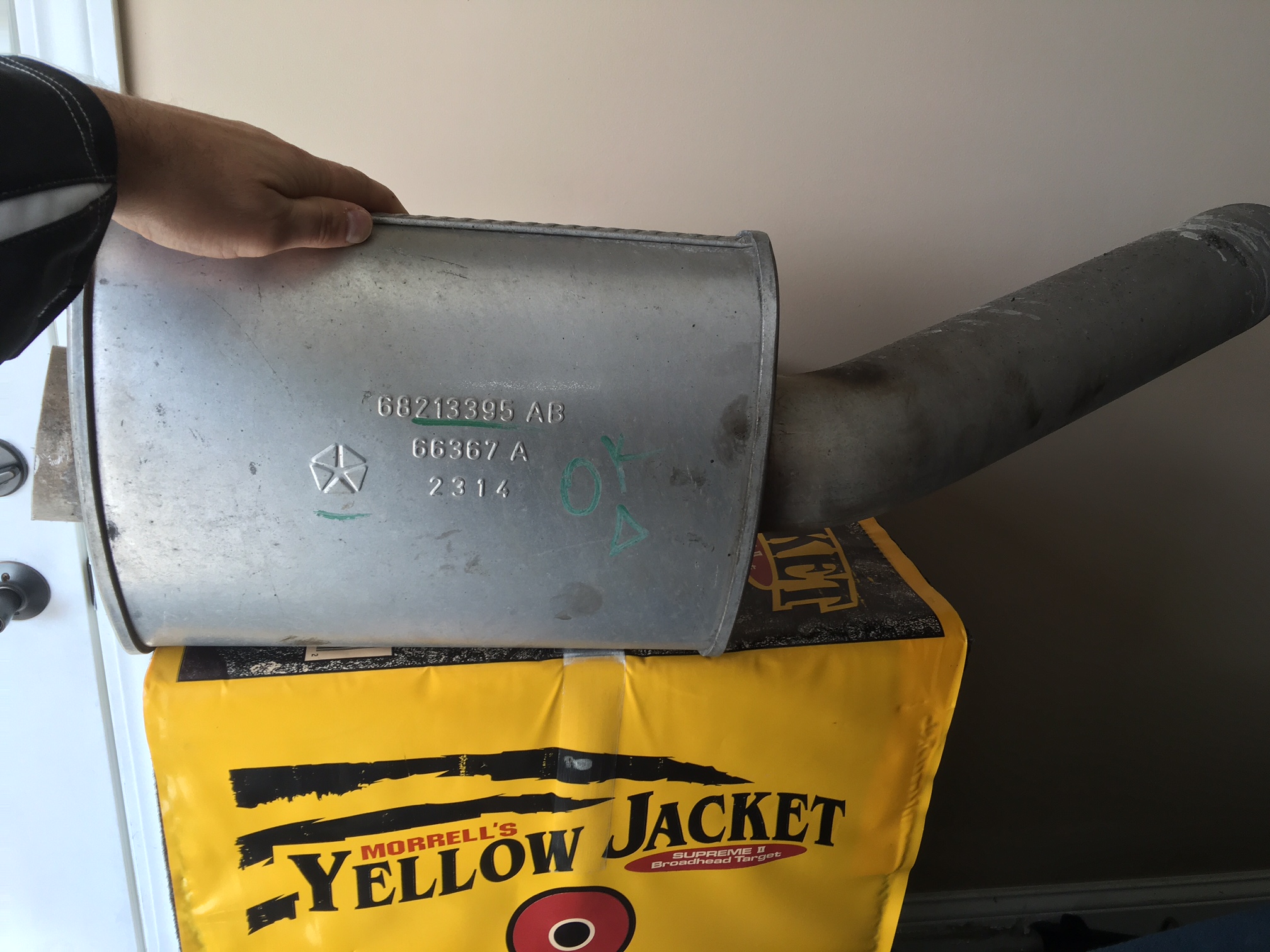

I was thinking about running ARH Longtube headers. But they would mess with low-end torque and I'll need a tune for best results.
I purchased a Magnaflow 12589 muffler. On my 1500 I had installed the Mufflex 14inch muffler. And I liked the sound. This time I thought I'd try something a little similar but more custom.
Took it to a local exhaust shop in town, paid $200 even to have it installed and have the trash can resonator removed. Was very clear about wanting it to be out of the way for ground clearance.
What he came up with was fantastic. I'm very happy with the results.
You can check out an exhaust clip here. I waited a couple of days for the exhaust to break in before recording it.

I also went with that Magnaflow mentioned above, and had it dump right after the muffler, so in front of the rear axle. No way anything will touch it when rock-crawling, well, I shouldn't say no way, maybe re-word to highly unlikely. I like the sound, and the improved throttle response was nice as well. Seemed like it was a perfect pressure amount in front of the muffler, because if you have it TOO free flowing, or TOO restricted, you can have negative effects I've learned. When I got the truck, the previous owner had already converted to a true dual off-brand exhaust, but I couldn't fit the two big Magnaflow mufflers under the bed so I went with the one big one, I'm pretty sure exact model mentioned above. So now, I'm true duals coming from engine, into single big muffler, and immediately dumped. No resonator, two catalytics. It's suiting my tastes, but I do indeed plan to upgrade headers at some point once I figure out the best bang for the buck.

Sounds deep & throaty, but WOW it's loud w/o that resonator on. I've got the mufflex & asked if they could send a straight pipe section to replace the resonator & they advised me not to remove it, so I kept it.

Cut off the resonator this morning and dumped the exhaust just after the spare. I can't tell any difference in sound quality or sound intensity. Drove about 10miles to test it out, 3-4 on the highway w/ the cruise set at 50, 55, 60 to see if I could get any drone when the MDS kicked in, and I can't tell any difference. If I really get on the go pedal, w/ the window down, I did notice a little louder, maybe, maybe not, or I might be just deaf. But it does drop about 10+ lbs off the back end, that's always good.

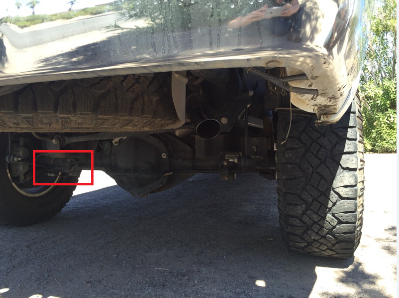

[quote="MikeKey"]
Did you notice your brake-line on the rear driver-side? I see they haven't corrected that.I have a 2014 and mine was the same way. Just asking to be hooked on something and torn off. I attached a link to what I did to correct it.

Post by adeluca73 » Sat Apr 09, 2016 4:19 pm
I just used a few long zip ties to keep mine from dropping down

So really no big difference with the resonator off? I have the same kit from mufflex... I hate the look of the resonator but was always told it would be significantly louder without it...

Thanks guys, just went out there and looked at the brake line. Going to take care of that before something else does! ;) Much appreciated!
14PowerWaggy - why not just unbolt the resonator for awhile. See how it sounds. Don't trash it right away. What harm can come?

I drove it almost 50miles tonight. I guess its more noticeable accelerating from a stop & seems loudest in the 20-40Mph range, but sitting at cruise on the hwy, quite as a mouse. I shouldn't have waited so long to dump that weight off the back, I too thought it would be unbearable w/o, it's not.
