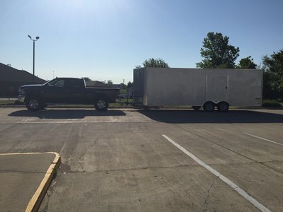

You have bags or anything on there? Did a damn good job balancing it, looks perfectly loaded.
khicks
Posts: 44
Joined: Sun Nov 09, 2014 3:12 pm
Location: alberta
Re: How many of you are overweight?
Post by khicks » Thu May 07, 2015 6:00 pm
Thanks. No air bags just load level hitch. Here's a pic without the hitch bars attached

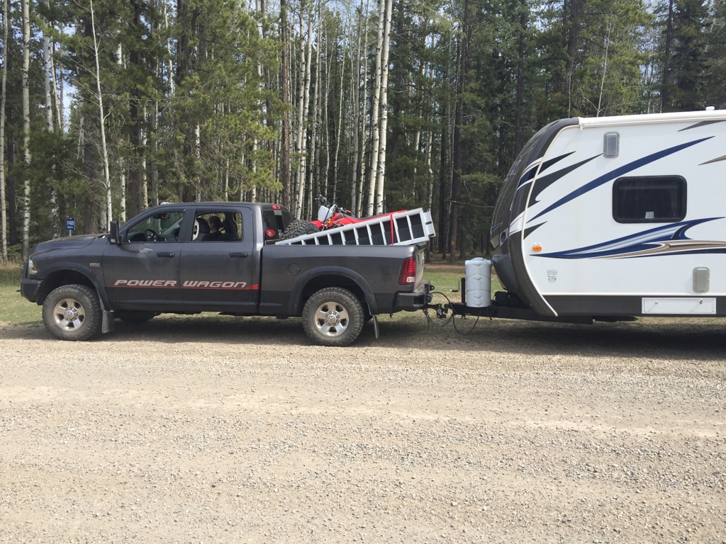

This is mine loaded up on the way hunting last fall. 7000lb trailer with my ATV, generator, fuel cans, chainsaw and ramps in the truck. Plus most of my storage and my water tank in my trailer are forward of the trailer axles so my tongue weight is pretty good. I've got the Air Lift air bags and Daystar cradles. Works awesome!
