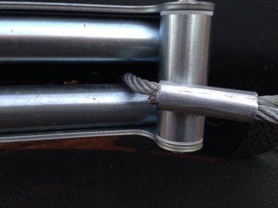

My new Warn rollers are a lot bigger and the cable slot isn't large enough for the cable clasp to fit through. I wish it fit so I could tuck it in. These items rock!

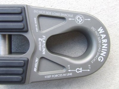

I have the Factor 55 foldable clevis installed & it will fit inside the PW bumper & snug against the rollers, but it is a tight fit. I wedged it in loose, then ran the winch cable tight. You need a set of safety ring pliers to get the retaining ring locked against the cable pin.

Got the flat link on mine too. After using the thimble all summer on the jeep, I waited to get this before even setting up my winch. Great safety features!
