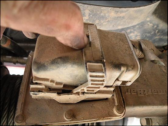

SMART BAR GREASING
Post by Cactus Red » Sat May 26, 2012 10:14 pm
SMART BAR GREASING
1st pic. Locate your smartbar connection plug. There is a strap that goes over the connection.
2nd pic. There is a button in the center of the connection that you have to push in to move the strap.
3rd pic. Push in the button and move the strap to the left (drivers side).
4th pic. Move the strap all the way over to the left. Once you do that. Now you can pull the connection apart.
5th pic. This is what it looks like inside the connection. You can see the light blue gasket in the top half of the plug.
6th pic. Apply your favorite dielectrical grease to the plug, and reinstall.
