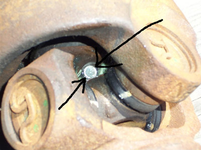

Grease fitting on front d'shaft
Post by Cactus Red » Mon May 21, 2012 9:59 pm
http://powerwagonregistry.org/faq.php
Greasing Front Drive Shaft
If there's one maintenance piece that is tough to find, it's this. Unique to Power Wagons, many dealerships will argue that it just doesn't exist. Well, here it is, how to find it and what needle fitting you'll need.
First, jack the driver side front up so that you can spin the tire. Slowly turn it until you get the grease fitting into view. If your u-joints are dirty, this will be hard to see so you might want something to clean around in there. After you grease it up, you might want to use a Q-tip to clean up overspill so it doesn't collect more dirt and will be easier to find in the future. Some folks have even used nail polish to mark arrows on the u-joint to make it way easier to find.
Grease gun needle fitting:
http://www.tractorsupply.com/vehicle-ma ... ct-3952769

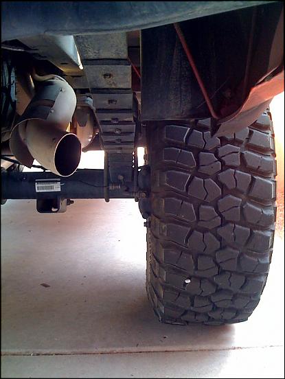

Exhaust Tip Mod
Post by Cactus Red » Fri May 25, 2012 9:09 pm
Exhaust Tip Mod
Some of you may have found this out already but if not keep this in mind. The stock exhaust pipe tip is pretty low and near the rear tire. Watch out if you get stuck in a hole with the back right tire as if you bounce through it in reverse you may find your exhaust bent with the tip way inside under the axle and rubbing the tire. This happened to me and i have now cut the exhaust off just above the axle. No more issue. just a heads up.
