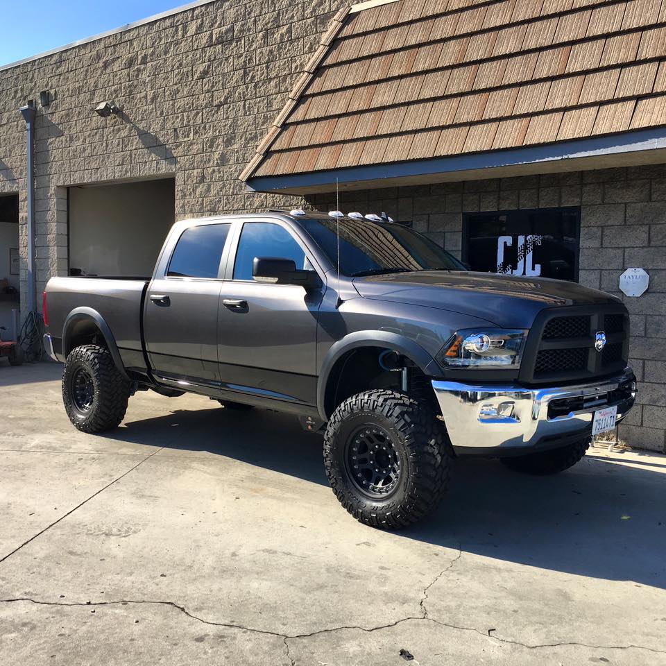

Here is a pic of the CJC wagon... I never got an answer if those are 35's or 37's... If they are 37's then that is way more lift than I am looking for... Does anyone know what size tires are on that wagon?

Looks like 35's to me..

So just ended up having a PM convo with the owner of CJC on Facebook... Here is what he told me about the CJC Wagon they built
*Truck is on a Carli Pintop 2.5 2500 System with the front Carli coils replaced with the Thuren Diesel Coils
*Truck is on 35" Nittos with 17" wheels with 4.75" backspacing
*Truck is using the Carli shocks that came with the Pintop system... They did not have to adjust the shocks...
*Said you would still need to trim to pinch seam and wheel liners to run a 37 or 38" tire...
*Said with the added weight of an aftermarket bumper that the front should come down about .5" (Depending on which bumper someone went with) and be spot on...
I told him I already trimmed my fender liners and pinch seams to fit 37"s on stock suspension and he said I would have no issues running my current set up with this suspension system and that the truck would drive significantly better than stock...
Man... I wish I wouldn't of had that conversation with him... Ha... :lol:

35's.

Take a close look at the space between the fenders and the tires in the picture above. Notice the gap in the front compared to the gap in the rear? I think diesel rear coils still only net +1 over a stock gas 2500 which is -1" on a radius arm PW.
