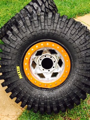

AND Santa Claus arrived with the new Maxxis Trep Comp Sticky's 40x13.50x17 :lockedandloaded: :lockedandloaded: :lockedandloaded: :lockedandloaded:

The new BL's arrived today.... and got them installed.... They are a 1/2" taller than the MTR Kevlars. Total weight difference than the old set of MTR's with the steel BL's is 34 pounds. The Maxxis tires and the forged Aluminum BL's are 34 pounds lighter each :rockon: :rockon: :rockon:

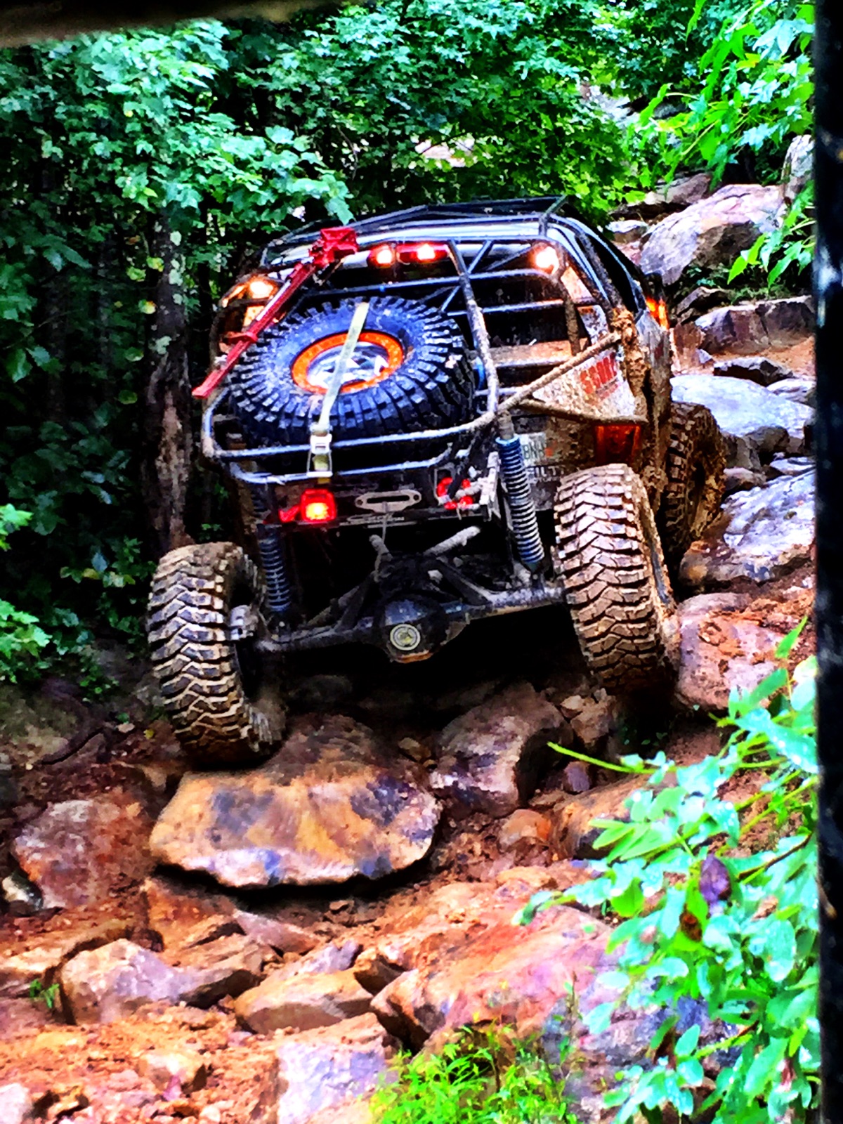

OK... After beating on these tires for 5 straight days in WindRock, Tn I will say that these are the BEST investment that I have EVER put on this truck!!!!!!!!!! These hook up STUPID on EVERYTHING!!!!!! Very happy with the investment... Cant wait to bring them to Moab and beat on them... My truck is 150% better in ALL aspects of wheeling.. Just wanted to give ya'll the heads up.... BEST TIRES I HAVE EVER RUN IN ANYTHING OFF ROAD>>> :rockon: :rockon: :rockon:

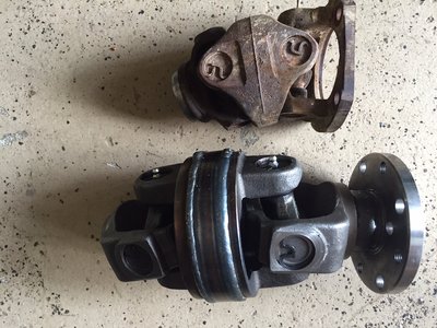

I finally fixed the issue of it throwing/killing front drive shafts, I made a custom 1430 1 ton (bad boy) high flex CV with the upgraded 3/4" pin front drive shaft and did away with the weak 1350 joints in the front (they kept failing) It was the only weak link in the entire drive train. I dont know why Dodge put the 1 tons on the rear D-shaft and then ran the 1/2 ton joints in the front. Ever since I installed the new front drive shaft she has been unstoppable under MANY high throttle assaults on the rocks. The CV (bad boy 1430 3/4" pin 45 degree flex) joint was machined to accept the stock ID of the factory Dshaft was a $550 upgrade with the new 1430 yoke and flange to match the factory serrated flange on the front axle. Worth every penny, and was about 2 hours of fab work to make it..
*If any of ya'll want the info/specs on this front Dshaft, let me know, It was a killer upgrade to the factory set up, AND you can re-use most the parts on the factory shaft.

Stock is the right side... The new BB CV on the left... :rockon: :rockon: :rockon: :rockon:
Got a hard-on when the UPS guy arrived with it:) (is that fucked up)?
Posts: 1653
Re: boob here with a built Dodge ram Expedition rock cralwer
Post by Colibri » Mon Sep 14, 2015 5:51 pm
That's sick! Seriously stout, I can't imagine you'll have trouble with that front shaft meow. I am amazed your front axle housing has held together so well through all the craziness though. It's the axle equivalent of Lt Colonel Kilgore I guess lol
