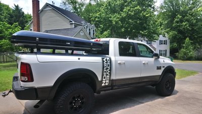

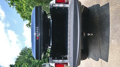

RTT is on:
And spare tire is safely caged in by the bed rack and cargo divider:

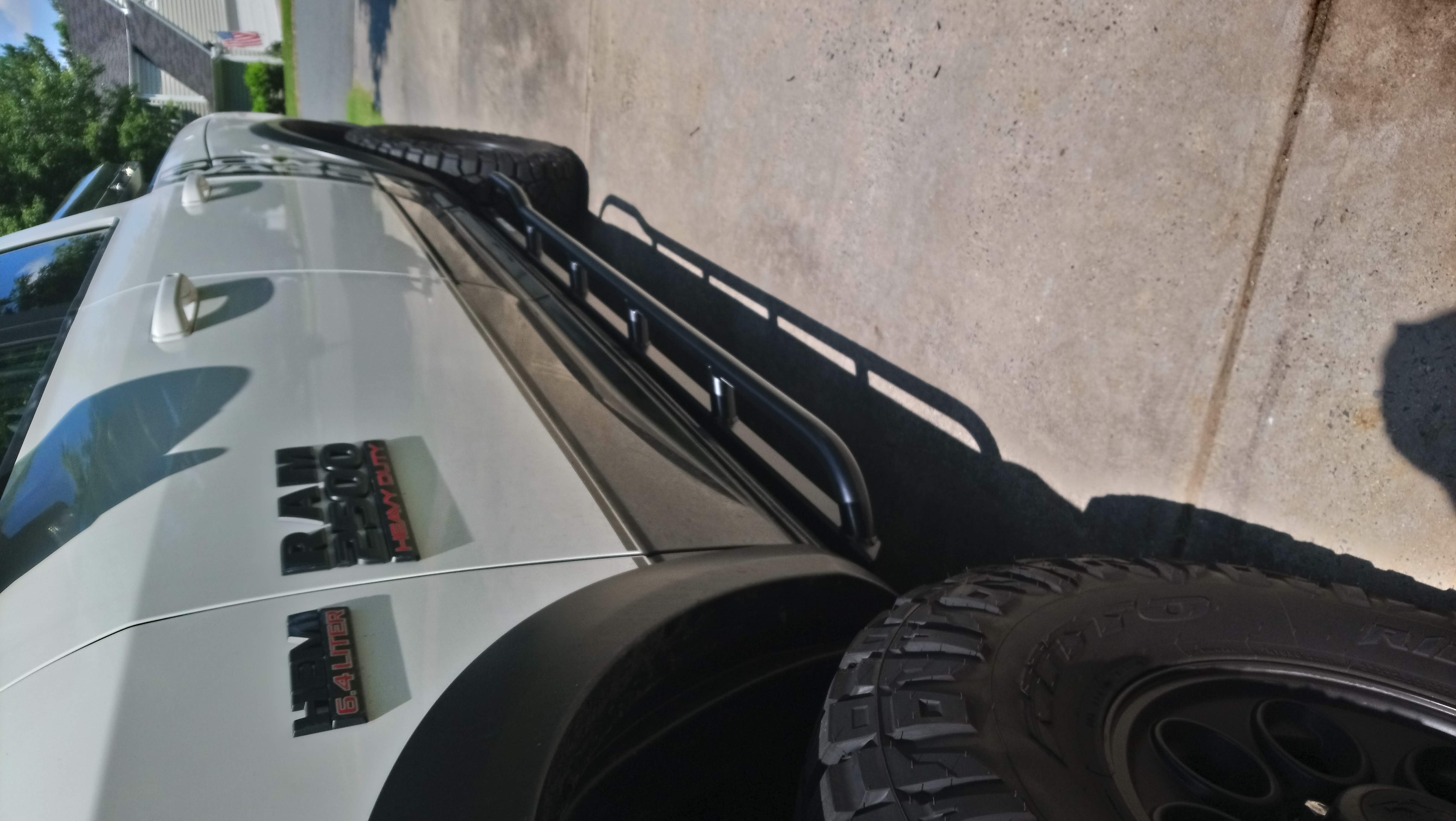

I had to flip the Frontrunner bed rack upside down so that the iKamper mounting brackets could get all the way around the slats. With the Frontrunner lip, the RTT was sitting a little to high to be able to "grab" the rack slats.

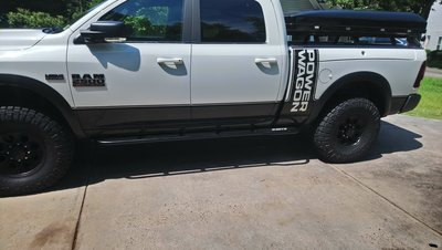

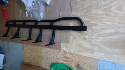

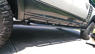

Got the White Knuckle Rock Sliders installed a couple weeks ago. Notes on the install:

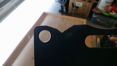

-Had to grind down the shim on the driver side due to an errant ground clip that was in the way. Ground clip probably could've been moved, but the grinder was handy and I prefer to leave as much stock as possible.
-Move of the frame rail wiring that had to be liberated from the frame has mounts close enough to the slider mount points that no re-securing was needed
-On the passenger side, one of the brackets is making contact with the body, causing a OCD-triggering episode. Probably due to an installation error, but it should be resolvable by loosening the one mount and shimming it away from the body with some plastic shims
-The extra ~300lbs. slightly affects stopping power. After the tent, rack, and bigger tires, I'll probably upgrade the brake pads with Power Stops or EBC Yellow Stuffs

Post by olyelr » Wed Jul 17, 2019 10:21 am
I had the same passenger side ocd squeak as well. Ended up being a washer rubbing on the body. Took the bolt out, ground down a flat spot on the washer, and reinstalled so the flat spot was now pointing toward the body. Noise be gone.
Awesome. I'll try that and report back on how it works. It's bugging the shit out of me.

I have my biennial expedition is coming up at the end of August and I'm trying to wrap a couple things up. Base on the routes we're looking at, I think the top three things to finish on my priority list are:
-Bedslide apparatus for easy access to camping gear (hard to get to with bed rack in the way)
-Auxiliary lighting for roof rack

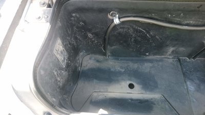

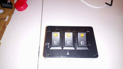

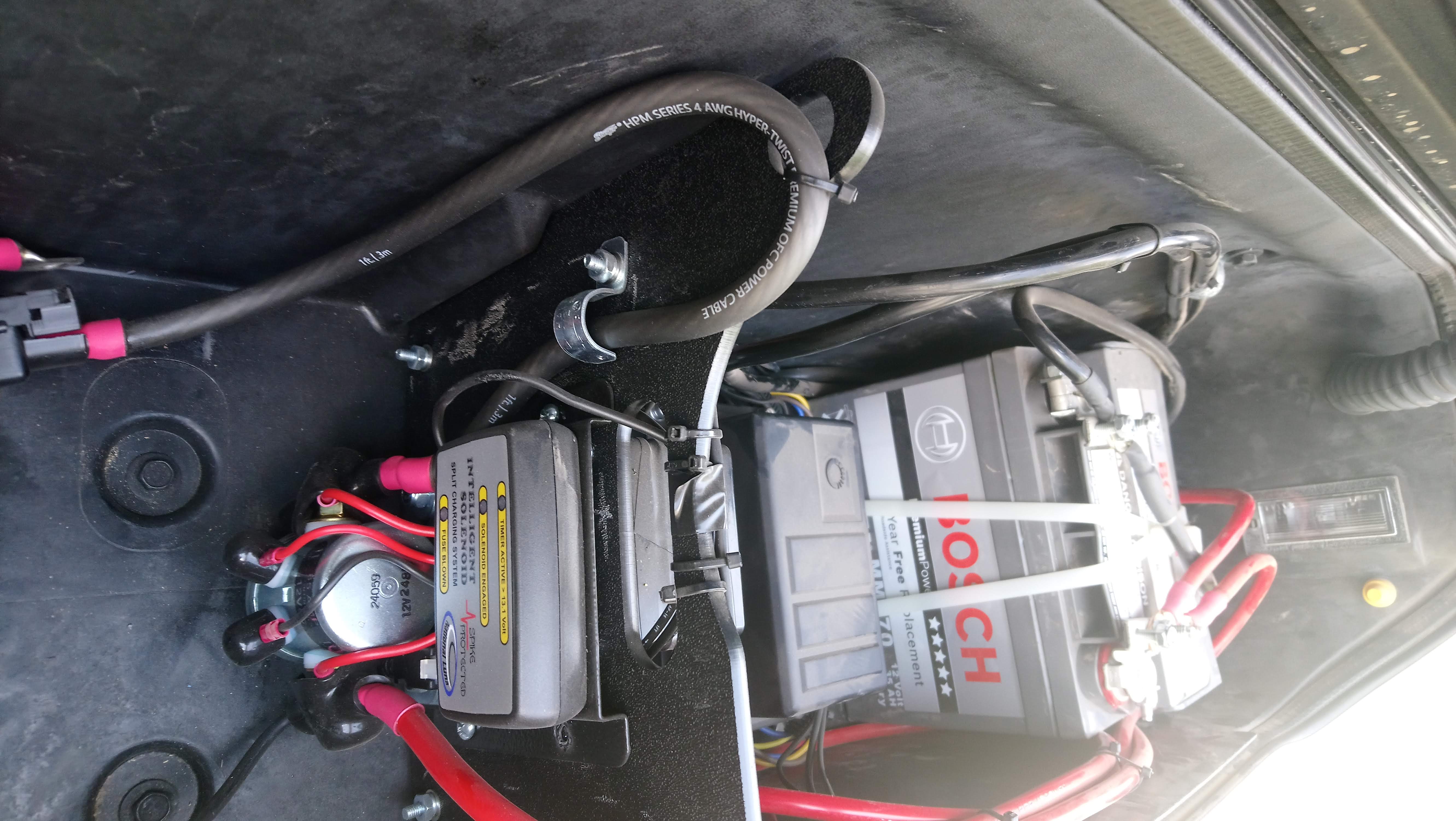

For the lighting, I'm putting a battery in the RAMBOX with the National Luna battery controller and a switch bank to control the camp lighting I'm putting on the bed rack.

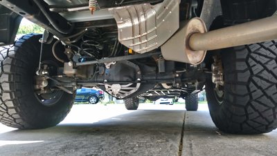

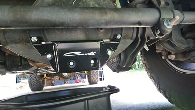

I'm still hunting for diff guards and welcome suggestions. I've seen recommendations for Carli and Purple Cranium, but not sure which is best for front and back. Looking for designs that consider drain plug placement and lack of modification to stock components.
Posts: 3620
Re: Torq's Build - 2017 RAM Power Wagon (Nickname Undecided)
Post by olyelr » Sat Jul 20, 2019 11:25 am
Cant go wrong with either of those for diff protection. However carli is only the front, so if you want to keep it “uniform” then go purple cranium and be done with it.

Yea, the first thing to do really is closely inspect all of the mounting bolts to determine which one is actually rubbing on the body.

I'm ready to pull the trigger on the Purple Cranium rear diff guard (since it's the only option). Is the link below the correct diff guard for a 2017 PW (just want to be sure, I only have a month to get this finished so not much time for corrections in erroneous orders)?

Hm. The wording on the website is a little difficult to understand. At one point it states it fits a 10.5” rear, and then another it says its for the 11.5”...
I would call them.

Ordered. They were very helpful on the phone. Snapped a quick picture and they confirmed that it was 11.5"

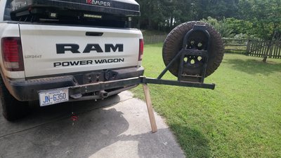

Just picked up my Wilco Hitchgate. I'll be installing it tomorrow and post pictures. Hopefully get the rack lights and Carli Diff guard installed too.

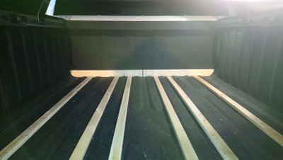

Well, I only have half of the hitchgate, so that will have to wait till next weekend. In the meantime, I'm working on the homemade bedslide and the rack lights.

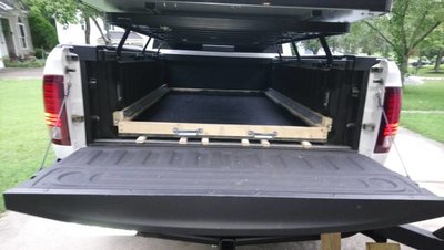

I love the bedslide from...Bedslide, but I'm taking a shot at avoiding drilling holes in my relatively new bed. Also trying to avoid anymore big expenses before my September expedition. The materials for the homemade version looks like it's going to run me about $150.
Got a good start today. The back board (close to the cab) took a little creative jigsaw abuse to mount flush with the bed over the ridges. The 1x2 furring strips are going to get some UHMW plastic laminated on them to lower the friction to make the slide out easy. On the tailgate side, I just laid down a piece of aluminum stock to keep the furring boards in the crevices of the bed. I'm using 3/4" sanded plywood for the platform and putting a lip around the edge with some 2x3 boards. I'm planning to paint the plywood with some plasti-dip to make a high friction surface. I'll also install some tie down rings.
This whole thing has been a bit of "design-on-the-fly," so stand by for the latching mechanism. I have some ideas.

Finally got around to fixing the squeak. The washer was exactly the issue. No more squeak.

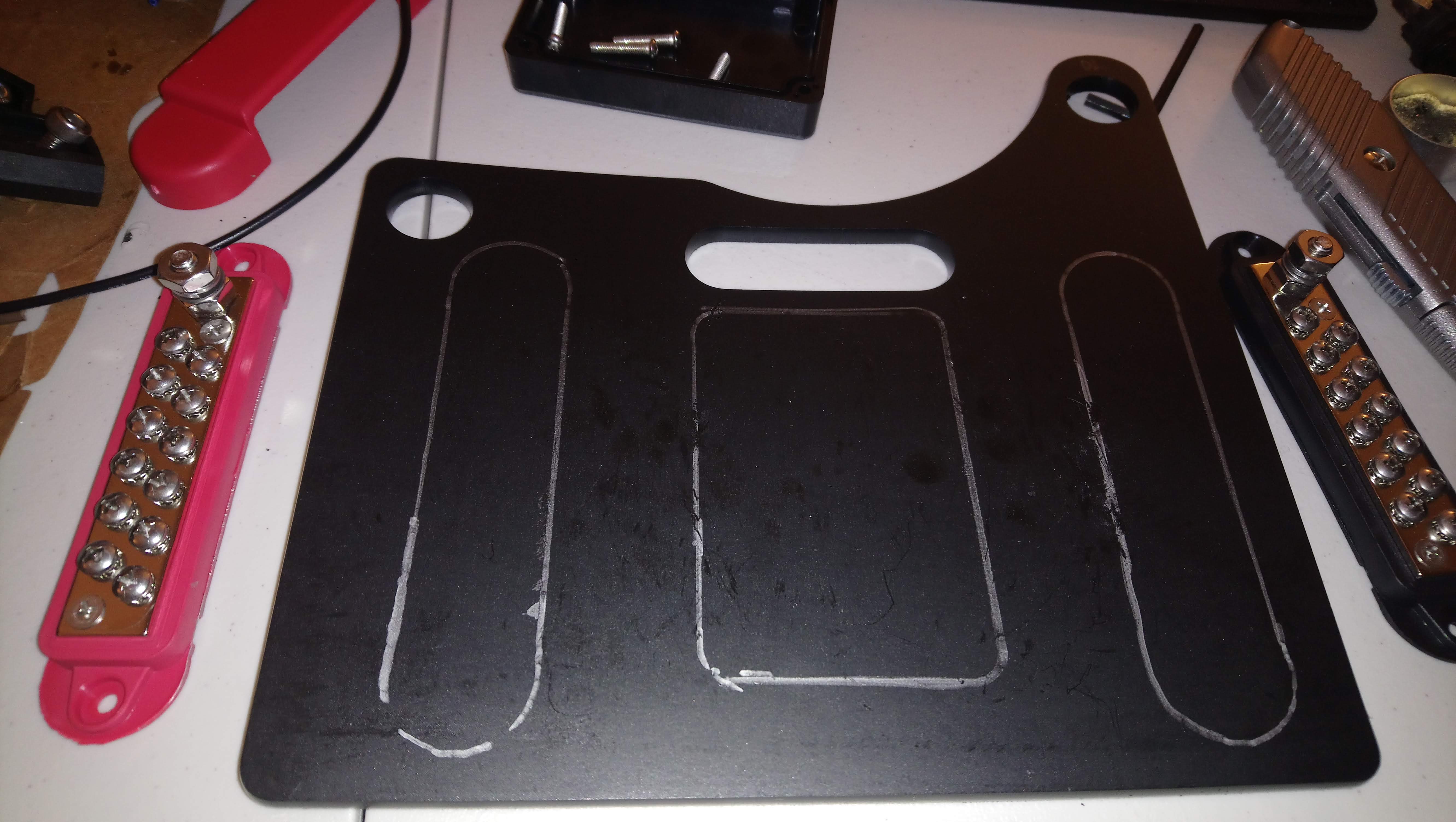

In parallel with the bedslide project, I'm working on the wiring for the lighting and mounting of the relays, switches, bus bars and smart solenoid. The plan is to only drill holes in the RAMbox dividers, not in the plastic of the RAMbox itself. Doing a mock up, I realized that the RAMbox hits the dividers so I had to cut a groove into the dividers closest to the latch.

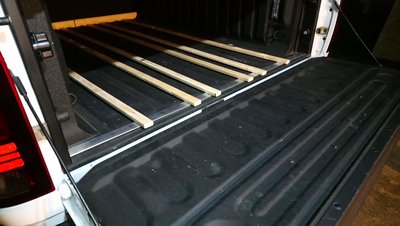

Here are a few of the no-drill bedslide project. I was able to create some rail mounts using the tie-downs.
It slides pretty well over the 1x2s that are laminated with low friction plastic.
I painted the platform with spray rubber to weather proof and prevent sliding. I used the Husky tie downs for ratchet points.
Just finished 5000 miles with some really rough roads at high speeds and it held up really well.
I used a couple of wedged 2x4s to support the bed slide when I pulled it out fully loaded so future improvements include some fold down legs.
