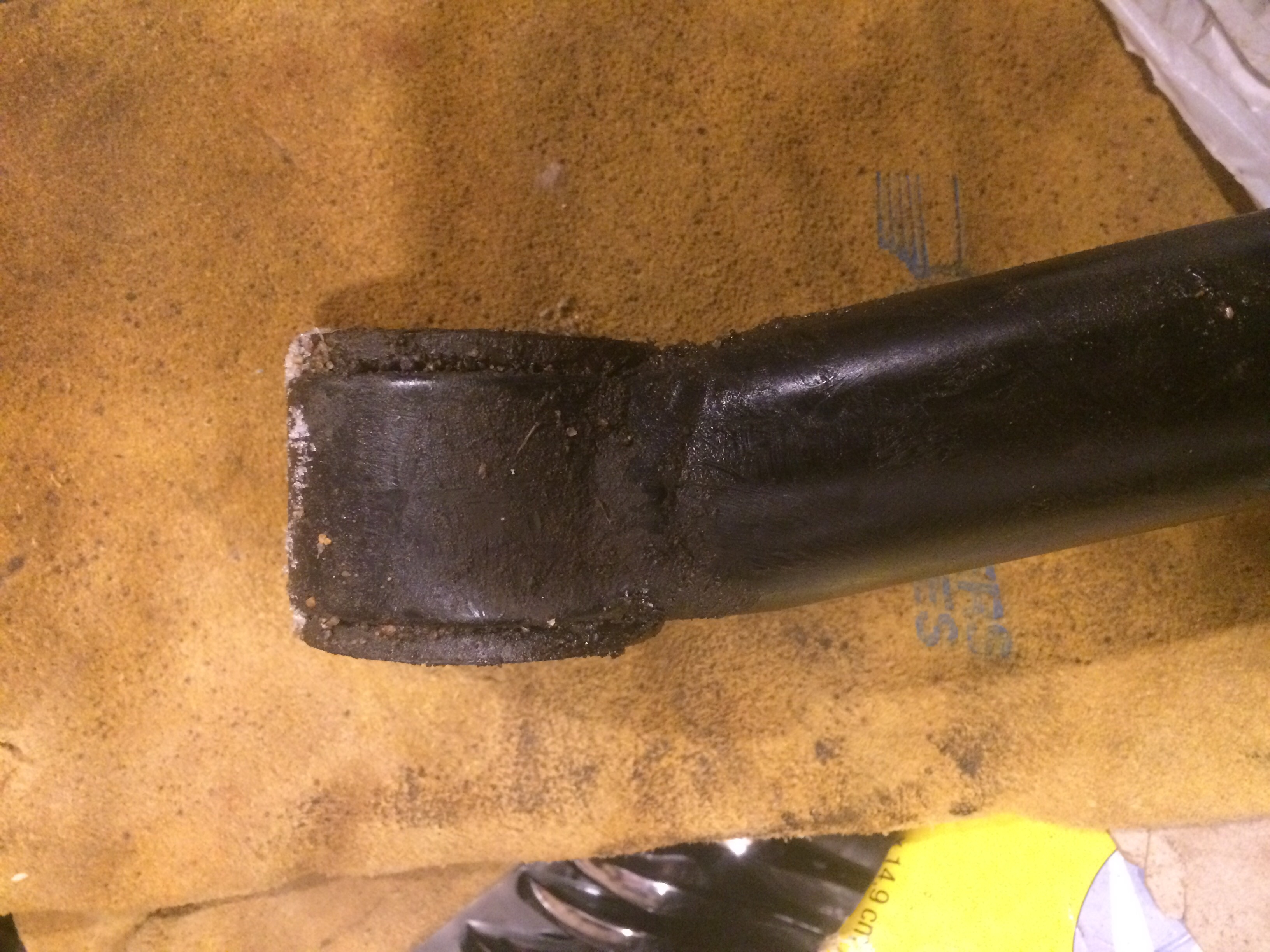

I went to install the replacement heim in my Carli bar and found out Carli upsized their heim, so my misalignment spacers didn't fit. Put the blown heim back in... Also found that the Carli bushing I installed 3,000 miles ago is starting to oval. Good thing I bought Thuren bushings as a preventative measure! Well, until...
My
Find out the Thuren bushings I was going to run in the Carli bar just slipped right in, no press fit. Aaron said some of the early ones might oval the tube and the bar has to be replaced. last night was a good one!
So now I need a new Trackbar. And drag link. Little stuff, but it adds up in fun ways

I did originally think I could but their bushing won't work as my Carli bushing end looks like this. So to keep the angle I'll have to use a heim

Are you trying to tap your bar and use a threaded heim or use a weld on style? You could cut the bar at an angle and use their weld on bushings. A heim on both ends might make for a rough ride on the little stuff. I believe 2wagons runs heims on both ends and uses a straight Trackbar (his 6" lift lets him run a straight bar)

Weld in threaded sleeve

Your Carli bushing is probably shot then. I was on the phone with Aaron and Radio about this today. My Carli bushing is starting to oval out after 3000 miles. The Thuren bushings should fit perfect and last a lot longer, and are half the price haha. I found that the Thuren bushings don't fit mine but I think I have a different problem with my bar. I felt a massive difference in ride quality when I switched from the factory bar, even though I couldn't see any movement in the factory bar when parked and watching while someone turned the wheel. You should feel a difference in the little jittery stuff.

My Carli bar bends 3/4" in the middle when you turn the steering wheel on flat gravel with the truck not running. I brought this up with Dan at Carli and they just want more money. The track bar is the last Carli thing on my truck. And I'm only using it for now until I can figure out which direction I want to go in. I'm just surprised how much a 1.5" .25wall tube bends. The stock bar doesn't flex that much. I've looked. Dan then tried to school me on the laws of physics telling me that my hydro assist which connects from the axle directly to the tie rod was causing the track bar flex. Even when the truck wasn't running. I was pretty annoyed and am tired of dealing with stupid. You should see how they warrantied my shocks and gouged them up. You won't hear me say good things about Carli after what I've dealt with. And ask any Canadian who had bought their ball joints if they've been able to get the lifetime warranty as advertised. Sorry not meaning to rant lol. I just get wound up bout it now
