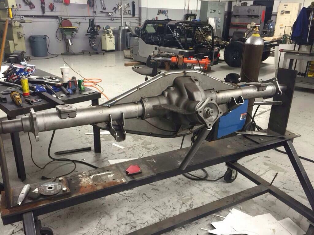

Gunna be really simple like this just an upper
Tho. I always run full synthetic I think I will do 75w90 for the first 1000 miles like you said and maybe add Lucois oil stabilizer in it also then dump it and run 75 w140 again. Again with stabilizer. I don't mind the gear clap but I do have a feeling a bit looser will be better for
Me. And the way I drive lol thanks for the advice about the highway and varying ranges I will for sure do that.

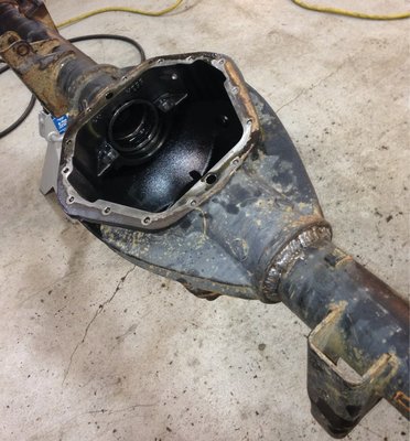

ya I really want to do the lower but this swap to the 11.5 I'm losing enough ground clearance sogun45boat wrote:OK!!!!!!! That is PIMP.... THat will look and perform flawlessly.
I think I'll be fine with the top I'm pretty sure that falls right on the breather tube line so I may have to bung a new one in.

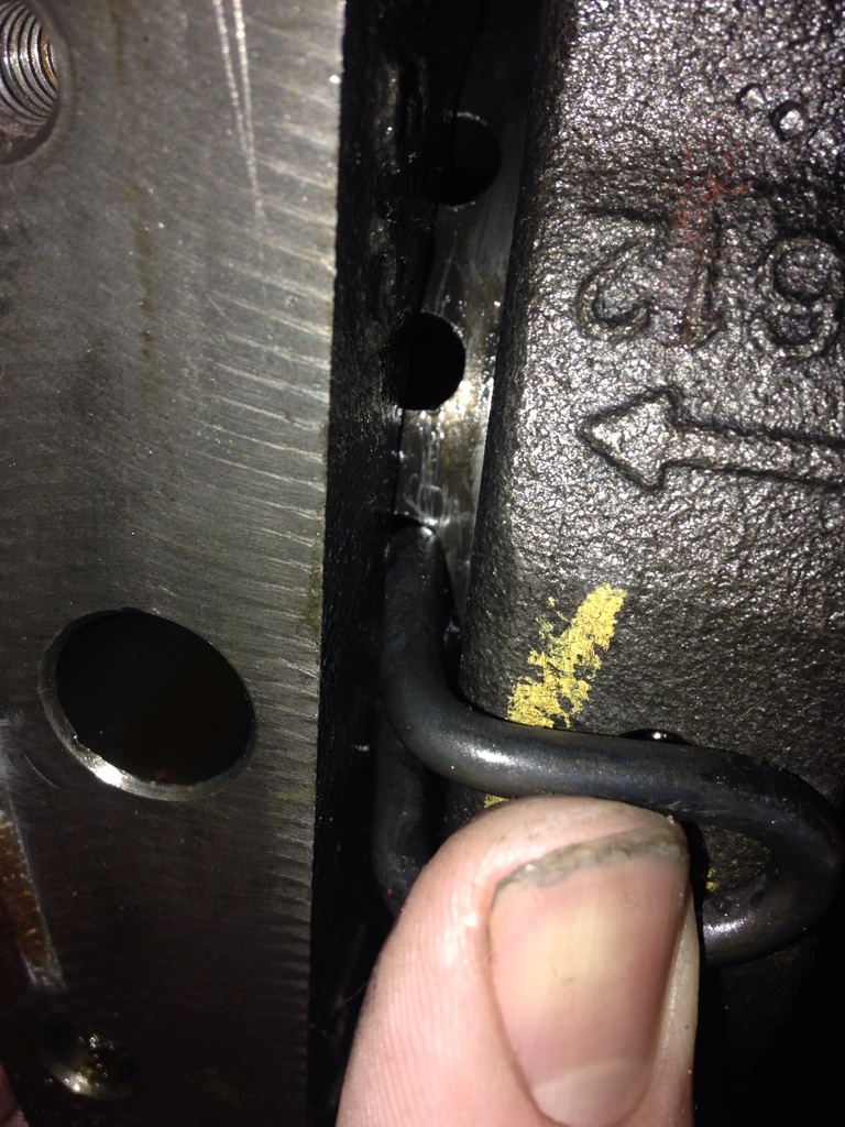

Hmmm?
Sent from Canada

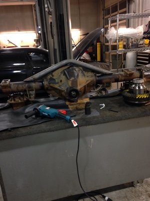

I guess grind this down a bit so she fits lol Sent from Canada

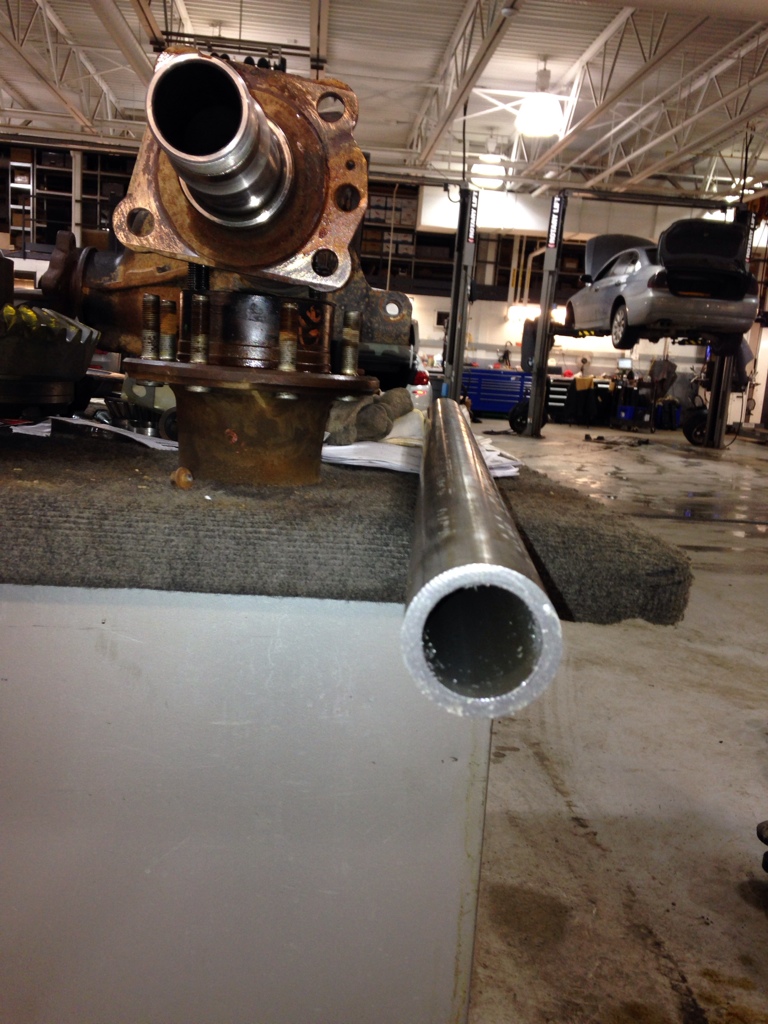

That's .250" wall 2" in case anyone wants to know. Surprised the bender actually bent it.

Well THAT won't be the weak link. Haha

That's what I got as the main tube on my Carli front bumper.2wagons1driveway wrote:That's .250" wall 2" in case anyone wants to know. Surprised the bender actually bent it.

She's Deffinately hefty. Was hoping to get it tacked and to my buddies shop where my "big mig" is but not sure that's going to happen as the 5.13's are getting put in the front tonight/ tomorrow

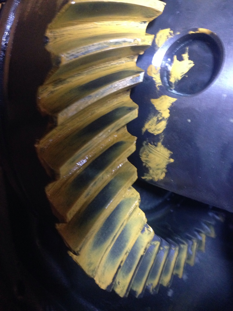

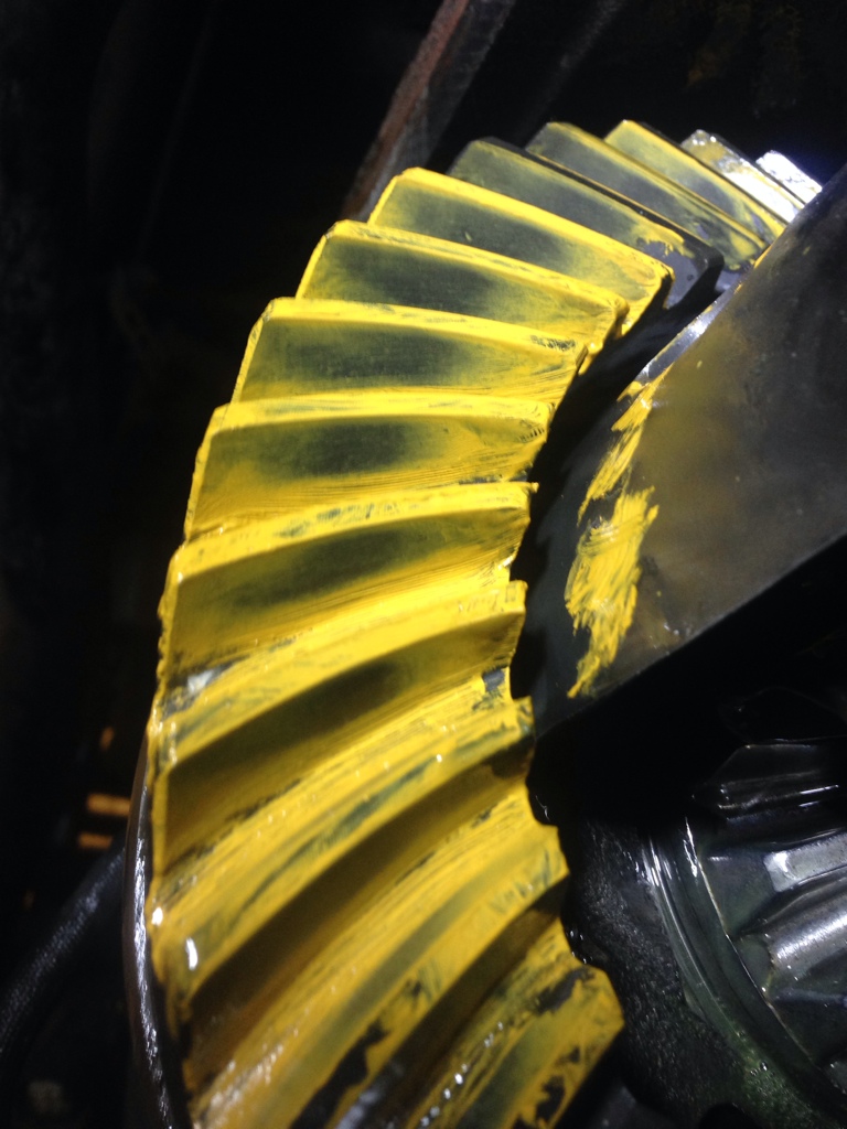

ya man did another pattern after I installed locker again set up bulkhead /copper line was a pain but is in and looks good working on upper truss still. Set backlash to .008"nts007 wrote:He needs his truck so he can't waste any time. I know that one well. Looks good 2wags.

Pulling some good patterns out of those gears man, nice work!
