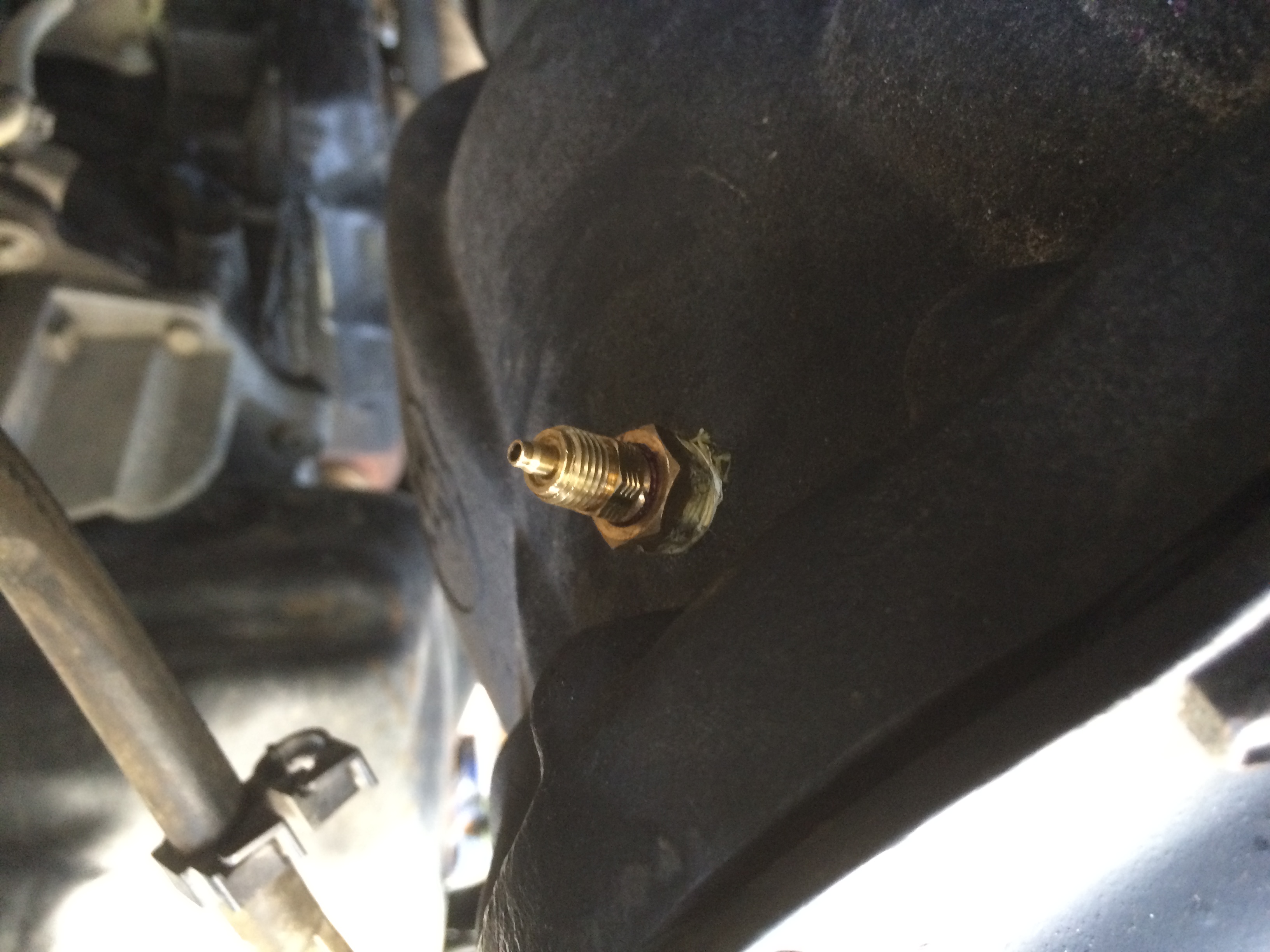

ARB bulkhead fitting
Center compression nut installed

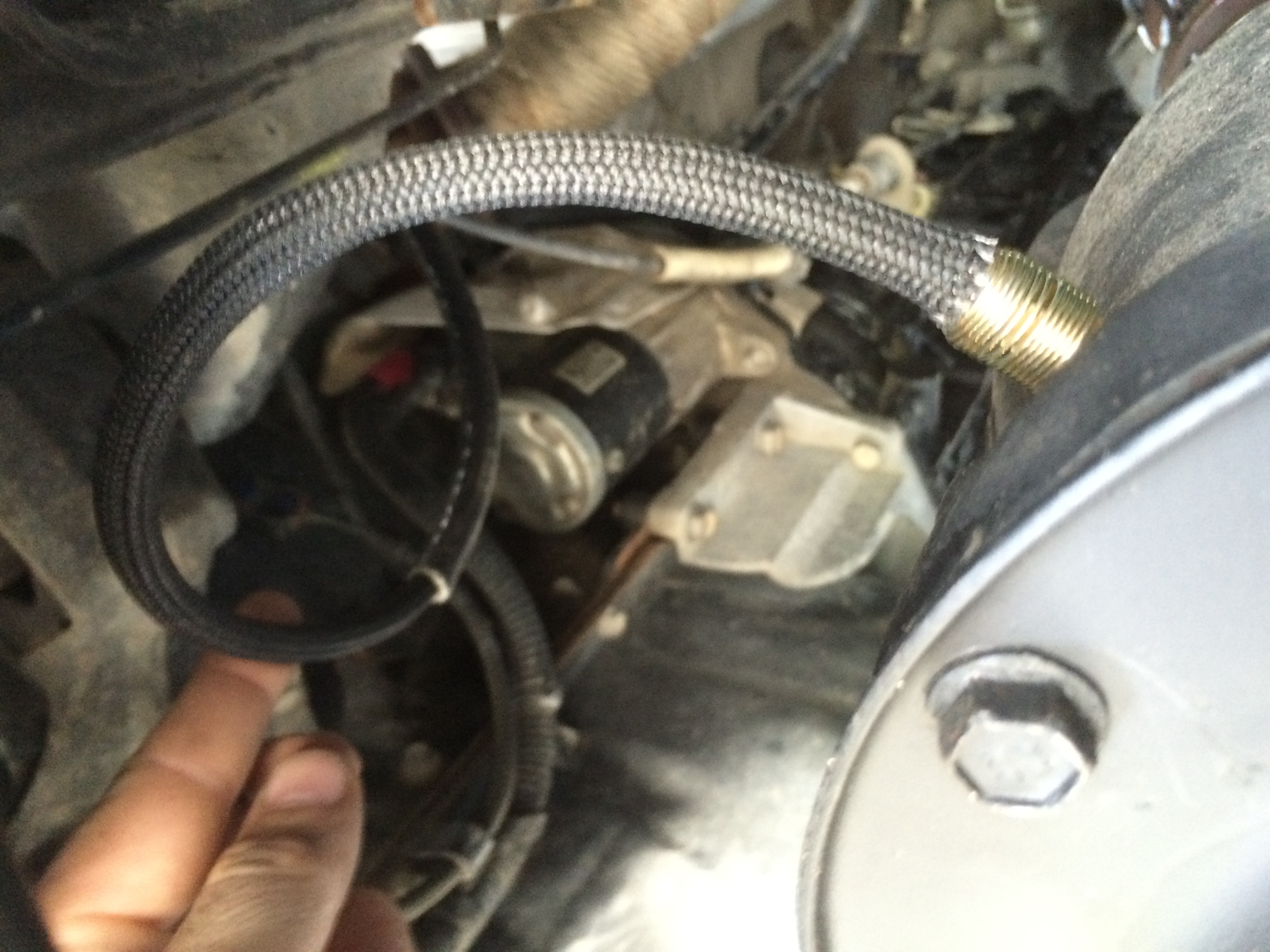

Airline with outer compression but and strain relief spring
Ready to rock

That braid over your air line is trick man love it!!!!

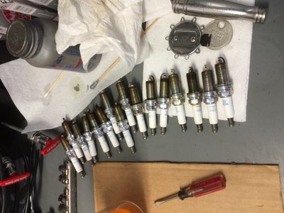

Post by Colibri » Thu Sep 01, 2016 5:02 pm
Did spark plugs today, I always forget how shitty that is lol.

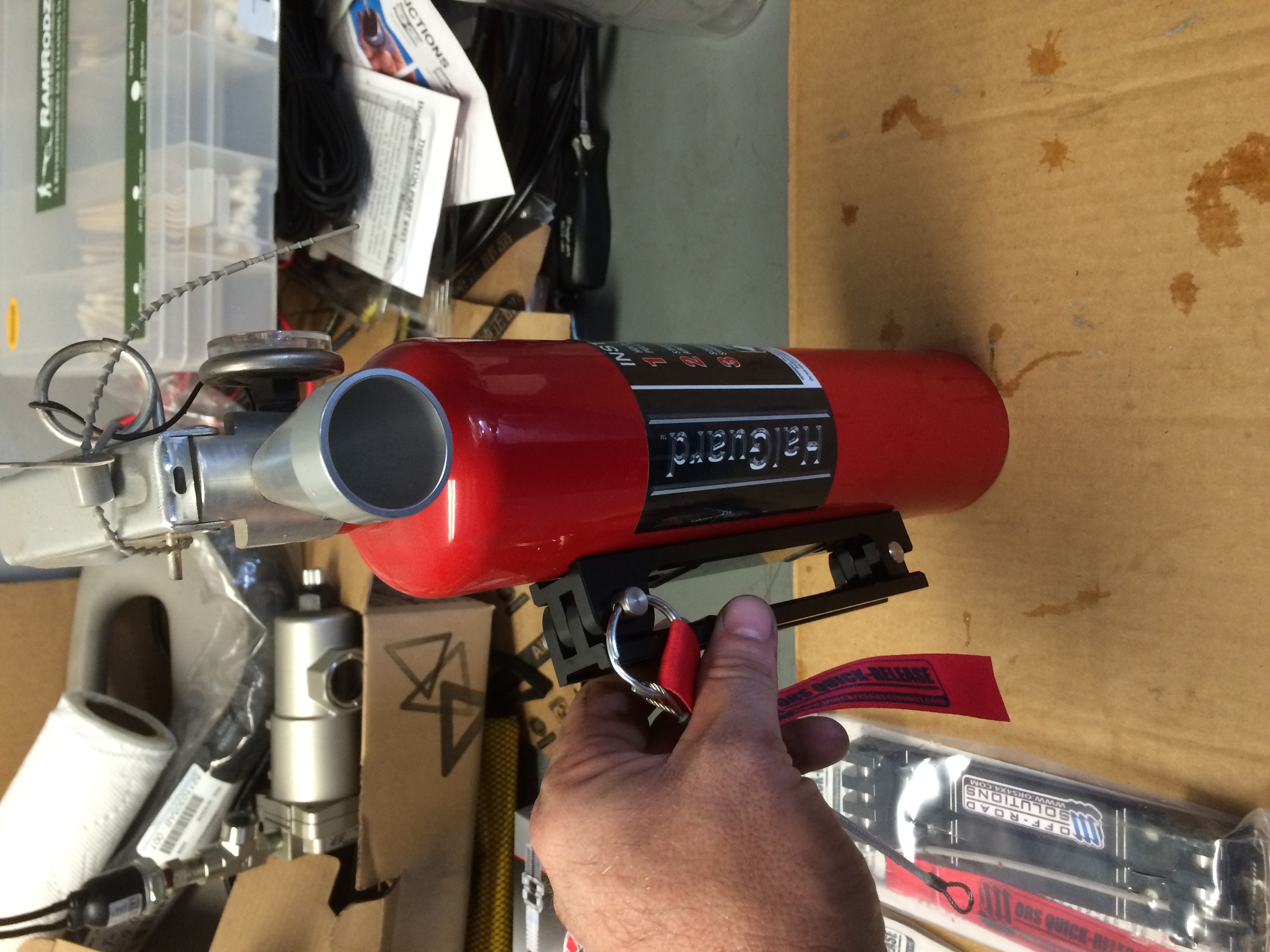

Have a few parts trickling in too. Got the billet aluminum quick release mounts for the in cab halgaurd extinguishers. Going to mount them in front of the front seats I think.

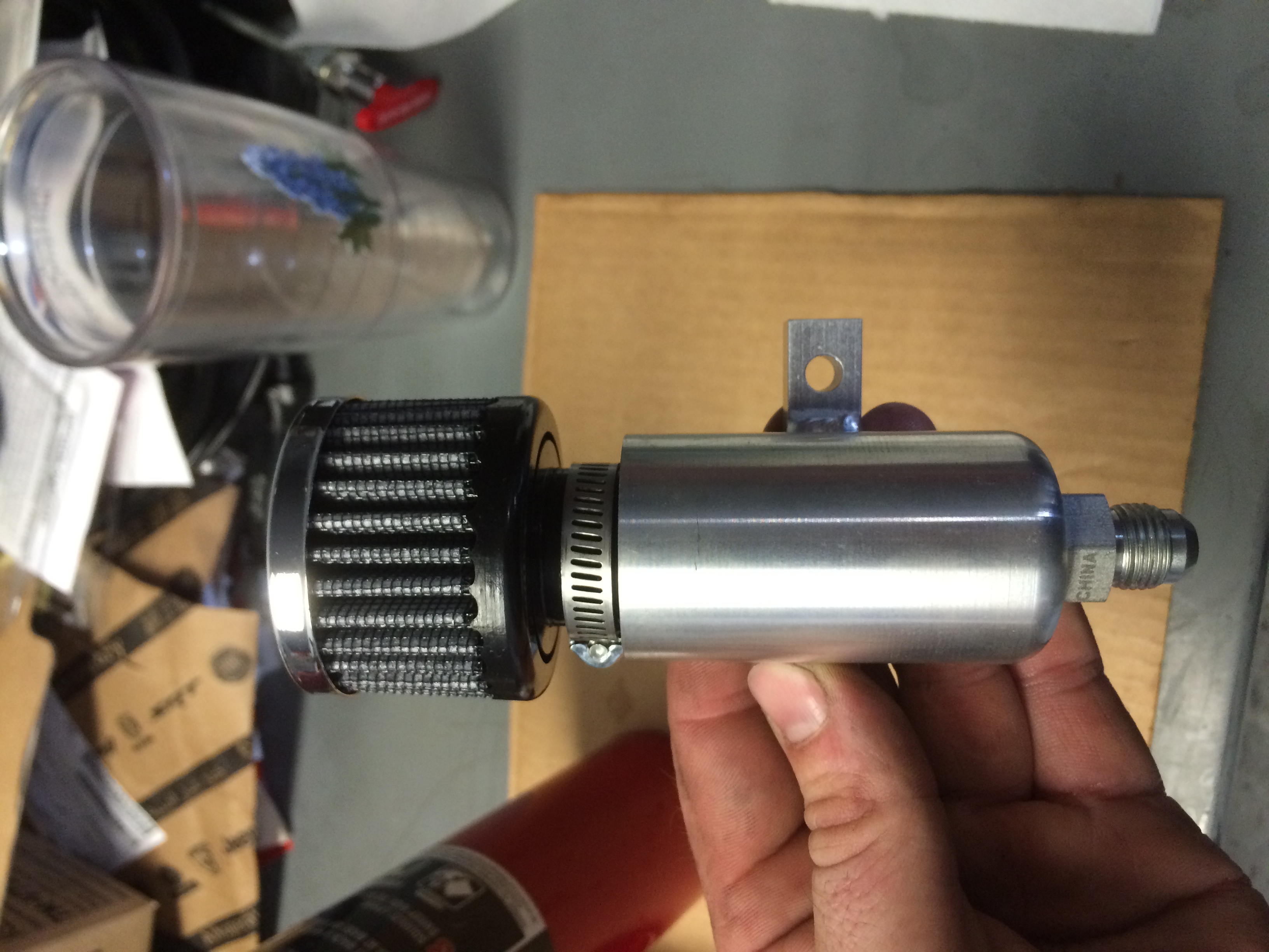

Also picked up some new differential breather hose for both axles and some extra to extend the transmission and transfercase breathers. Just to be on the safe side I got a filtered breather/catch can for each line that is equipped with a rollover valve to prevent any flammable liquids leaking if I should wind up on my lid one day lol. Safety first :rockon: :nopics:
PSC breather with rollover valve
Fire extinguisher and billet quick release

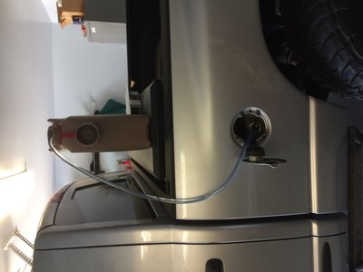

Post by Colibri » Fri Sep 02, 2016 7:09 pm

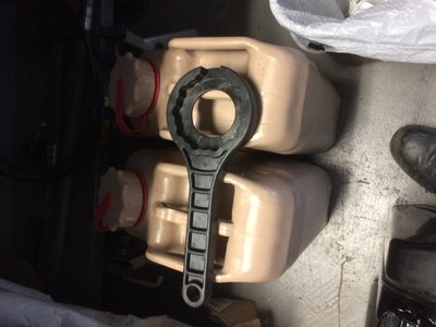

Gassed it up today with jerry cans and a super siphon. That siphon is worth it's weight in gold. Added 25 gallons of fresh 93 octane and dosed what little old gas was in there with pri-g fuel treatment. Gonna let it sit overnight and I'm going to try and fire it up tomorrow! :rockon:
Scepter military fuel can woot
This wrench is a must if you own scepter mfc's

Post by Low_Sky » Sun Sep 04, 2016 12:20 pm
Where'd you get that gas can wrench? Mine are pretty tough to open if I change elevation.
Never mind! Found it on Amazon. It's called a CapWrench MFC.

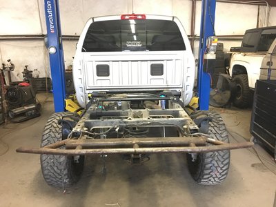

Post by Colibri » Tue Sep 13, 2016 8:53 pm

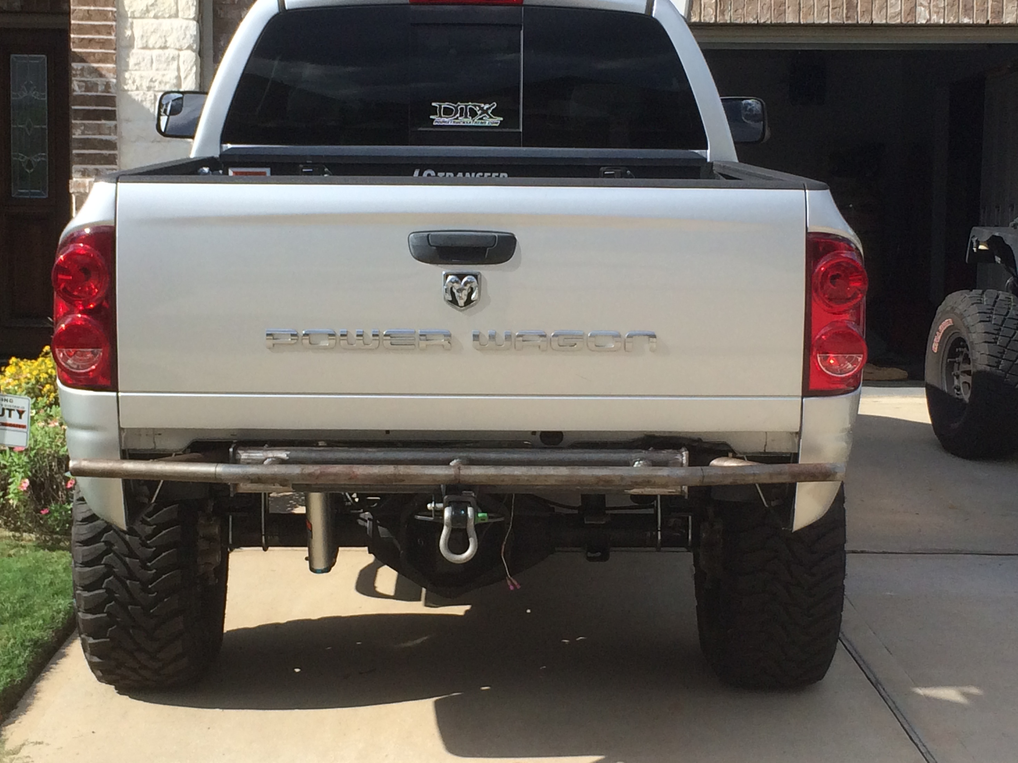

Got the oem tow hitch pulled off today, it was a real pita. Had to pull the bed bolts and jack it off the frame to rotate the hitch up and out. Got my pattonfab/Thuren tube bumper installed too. It's at least 18-24" more clearance out back now! Next up is cutting the lower rear bedsides to match the new lines and gain some additional clearance. Can't say enough about the quality of this beast. Anyone in need of a high clearance rear bumper should give pattonfab a serious look. Great guy to do business with and he does top notch work.
Out with the old
In with the new!

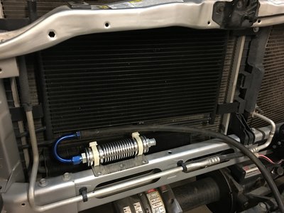

At Brave Motorsports going under the knife! Howe steering is getting put together with some custom touches.
Billet cooler with custom bracket getting mocked in place
Filtered reservoir and custom bracket and TC pump with billet pulley mounted

Just a few quick questions. What is the hitch on that new bumper rated at ? Does it seem as stout as the factory hitch ? Is that an additional PS cooler or for something seperate, like hydro assist ?
Traded to 2019 ZR2, Red.
Posts: 1675
Re: Boogie wagon take 2
Post by Colibri » Mon Dec 05, 2016 12:50 am
The cooler replaces the factory piece, my understanding is that the straight through heatsink style cooler is necessary because it's flow rate is higher than the stock design. It's a TC pump rated at 1500psi@4.5gpm hence the very large reservoir and hoses larger in I.D. than stock as well.
I'm not sure about the new bumpers hitch rating but I'll ask. Pattonfab built it but it's Thuren designed. It's definitely very strong but no idea how it compares to stock. It does pick up a lot of ground clearance, at least 18-20". That was my main concern when I chose it.

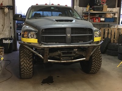

Post by Colibri » Wed Jan 25, 2017 3:17 pm

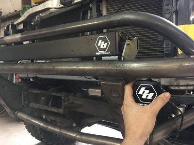

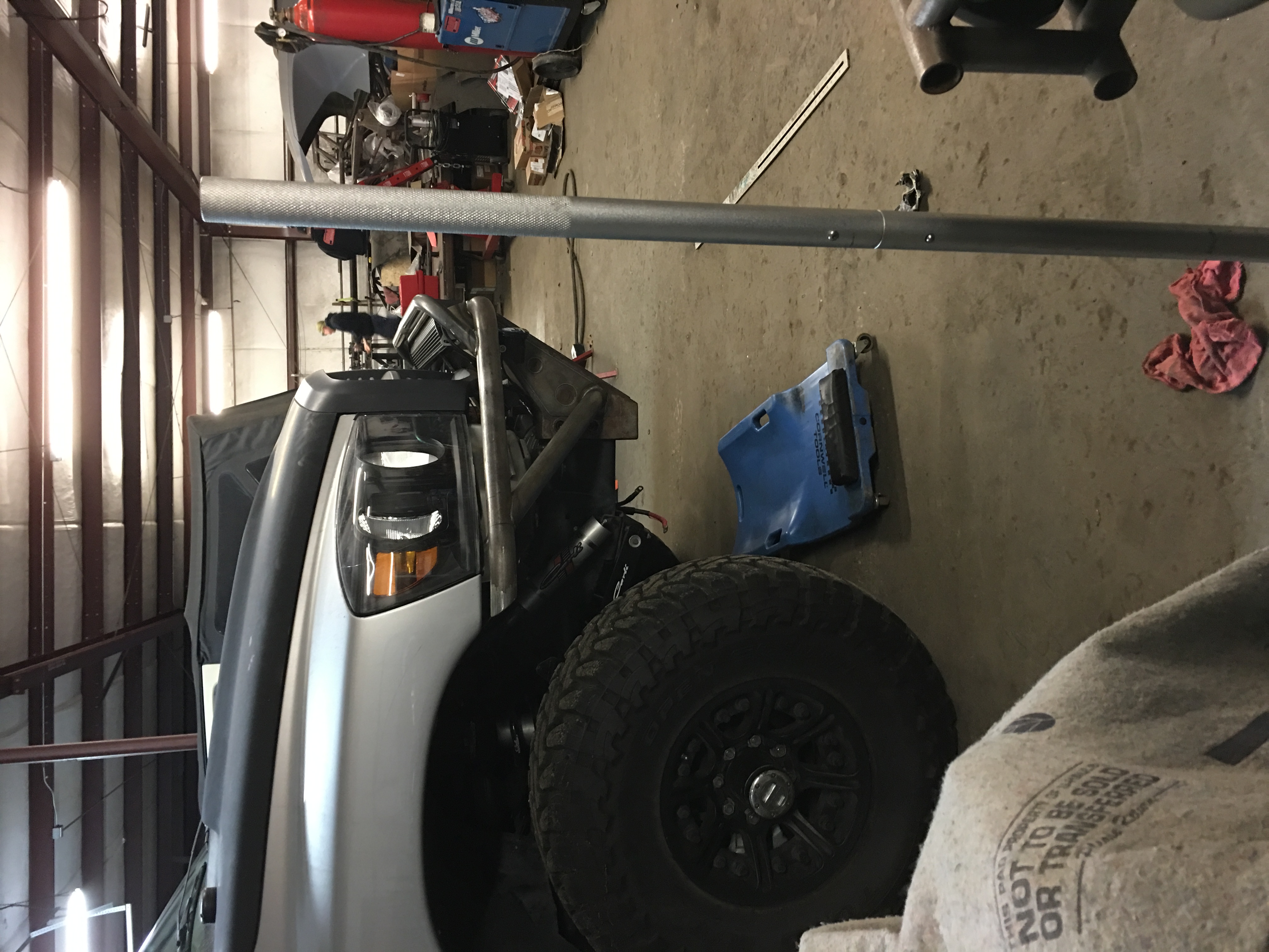

Getting pretty close now, here's some bumper progress

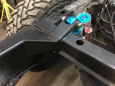

Post by Colibri » Wed Jan 25, 2017 3:20 pm

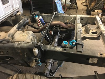

And the 3" 4 tube bypasses are on now with the Carli upper shock mounts with some extra gussets on the driver side mount/crossmember
