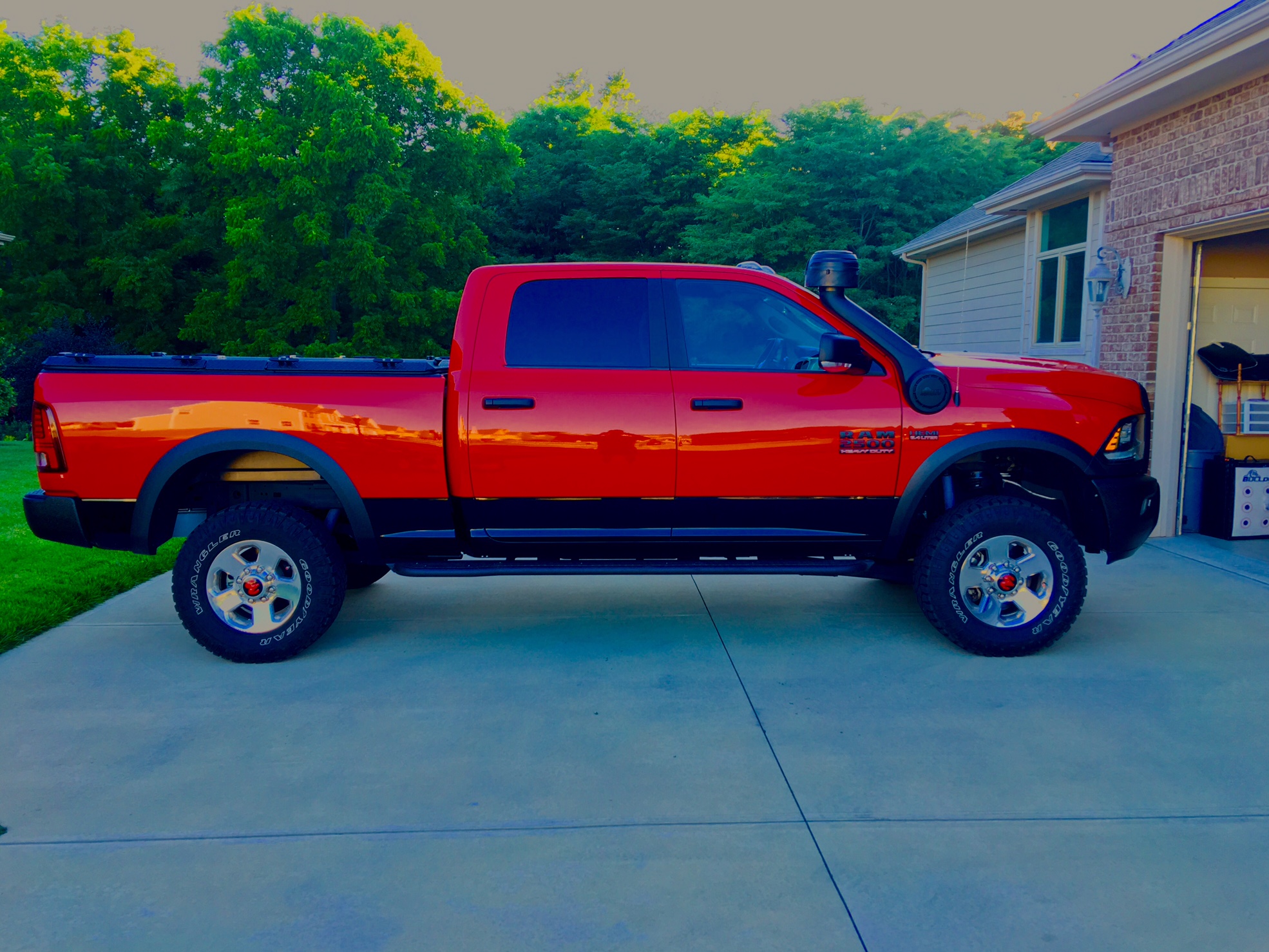

Post by adeluca73 » Fri Jul 01, 2016 11:47 pm
Here's the finished pics with all decals removed & wheel center caps replaced & a pic of the Factor-55 HitchLink 2.5 I picked up a few months ago w/ 6.5 Ton shackle, it fits the class V receiver w/o the filler sleeve.
Side 1
Side 2
Wheel cap close up
Front
Rear
Factor-55 hitch link 2.5--for class V receiver

Post by Stickman » Sat Jul 02, 2016 12:06 am
Get some black rims and bigger tires and that thing will look straight up badass man, good job.
