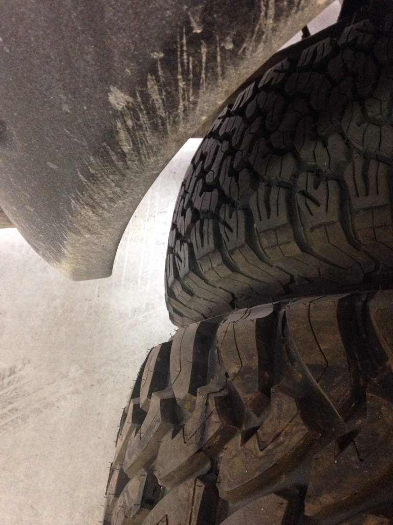

Ko2 is your closest bet to an undersized 37....
centre to centre with a toyo mt
