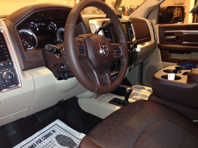

2014 PW Stock interior pics
Post by adeluca73 » Thu Aug 07, 2014 12:13 am
Here are some stock interior pics. I went with the frost beige/cappuccino interior.
Driver's side seats
Operator's counsel
8.4AN Entertainment unit
Back with seats folded up and flat floor down
Passenger front seat

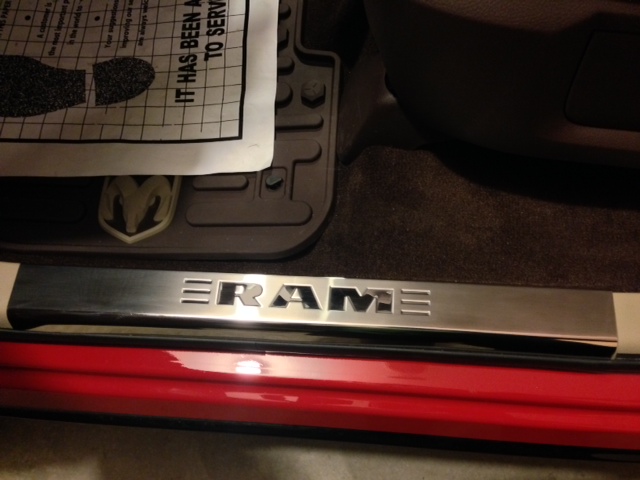

Mod #1: MOPAR Door Sills
Post by adeluca73 » Thu Aug 07, 2014 12:20 am
Mod: Mopar door sills x4.
Purpose: Ccosmetic & protects that step which becomes impossible to get the black boot scuffs off.
Vendor: Mopar Door Sills
$122 for set of 4
Installation: 15min. Use flathead screwdriver, pry up existing sill, place over metal guard, bend 6 retaining tabs, tap existing sill back into place to lock in.
Driver side door sill

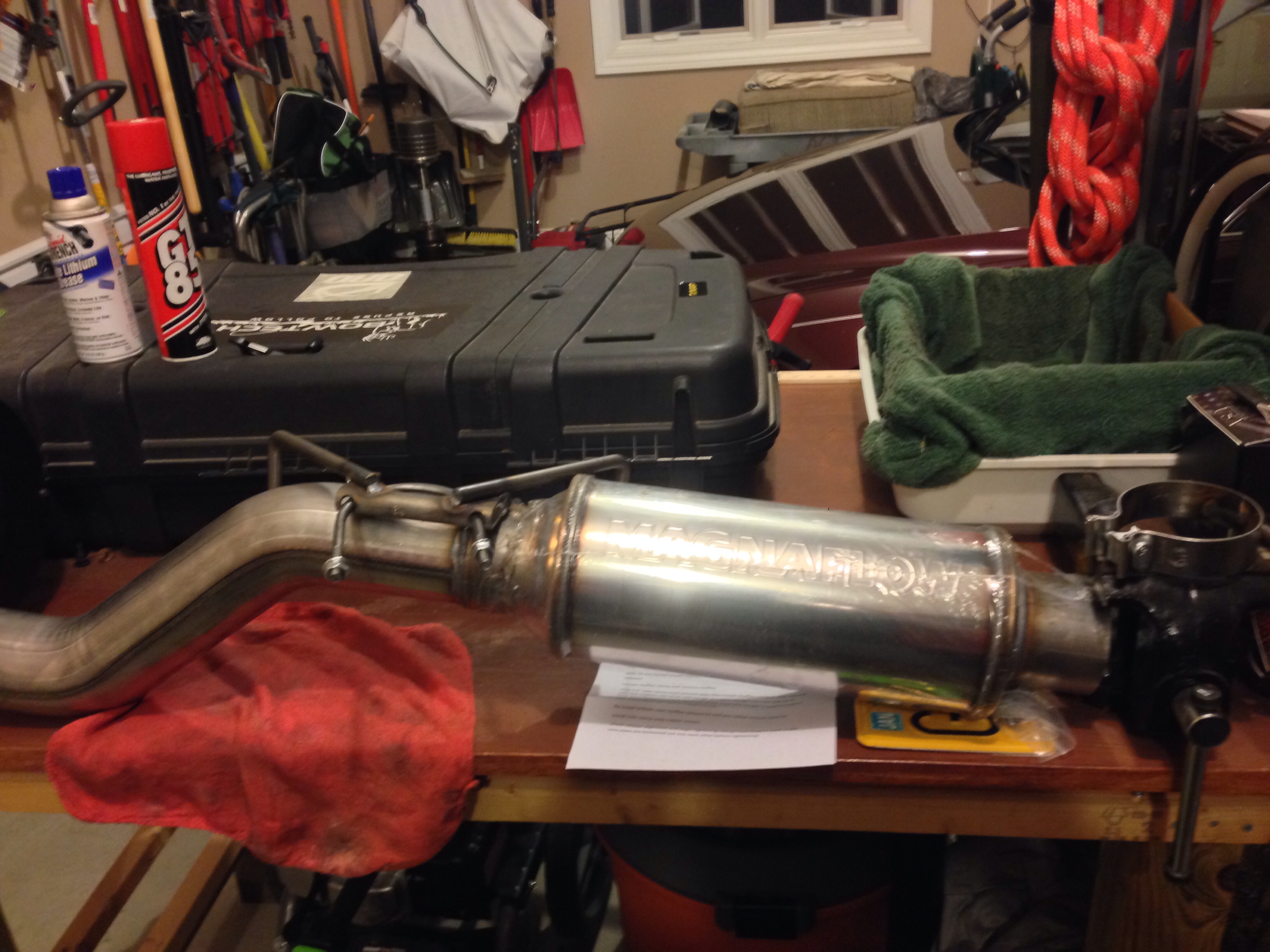

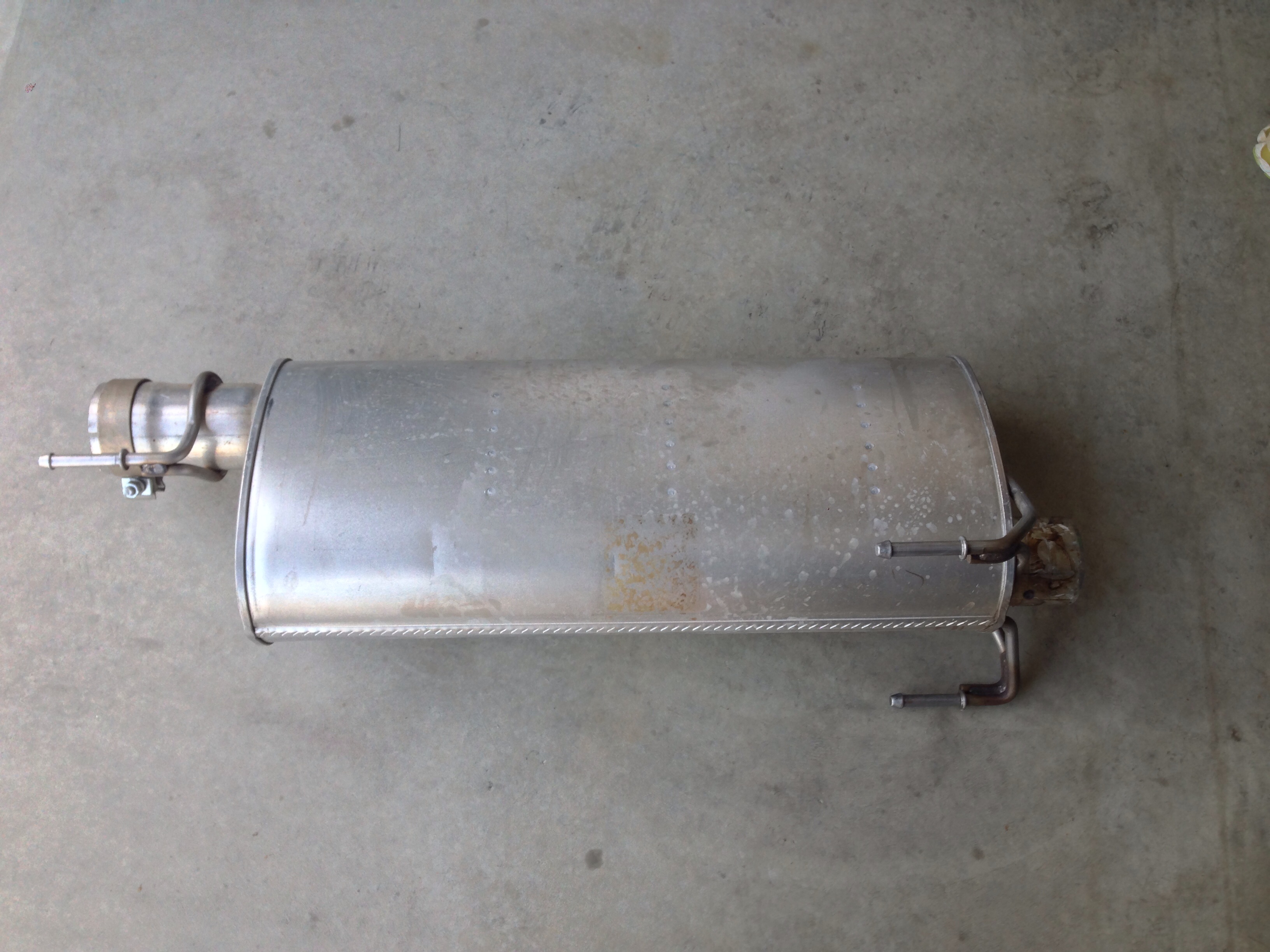

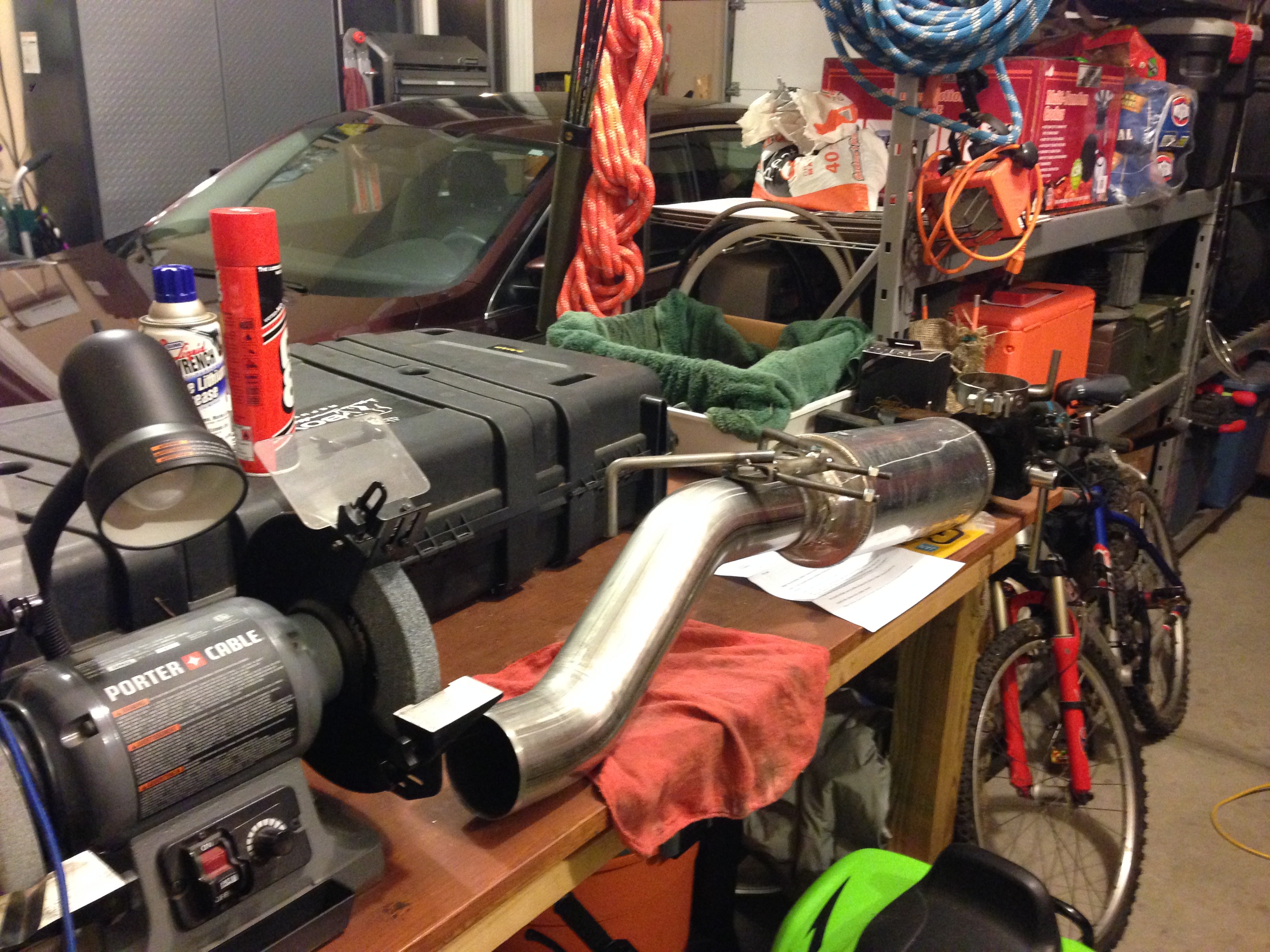

Mufflex MagnaFlow muffler replacement
Post by adeluca73 » Wed Aug 20, 2014 1:50 pm
Mod: Replaced factory GIANT muffler with the NEW mufflex bolt on MagnaFlow based kit, 3.5" in and 3.5" out.
Purpose: Increase low end grunt (sound quality), reduce the unnecessary back pressure caused by the factor muffler's buttefly valve that only opens beyond half throttle, which should provide a bit more low end power at lower throttle inputs (I drive like a granny, so I rarely punch it past half throttle).
Cost/Source: $295+S&H, Mufflex
Install: Easy-to-medium difficulty.
1) Hardest part was prying the factory muffler hangers off their rubber mounts. Drench it with WD-40/Fluid Film and use a LONG pry-bar. I had a 18", maybe 24" bar, and I couldn't get it loose lying on my creeper in the garage. I took it to the base hobby -shop, put it on a lift, and used their 5ft pry bar and it came right off.
2) Directions recommended pulling the entire tailpipe / resonantor off. Well that's like 4' of pipe, I just loosened it all the way, took some bungees and supported it's weight and installed the new muffler and then tightened everything back up.
3) Remove the old muffler's 2 clamps, retain the stock rear bank clamp that attaches the tailpipe to muffler, install new muffler using the mufflex provided front band clamp/hanger and the rear horsehore pipe clamp/hanger
4) Install the front band clamp on the muffler, slide front into the exhaust pipe hand tighten the clamp, insert the hanger into the rubber mount.
5) Install the rear horeshoe clamp on the rear of the welded SS pipe that Mufflex welds onto the MagnaFlow muffler, slide into the tailpipe, insert the horsehoe's rods into the rubber mounts, tigheten the horsehoe clamp around the Mufflex SS pipe, tighten the band clamp on the exhaust pipe.
6) Alternate tightenging front and rear band clamps till super tight.
:rockon:
3.5" MagnaFlow + Mufflex welded on SS pipe extension
STOCK muffler inside view of butterfly valve

Mufflex MagnaFlow review
Post by adeluca73 » Tue Aug 26, 2014 12:58 am
Pics of the new vs old muffler.
Sound is awesome at idle--deep & throaty. Moderate sound through acceleration from stop to speed. Light drone at 55-65 mph. It's bordeline annoying--have to increase radio from 11 to 13 for same level of listening. Drone is gone at 70mph. My fuel economy decreased by about 0.4mpg. Power band has chAnged, computer had to relearn shift points. Seems like it's drawing out the RPMs between shifts over stock. Still deciding if I'm going to keep it or put the stock muffler back on. The difference in weight is substantial. The mufflex is about ½ the weight of stock.
I took sound pressure readings from inside the cab at idle, 55, 65, 70mph. I'll post the db level & the FFT of the location of the frequency of the first mode later.
Stock muffler: 39" end-to-end
New mufflex mangaflow

adeluca73 wrote:I spoke with the Mufflex designer of the 2014 6.4L replacement and he offered two recommendations:
  • No matter what muffler option you choose, theirs or another, DO NOT REMOVE THE RESONATOR--it will be unbearable
  • The straight through option they offer is too loud at all speeds and RPMs
The power band, from my calibrated ass gauge, seems to have changed. The back-flow pressure built-up with the stock muffler seems to provide a bit more "launch and punch" from about 20-30 mph at 1/4 throttle accelerating to 1/2 or greater throttle.
After about 120+ more miles, the gas mileage seems to have recovered back to pre-mufflex.
Here's the avg SPL db reading results:
  • Idle, Fan @ 1, Windows up: 49.5db, 345Hz 1st mode.
  • Idle, Fan @ 1, Windows down: 54.2db, 129Hz 1st mode.
  • 55mph, Fan @ 1, Windows up: 65db, 388Hz 1st mode.
  • 65mph, Fan @ 1, Windows up: 68.2db, 388-410Hz 1st mode.
  • 70mph, Fan @ 1, Windows up: 69.8db, 380Hz 1st mode.
10 * log10 (2x pwr increase) = +3.01 dB
3 dB increase is, by definition, a doubling of input power over the baseline measurement.
Good rules of thumb:
+3 dB = twice the acoustic power, or sound intensity, a calculated value
+6 dB = twice the voltage intensity, or sound pressure level, a measured quantity
+10 dB = twice the amplification or perceived volume, which is the subjective loudness nearly sensed using a psychoacoustics survey
So the change from Idle w/ windows up to 70mph is about +16db. 16db/6db = +2.66x change in sound pressure level. 16db/3db = +5.33x increase in acoustic power, and 16db/10db = 1.5x louder.
Can't ask for a better answer than that... Would love to hear what you think about it in another 500 or 600 hundred miles... I'd be interested in taking it off your hands if you do decide to go back to stock...
