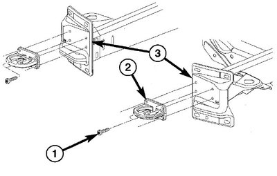

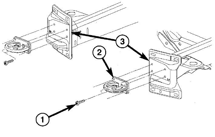

As far as an attachment point for a tow bar, I'm thinking you could replace the OEM tow hooks with something fabricated like this, but turned horizontally. And you'd still have a good attachment place for a clevis shackle...Chaszur wrote:This is turning out to be more of a challenge than I expected. I checked Aluminess, AEV and Smittybilt all of whom sell an off-road bumper for the PW. They all say the same thing. The bumper is not designed for flat tow applications and will not work. I'm no engineer but it seems that if the bumper has tabs for recovery use, those tabs should be strong enough to use for flat towing bu the manufacturers disagree. I've contacted a couple local truck customizers and they are willing to quote on custom bumpers.

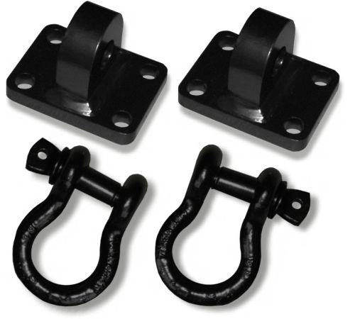

Here's one source. Rated at 3 tons each.
http://www.billet4x4.com/pro-shackle-mount.htm
Here's some on eBay that aren't rated and bolt in place of the tow hooks.
http://www.ebay.com/itm/2010-2016-DODGE ... 2192346212
Re: Anyone Flat Towing a 2016 PW?
Either of those will do the job. Not too much side to side strength required for flat towing.
